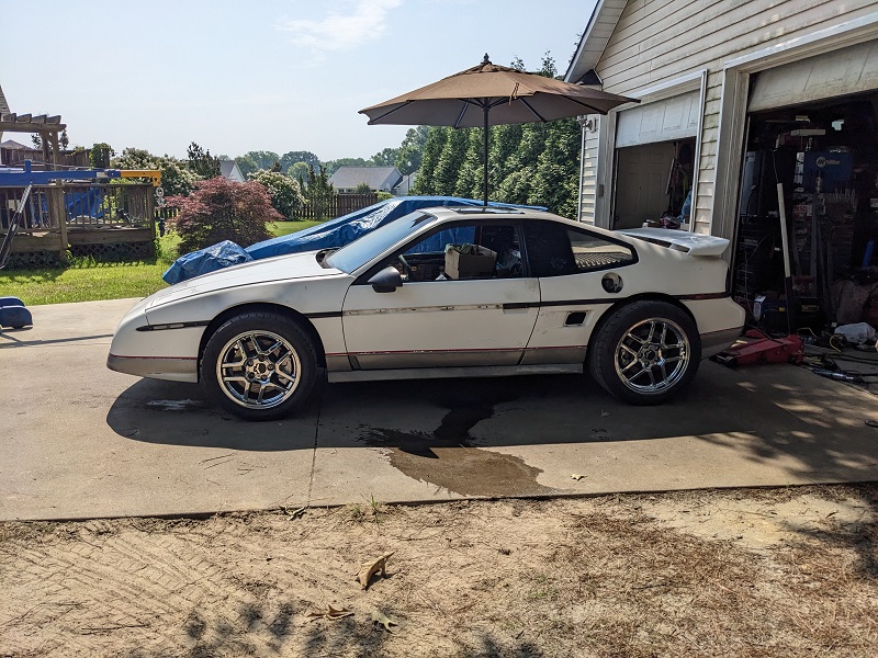

The Fiero sitting on it's new shocks.

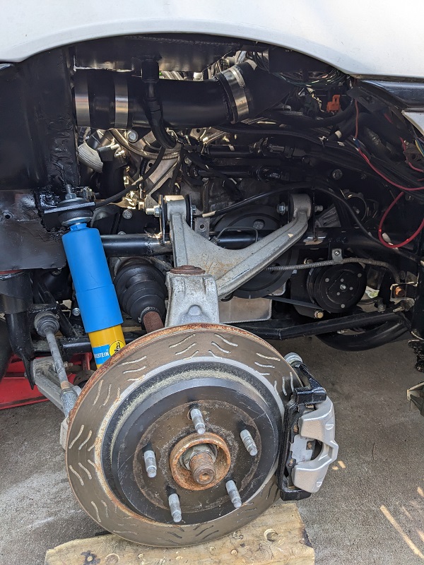

The rear shock setup. This side doesn't have the reinforcements for the upper control arm tabs yet.
The front shock setup. Mike realized that if he welded in the adapter plate, it would make getting things unbolted a pain. Because if he used zip nuts (maybe the wrong term, those ones like the nuts in the stock Fiero engine cradle), and one broke loose (also like in the stock Fiero engine cradle...) it would be a real ***** to address. So he's going to be adding some additional mounting points to the adapter plate.

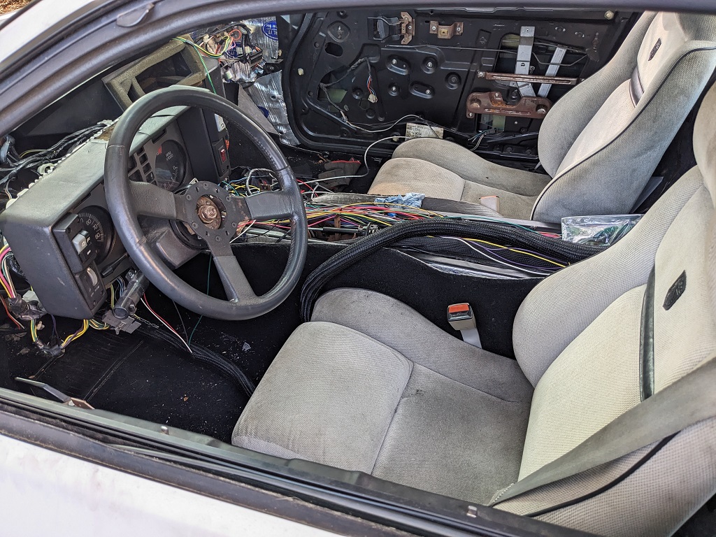

We also can't find the instrument cluster we saved out of my car, so I used the cluster from the donor car (which is missing the RPM needle), and hooked up the connections and bolted it in place today --- mainly so I would have mounted switches for headlights and trunk popper, and could see my fuel gauge. For the near future, speedo and temperature information is going to come from the laptop talking to the FAST and TCU. Mike has a car laptop stand that he thinks he can adapt and install as a temporary measure, and he has a car power inverter he can loan me.
So yes... this interior is almost exactly how I was expecting to show up at Carlisle (just wanted to get the horn working)... and likely this is how it will show up this way at the 40th. I *might* have time to add interior door panels and install the awesome 3D Printed skeleton I have.

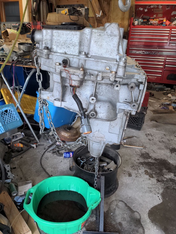

We started Saturday working on Mike's 3800 swap, and made a lot of progress. He had the engine back in the car and I helped him with some odds and ends, like getting the shift cables hooked up and testing the range while he checked what the transmission was doing, so we could adjust the cables accordingly. We finished up at 11, changing to work on my car after lunch.
We needed to pull my transmission so we could inspect it for any damage after the odd behavior we had last time. All research on the symptoms indicated the pressure regulator solenoid was going bad.
Taking the transmission out was also a bit of a design test. Mike was fairly certain we could take out his removable upper control strut. So we went about disassembling the suspension on the driver side, unbolting the transmission from the engine, unbolting the flexplate, all the usual stuff that you need to split the engine and transmission. Mike was happy that a lot of his design concepts worked, it made getting to all but two bolts really easy.
We then tried to slide the transmission out through the driver side wheel well. Unfortunately, the lobe of the transmission has a flare that interfered with the engine. The body of the car kept us from pivoting the transmission in a way to clear it. So we wound up having to drop the cradle. You can see that flare in this picture.

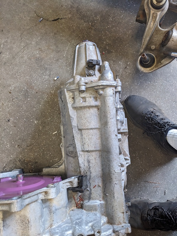

On another forum I had found a thread that was talking about the 4T80 in depth, and mentioned an oddity that I haven't yet confirmed anywhere else. It stated that the 93-99 used a different signal for the pressure regulator solenoid (I think voltage reference?) and in the 00+ they switched to PWM. The article said that a 00+ stock ECU would run a 93-99 4T80, but the PWM would burn up the pressure regulator solenoid eventually. Here’s where I doubt that tidbit on the signal change – the part number for the pressure regulator solenoid (24220158) shows on Summit Racing as cross referencing across all years of Caddy’s that had the 4T80E. I would think that GM would have needed to switch part numbers if there was a concern of them getting burned up by the ECU.
This meant we needed to confirm which transmission I had. Triple Edge Performance was pretty sure all of their 4T80 cores were from year 2000+. Of course he had built the transmission for me 4ish years ago, so he was going by memory. We put on the Kent-Moore transmission arm, loaded it onto Mike's transmission stand, and let it drain, ready to open it up and start an inspection. Here it is, draining.
Identifying if a 4T80 is an early model or late model is pretty easy. The early ones had a manifold pressure switch in them. Late models they upgraded the range selector switch with more electronics to also do the work of the manifold pressure switch. We took off the pan, and there was the manifold prssure switch.
The good news is, all the clutches looked good (just some very light glazing), nothing in the pan, the pumps are fine. The fluid was a little dark – likely from the overheating of the pressure regulator solenoid. So we replaced all the solenoids (pressure and shift) and filters (might as well).
After that was done, we put everything back together on the cradle, getting it ready to go back into the car.

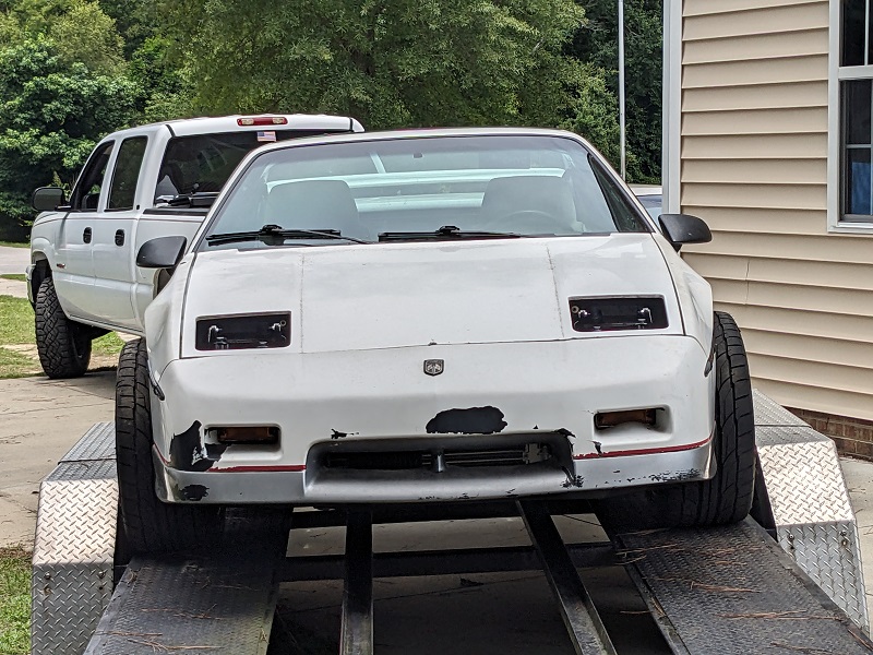

Instead, it'll be arriving like this.
The Z06 wheels did widen it up just a bit more than Mike hoped. It barely fits on the trailer, and we had to come up with an alternate solution to get the other ramp mounted to the trailer. Good times.[This message has been edited by Trinten (edited 07-09-2023).]
