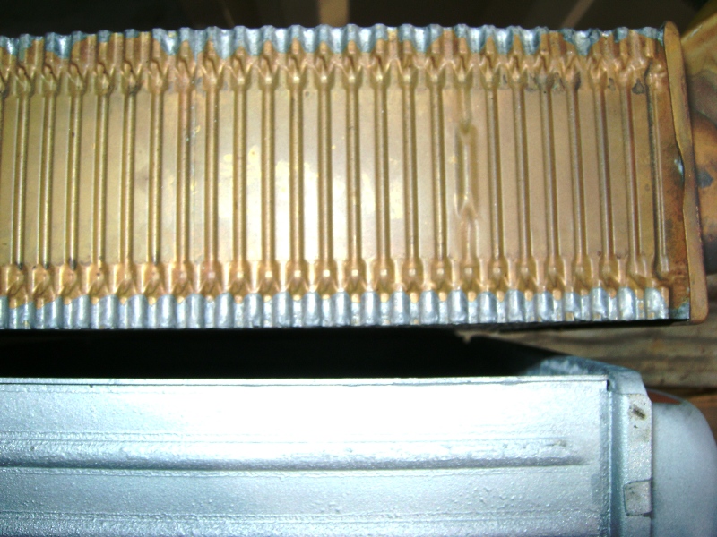

Went out this morning and finished installing the heater core. The one I got from RockAuto was a Spectra brand. Autozone also sells this brand for about two times the money. It is about 7/16" shorter then the one I removed. The hardest part was keeping it all the way back where the metal retaining strap went around the core's end without slipping off.

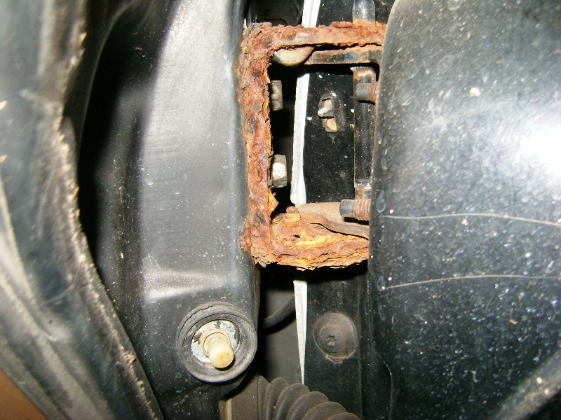

While finishing up I noticed this:
 Always things to repair/replace when one owns a Fiero!!! -joe[This message has been edited by josef644 (edited 02-18-2011).]

Wow Joe! That door hinge looks pretty bad. If you can't find one locally, let me know. I have a few laying around in the shed. Yours for the shipping.
Pat
