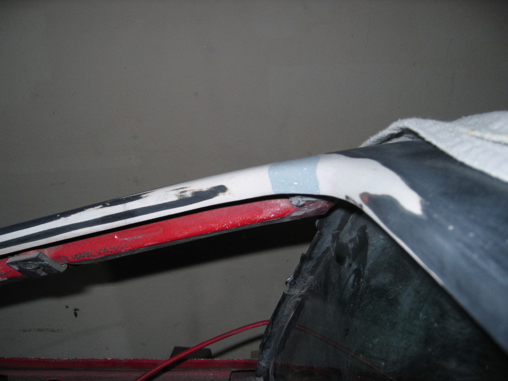

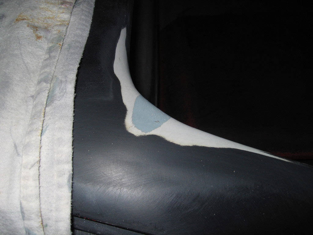

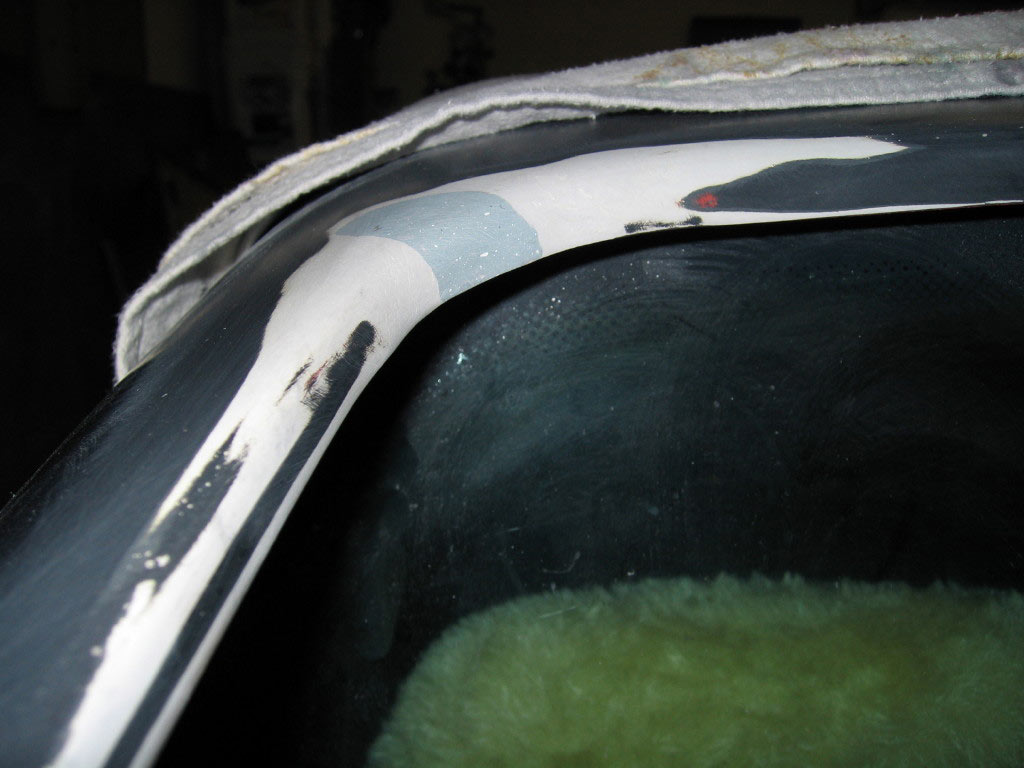

I decided to get brave and try filling in the cracked corner of my rear roof section. While I was using a half round rasp to prep the cracked area it began to look more like a factory flaw in the roof section that was filled in with something. It was crumbling away as I ground it out. I mixed up some SMC Panel Adhesive and added some chopped up fiber. After packing it into the damaged area I let it sit for about an hour. It was ready to sand down by then and as usual it took a bit longer than I thought it would but I think it came out ok. Well, hopefully ok for my first repair on this stuff...

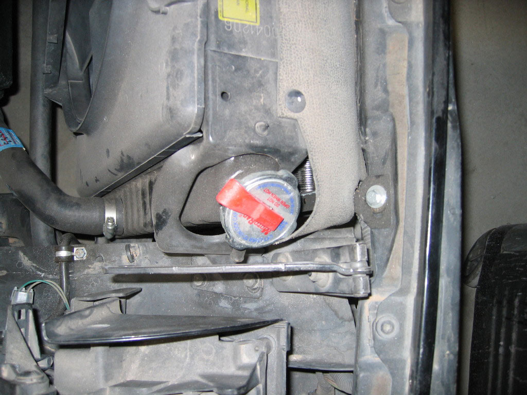

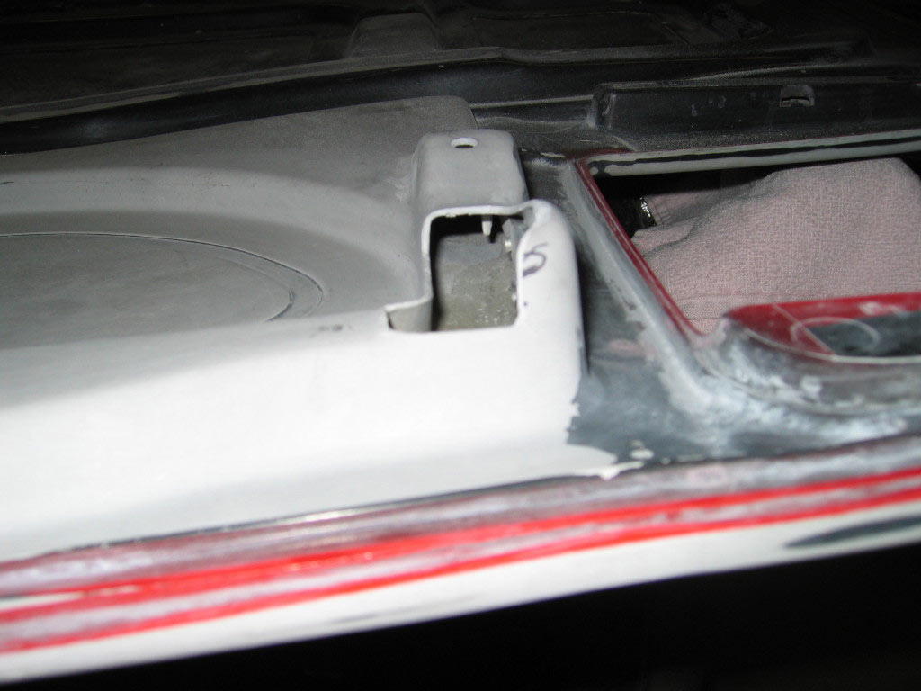

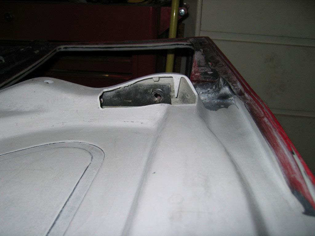

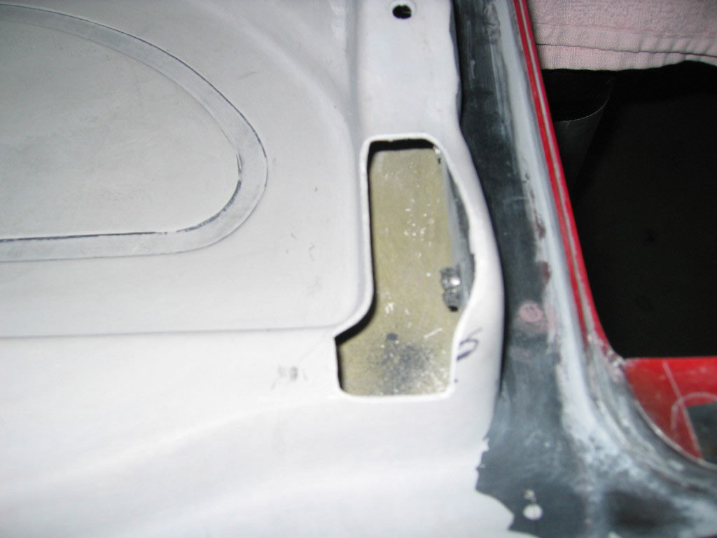

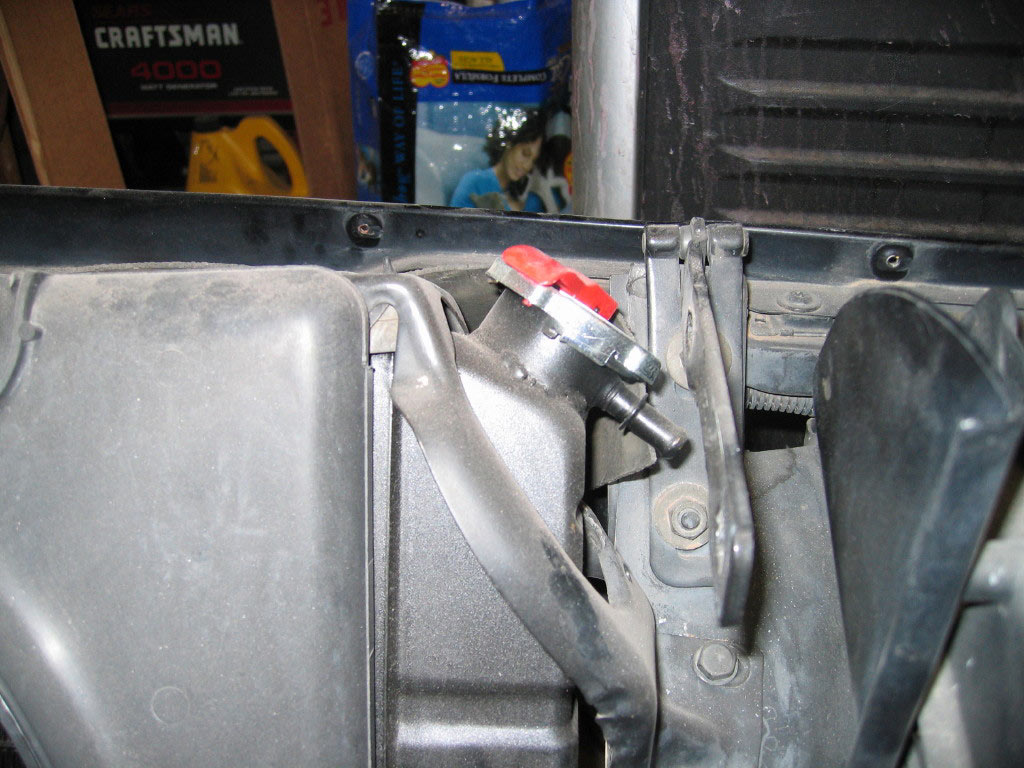

The next item on the list was to figure out how to get the hood to clear the Archie Radiator. The hood hinge support was contacting the radiator cap when trying to close it.
Using Oreif's suggestion, I notched the hood and it seems like it will be fine.
