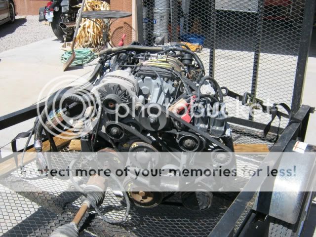

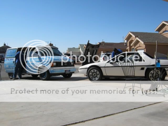

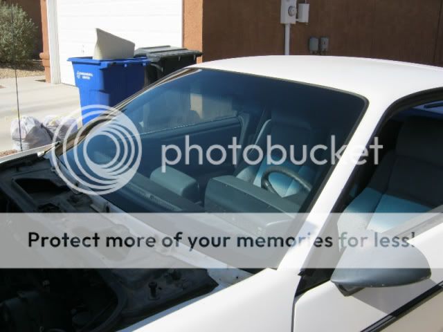

Got a new windshield installed this morning!
And picked up a little sumthin sumthin for the next project!
More later!

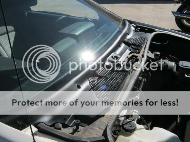

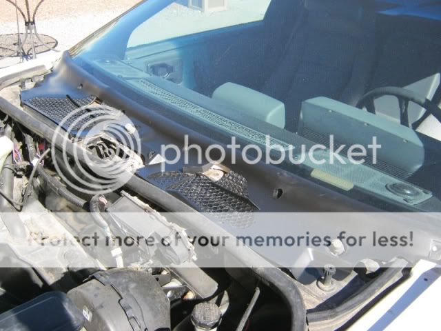

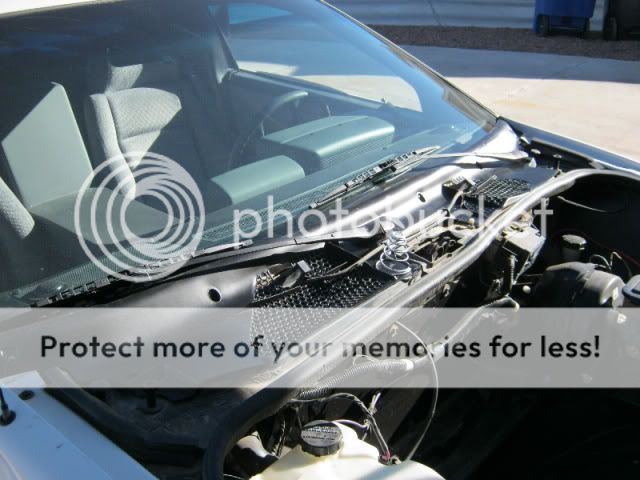

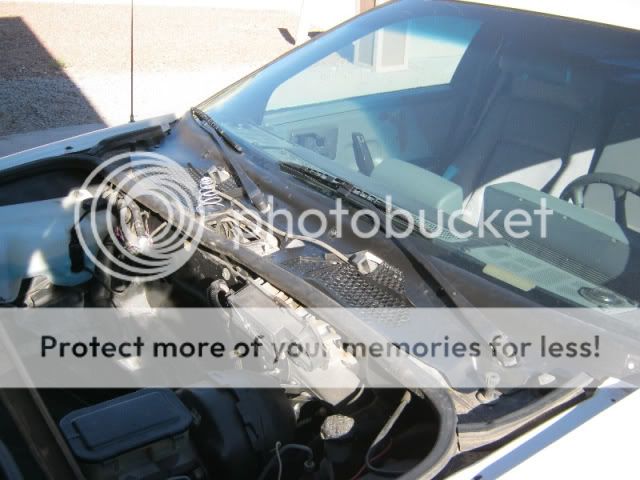

Did a little tinkering on the V8 Coupe this afternoon. When I got the car, there were no windshield wipers and the cowl/windshield piece was in bad shape. I went to the pick and pull and got a set of arms and a cowl piece. Then stopped by AZ and picked up some new wiper blades. After a good cleaning and some fresh paint, the cowl and the wiper arms were ready to install.

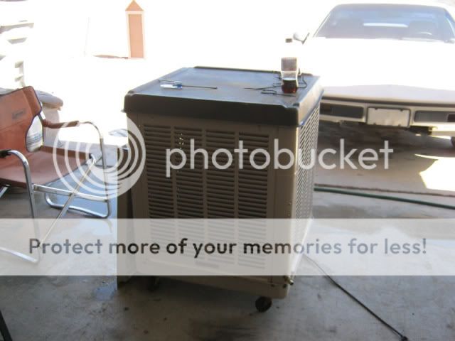

One more thing - and I know this will piss off the Northern Fiero Folks - but I had to give in and get the garage swamp cooler going to day. It was pushing 90 here today and the thermometer in the garage was @ 95*.
Let the cooling begin!

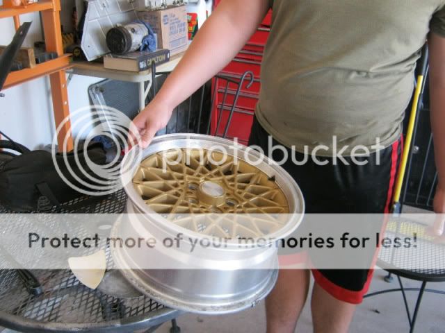

Chirs started a rehab on some 88 gold wheels - he wants to put them on the Formula - he has a lot of work to do!
Fixed up the Cowl and wipers:

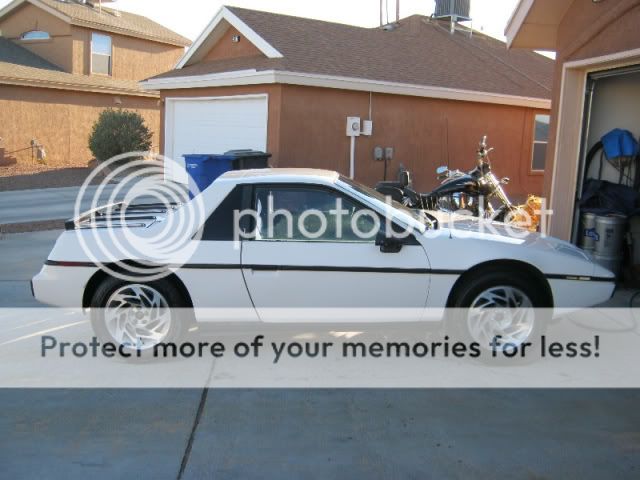

And all cleaned up:

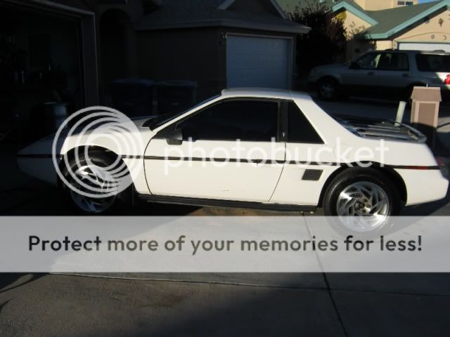

Not much work on the V8 Coupe this weekend but I did manage to get the exhaust tips welded on and fixed a little issue I had with a trans mount.I did work on Fiero's all day yesterday though. Did a gen 2 headlight swap on the Short Bus, helped Frizlefrak repair an oil leak on his GT and did some work on a 3800SC that I am prepping for a swap. Plus I spent 4 hours working on my swamp cooler for the house. I'm glad the weekend is nearly over - going back to work will be a nice break from all the Fiero work I've been doing lately.
I only have a few things left to get the car ready for inspection. Got to go to the yard tomorrow and pull a set of seatbelt latches - I really only need the fastners so it should only take a few minutes. Then I have to pull the seats out of the V8 Copue so I can install them. I should be legal by Tuesday! I can;t wait.

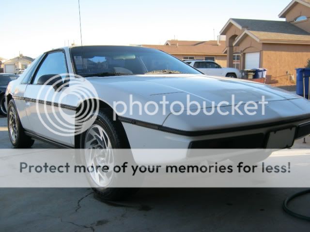

Insured, inspected and registered today! Hooray! Cruised it around town about 40 miles - no issues, ran @ 180* - plenty of power! I'll be needing tires soon!
