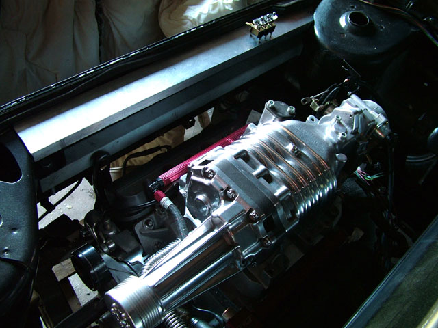

OMFG! I may have just made a happy mess in my pants. That engine install is extremely sexy! She is looking just great. I have always watched this build, and can't wait to see the end result.

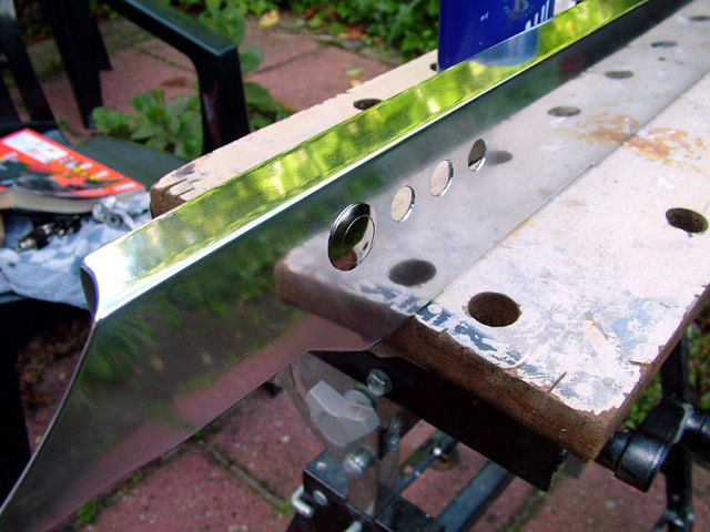

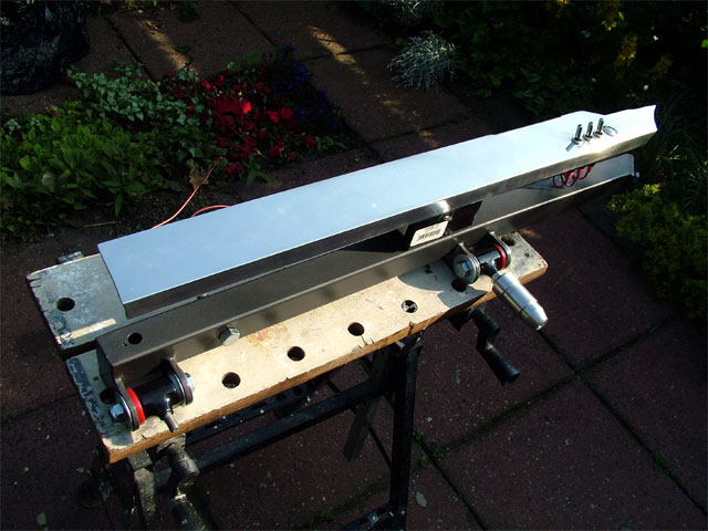

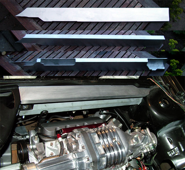

..for the trunkside of the enginebay I had a rough idea for a fiberglass or carbonfiber cover but I found an aluminium profile that could work too but differently, gave it a try
After a lot of cutting/fitting/cutting/fitting/cutting/fitting/ etc its taking shape

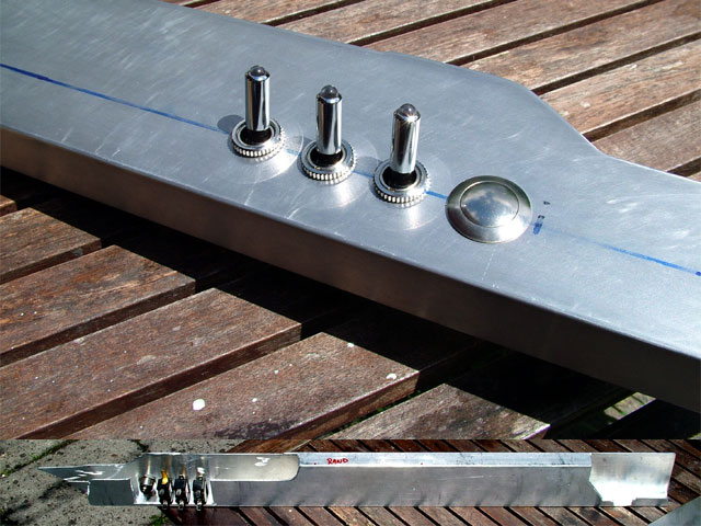

Then I want to mount a few switches that I dont want in the trunk
switches testfitting
The rewarding stuff is to make it shine Wetsanded with 400 and 1000 ...polished a little with a polishingwheel on a drill and then some belgom handpolish...this is the first pass

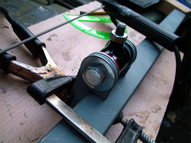

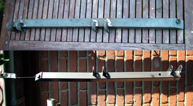

Started to setup and weld the dogbone brackets..cleanup, zincspray and then hi-temp paint

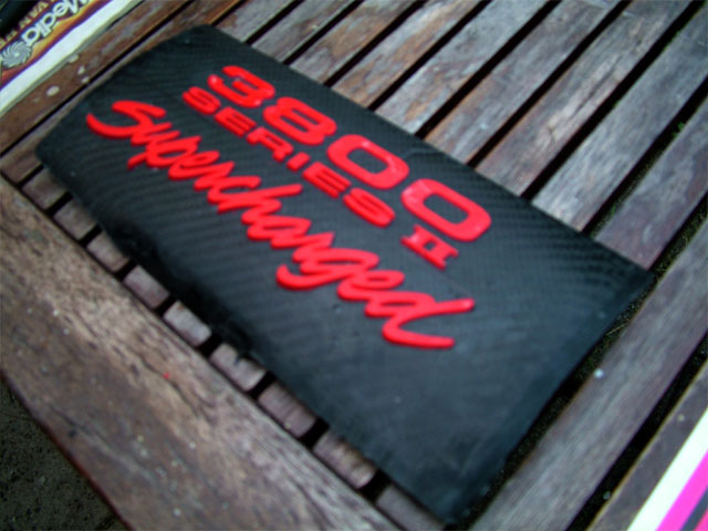

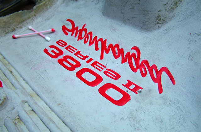

When I got the L67 I was able to get a pretty good mold of the engine cover logo and made a copy in clear and CF....
they have been gathering dust...
however I tried several setups ( paint and cutouts ), I never found a way to justify to cover the blower
anyway, a new version would now need:
- smooth main surface ( instead of small texture)
- red casted letters ( better than paint)

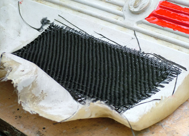

Start, hard to fill red tinted resin without spilling and cleanup
clear resin and CF
rough from the mold
