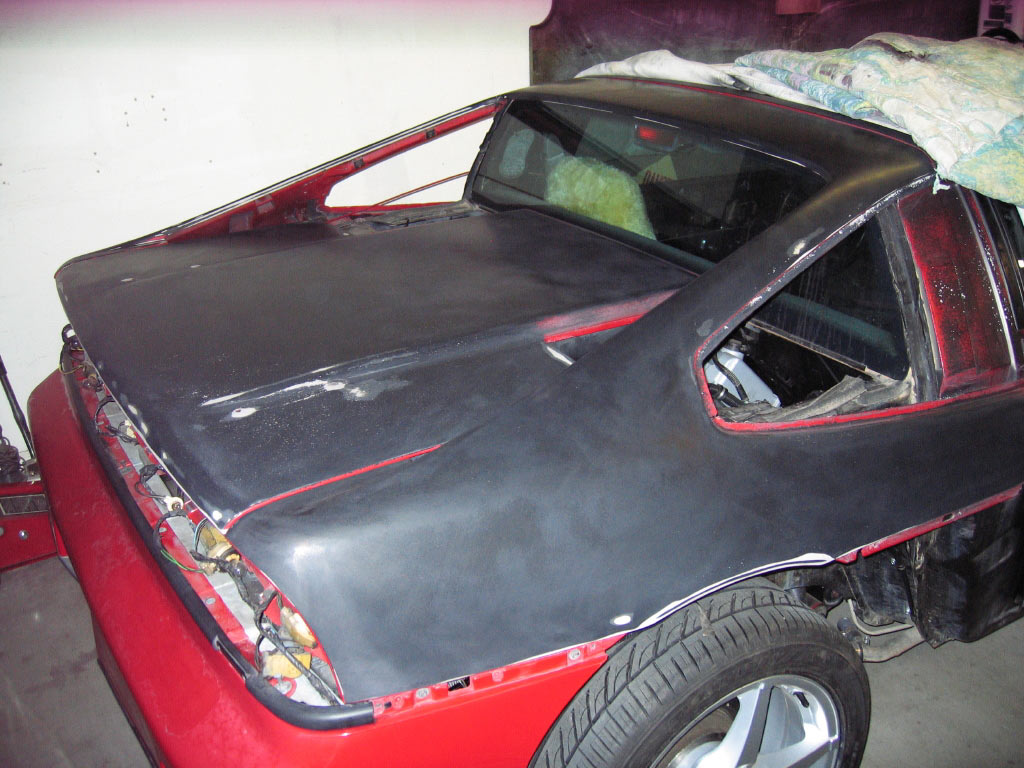

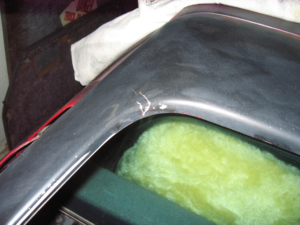

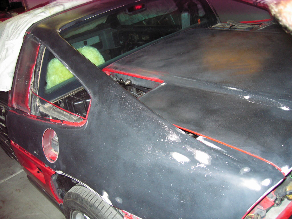

First two pics are of the general area worked on. The speckled stuff is where the media blast dug deeper in than the black primer. I am hoping a primer or filler will take care of those. The third pic is of a couple of cracks in the corner of the upper rear body. I was given some Evercoat SMC Panel Adhesive 3 #994 to fix it and other cracks on the top body pieces with. Hopefully that will take care of those.

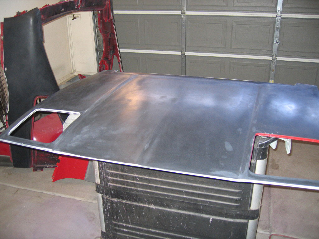

Just curious if it is ok to sand closer to the base material. Some of the black primer near the rear of the hood is sun damaged. The areas that I have sanded through are nice and smooth though.
