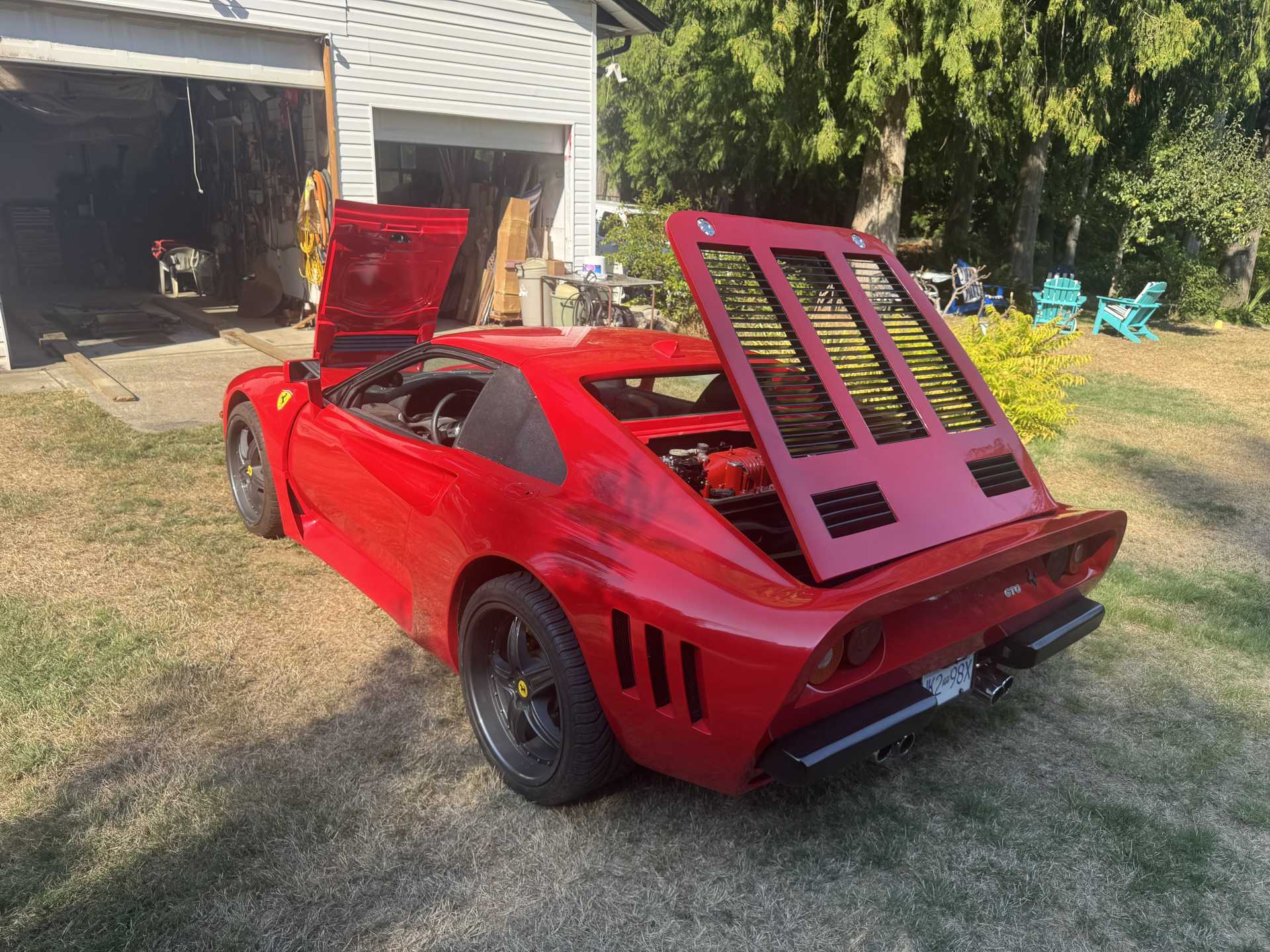

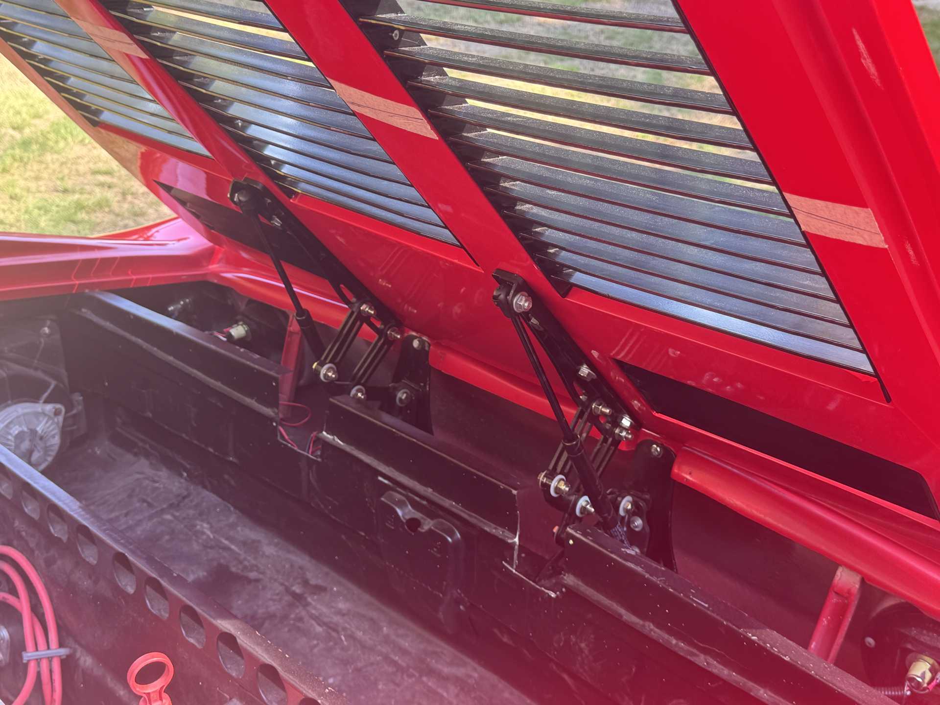

  I ended up installing pneumatic arm supports for the rear deck , having  the drivetrain out certainly made alignment of the pins easier!! I installed the grills to ensure the supports could handle the weight.

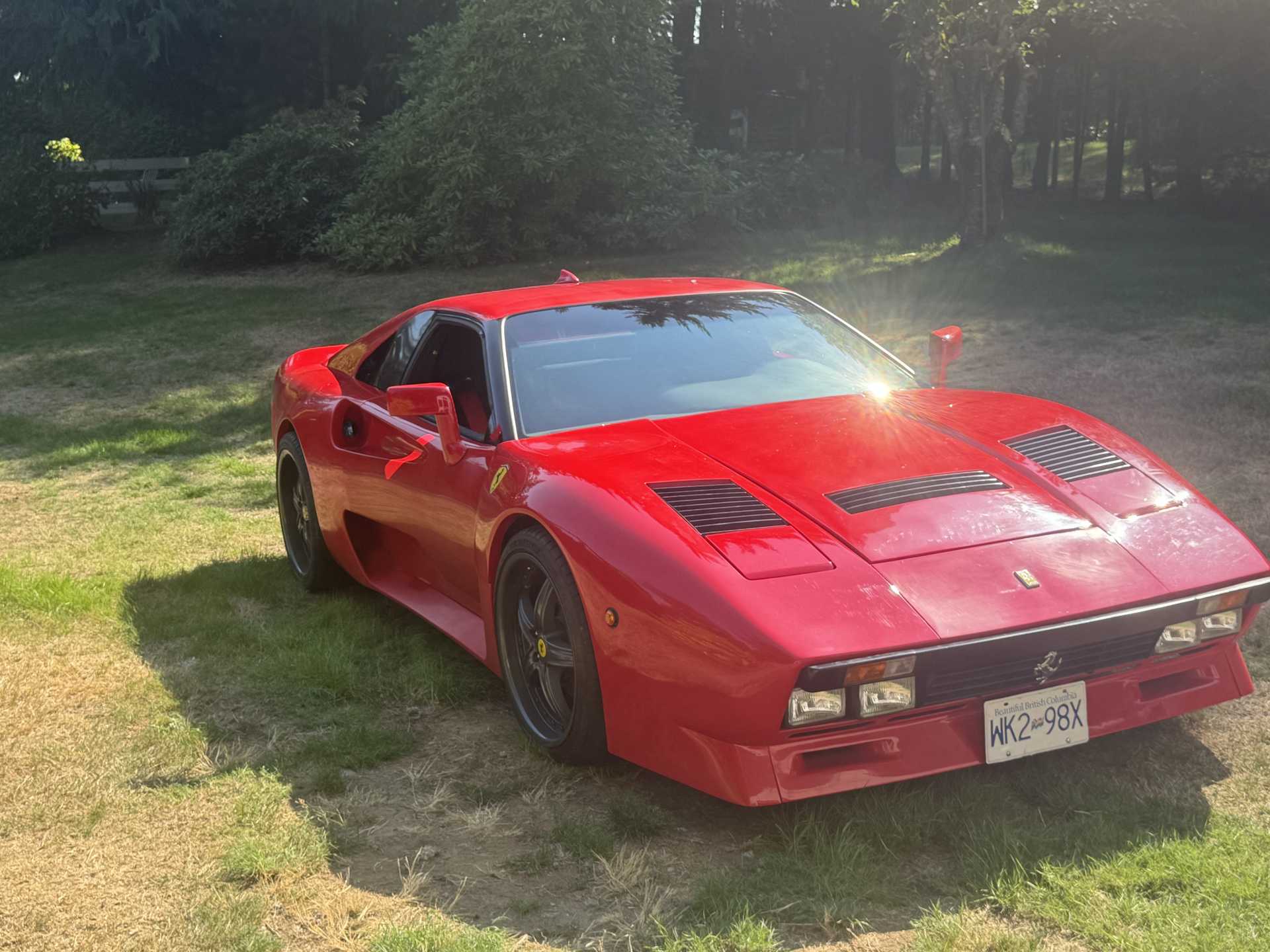

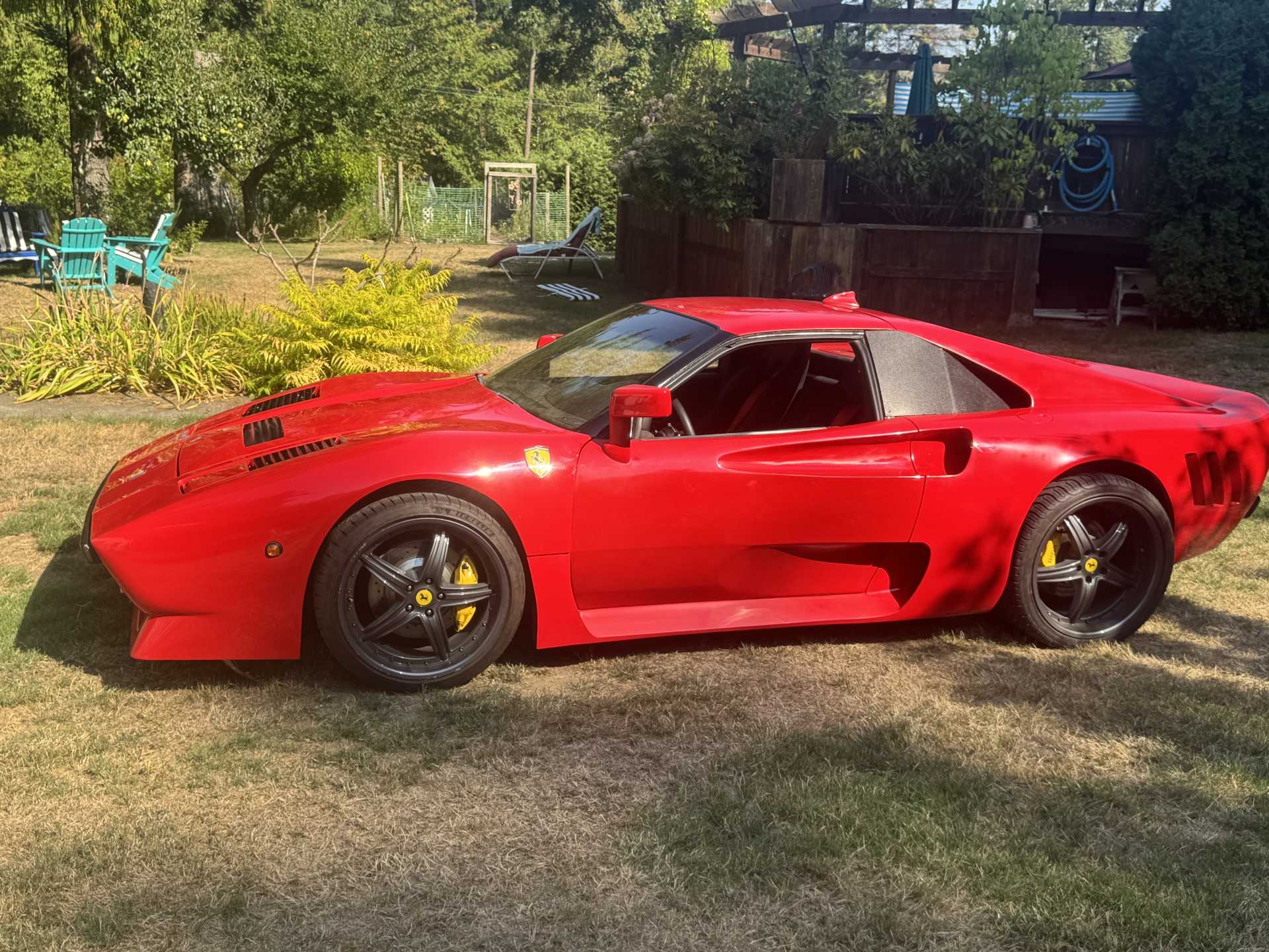

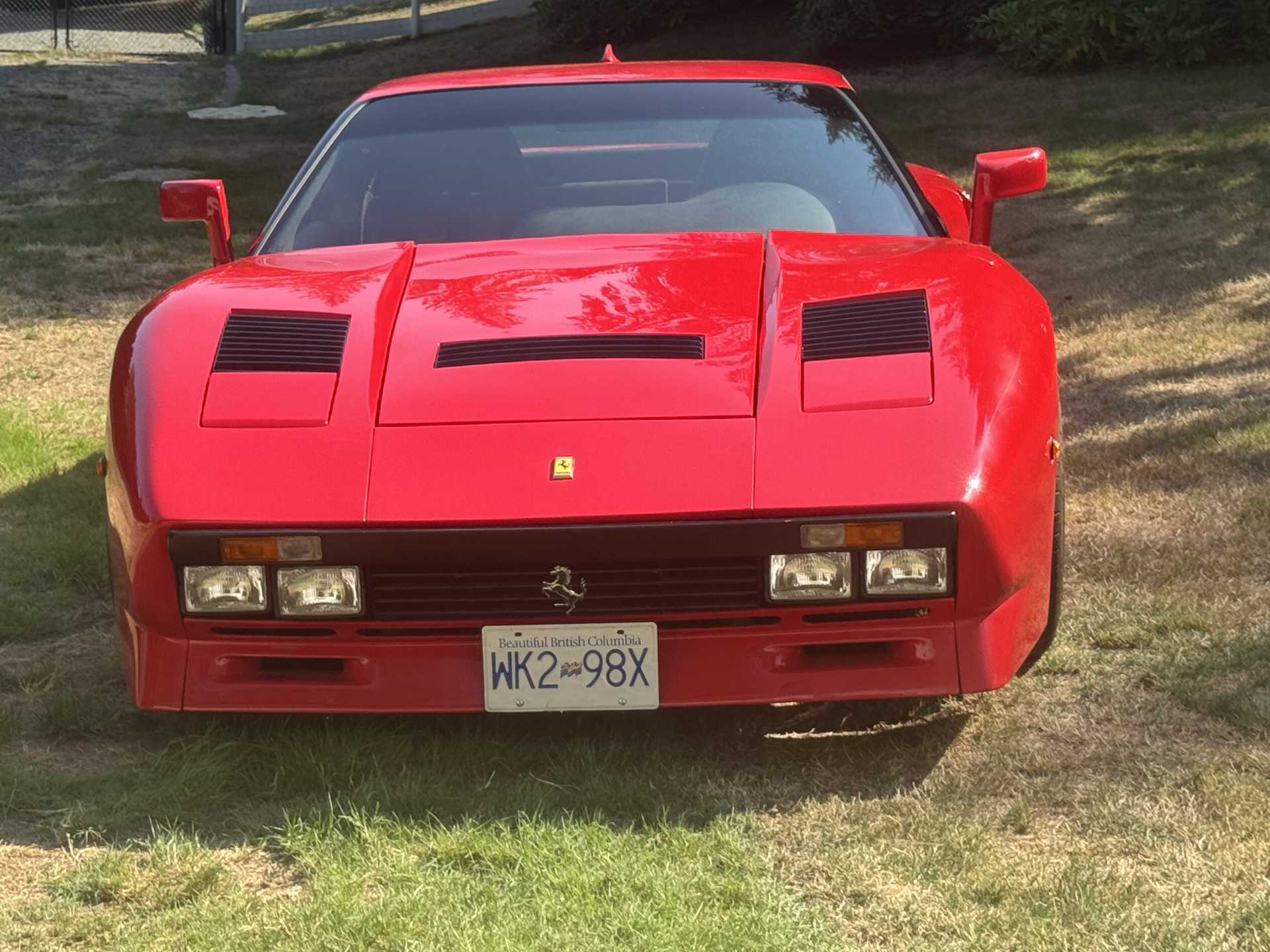

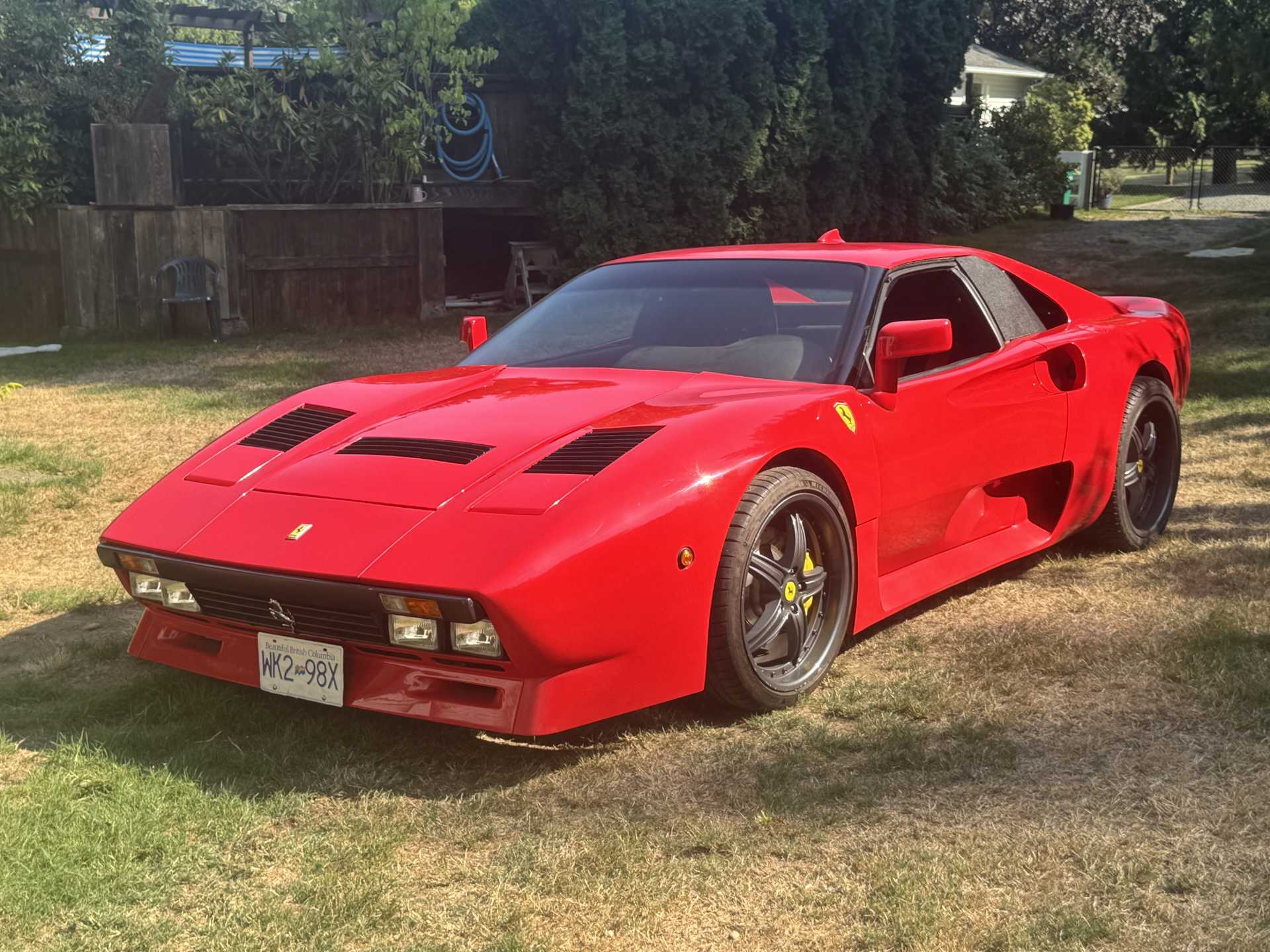

            Well after 10 years and way more money than I expected to spend the car is finally done . I still need to complete the sailplane windows but I’ll do that next spring , I just want to drive and enjoy it for the next couple months while the weather is still decent. Thanks everyone for following the build though the years😂
