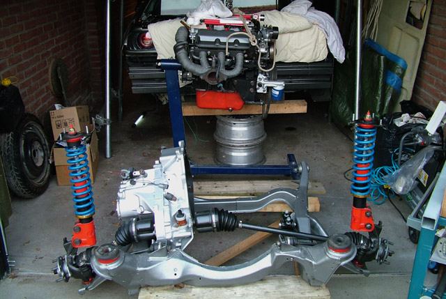

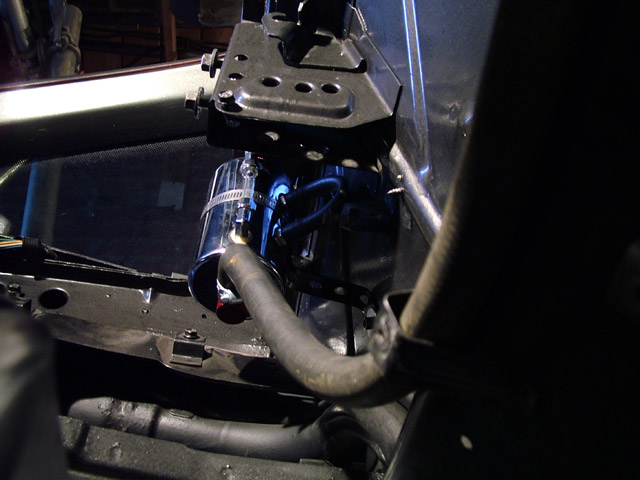

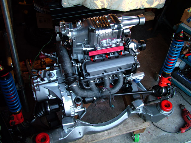

I dropped the cradle to add the engine

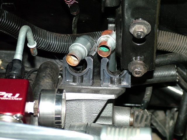

 still needs a clutch etc but untill I have all these parts I can put it in and already fabricate the dogbones, coolant lines and wiring routing and lengths...

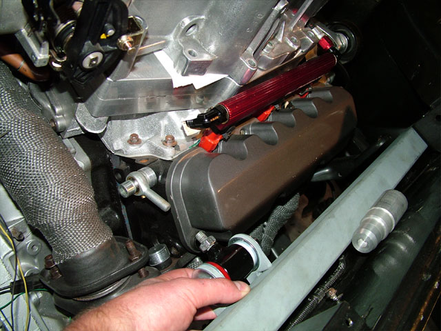

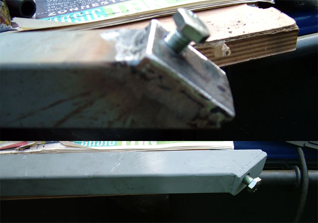

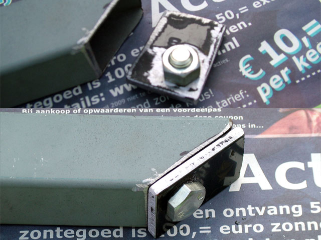

Working on some enginebay parts... Got it figured out how to mount the dogbones/strutbar, I will bolt it directly to the driver side strut tower, setup done by welding a nut to the back of the 'endcap' and then welding the cap to the bar

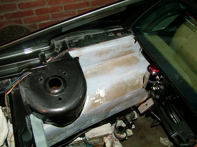

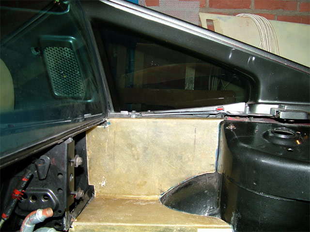

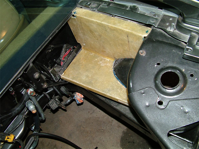

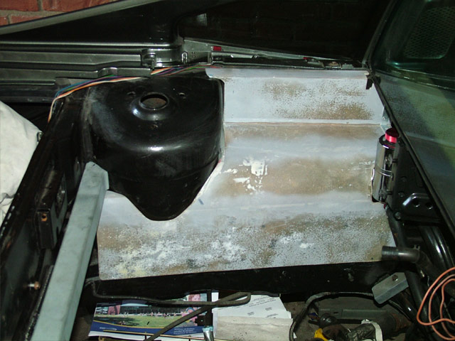

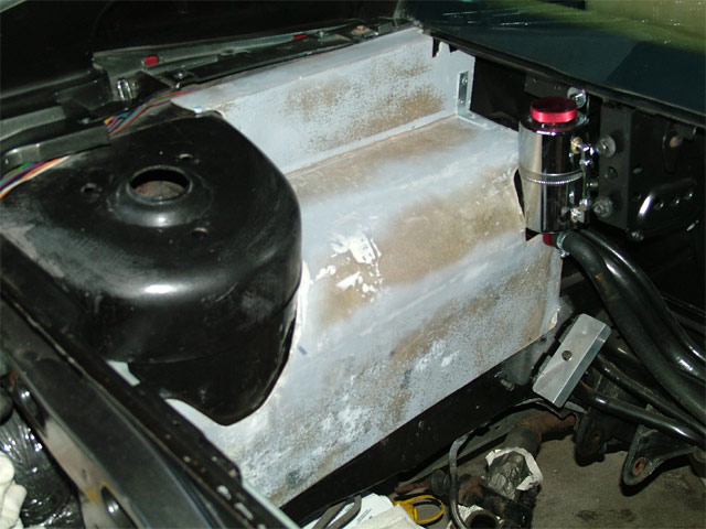

Working on the side panels for the enginebay. I already made the basic shapes last summer but now is the time to make them fit, cut and mod
Passenger side base

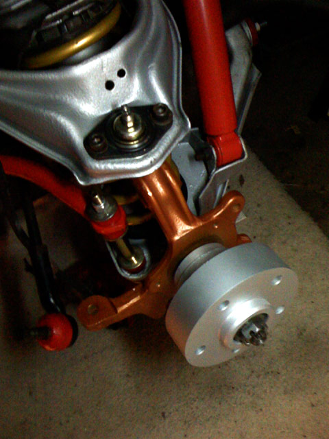

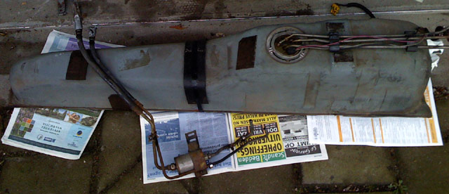

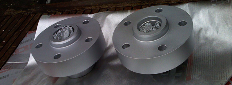

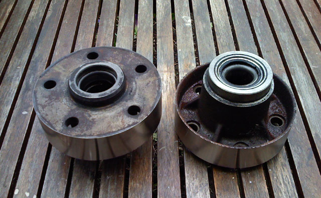

Last friday I had the front hubs done, removing the studs was a 5 minute job with help of an hydraulic press. Then I dropped them off to have them turned down , they got it done the same afternoon. That was a 45min 65 euro job according to the bill, which I think is reasonable
cleaned, prepped, a basecoat of zinc primer and painted with hi-temp paint
testfit

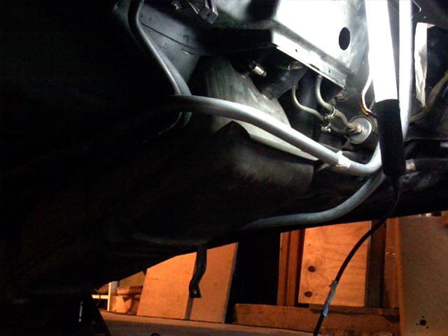

Time to drop the fueltank for paint and a Walbro fuelpump
 I will replace most of the old tubing, especially the metal lines after the filter that have rusted inside and caused injector problems in the past |

I found out my main parts supplier has an inhouse machine shop so I gave them a try on the hubs

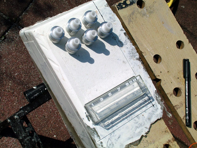

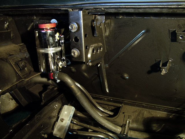

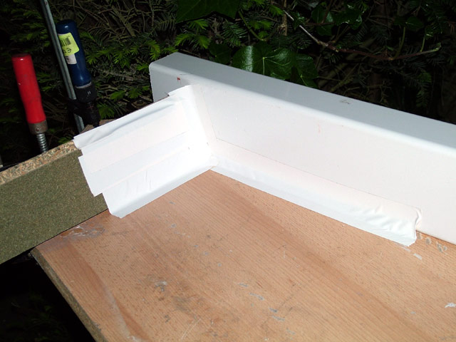

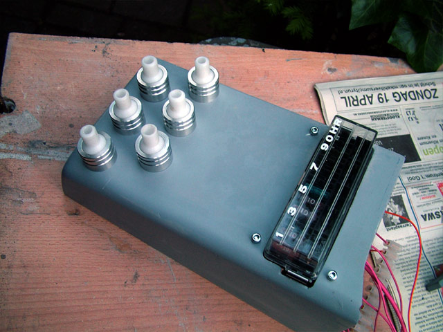

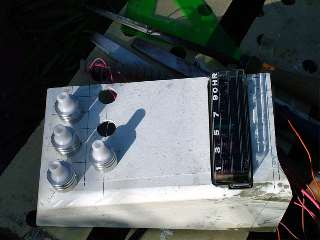

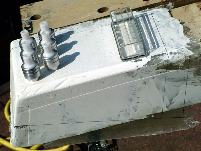

Made a side pod for the engine fusebox and the 'sparkplugwirerouter'.. Decided to keep it easy, doing it 'yankee style'
Rough product, enough fiberglass to sand smooth. Setting up the layout for the cuts:
Cuts and holes done:
And after some sanding and primer (still needs a little detailing work)

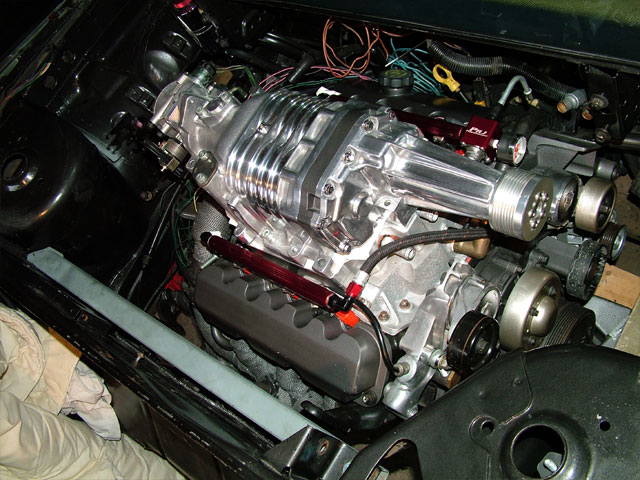

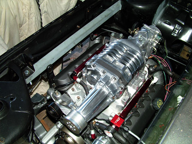

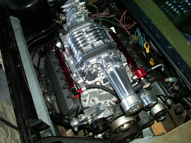

I also got the engine in, this was the only thing that didnt fit but easy to remove..may have to make something custom again I guess :
The engine roughly in place, cradle not bolted down yet :

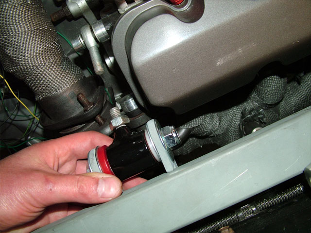

Check if the left dogbone mount will fit...looks ok
