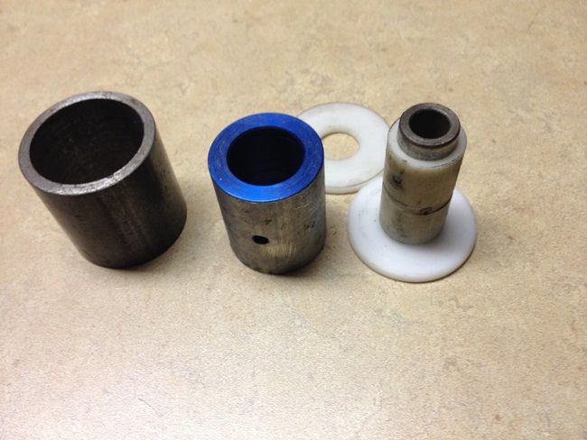

DEC 12, 07:32 PM
These are the bushings that will be on the frame side .I got our now retired machinist to turn them down and make the pipe that will be welded to the arm an exact fit .Drilling a hole for the grease fitting will make sure the AL bushing will move with the arm .I hope these bushings will last as long as I do , just have to keep them full of grease .They are very precise and very smooth .[This message has been edited by wftb (edited 12-16-2014).]
