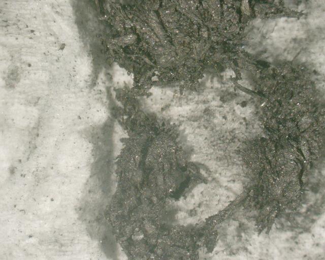

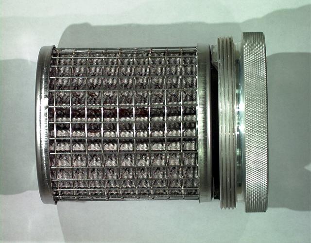

Magnified pictures of the moly-disulfide junk that ended up in my filter:

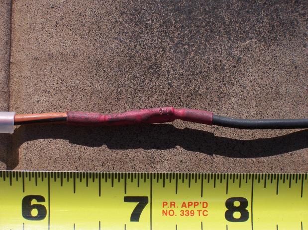

This is the location on the fuel pump power circuit that shorted and left me on the side of the road:
Bloozberry DEC 18, 10:20 PM
What kind of oil filter is that Will? It looks interesting.
Will DEC 19, 08:24 AM
http://www.gopurepower.com/
Spin-on filter for Northstar application. It's about $200.
