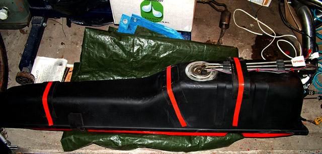

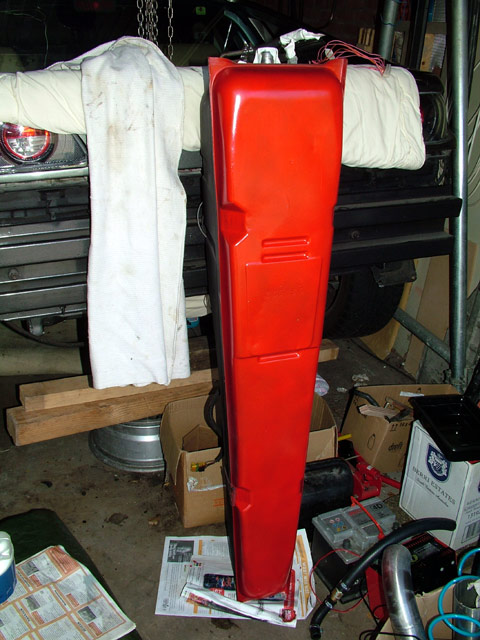

Hmm to bad these are down on the list Sooo many custom jobs everywhere, first goal is to get it back on the road and that alone needs a lot of work already...because I want to do it the right way.. I have a two-tone fueltank though  Spent some time and brakecleaner on the underside to clean it up..the rest was fine..then zinc primer, paint under and underbody coating on the top of the tank
 needs more black

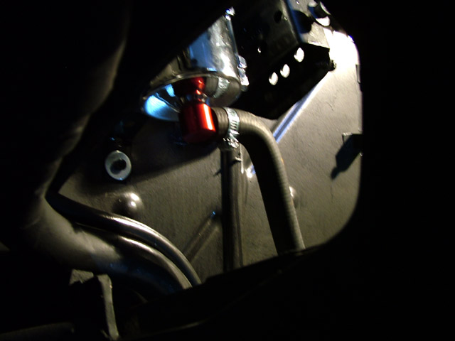

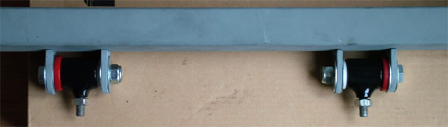

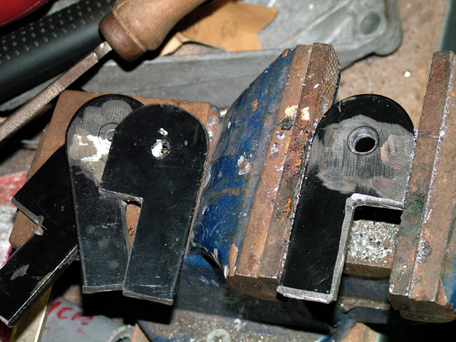

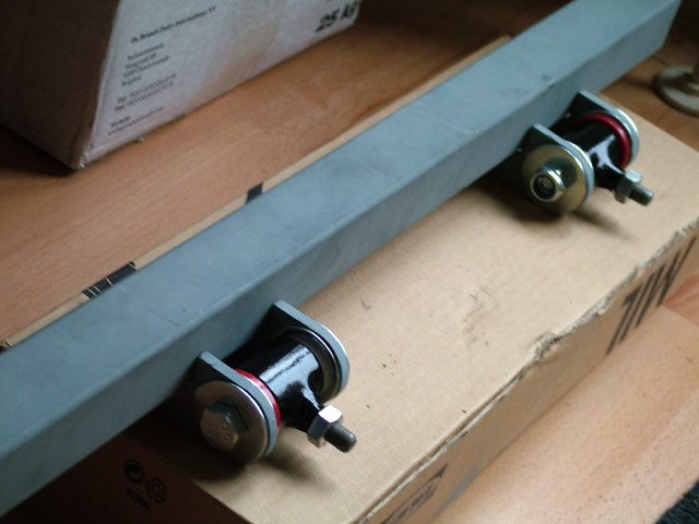

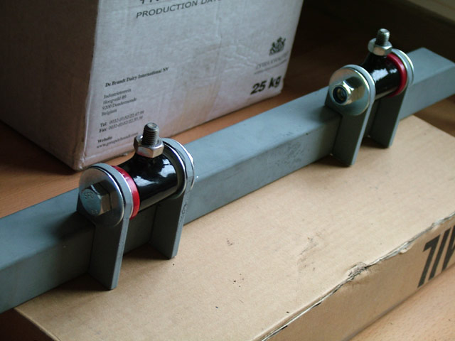

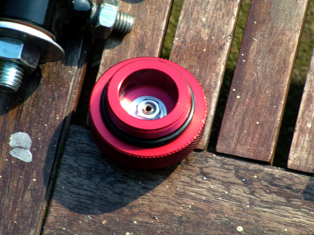

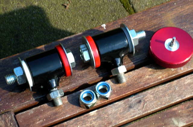

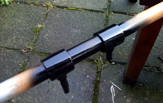

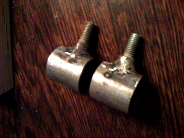

Ok more pictures machined the radiator overflow tank cap to mount a ...eh..mini breather
 On the left are the trunkside dogbonemounts

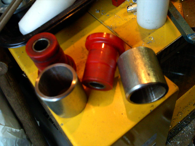

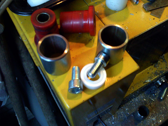

This is how I made them : starting with 2 upper A-arm poly bushings, cut and machined heavy duty gas pipe
 choice of bolts
 a bit of V shape grinding and almost ready for the $50 arc welder abuse
 halfway welding up and grinding down...and cutting slack
 paint

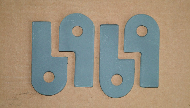

brackets taking shape
 I wonder what FreudFiero has to say to this
example of the setup, to finish it needs more work and an installed engine for the final setup, then welding and bolting up and paint..

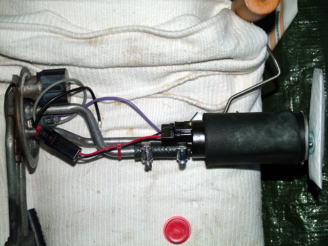

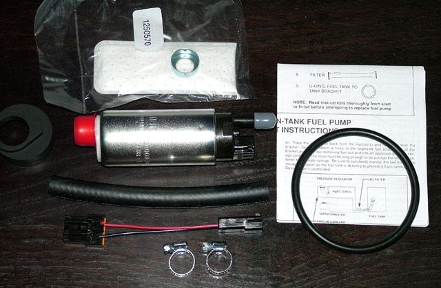

Anyway, I had some ISP problems last weeks so I have some pictures/updates waiting : This is the Walbro 255lph high pressure fuelpump kit
 Everything bolts right up
 I tested the fuelpump a few seconds to make sure it works

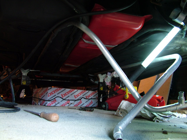

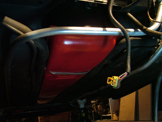

Fueltank ready to go back in...I call it The Sneaker
The usual struggle to hook up the hoses to the tank but its back in place..note the intercooler tubing is well away from the tank and doesnt interfere with the tank removal and install
Last drop of the IC tubes to solder the end fittings and finish, added a T for a reservoir/filling point in the enginebay
