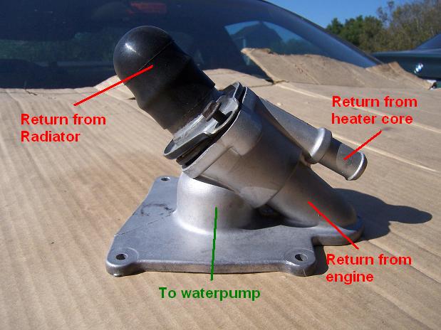

After typing out the big block of text above, I decided that a picture was worth a thousand words and explained it graphically. The recirculating nature of the thermostat balances flow from all these inputs to keep water temp constant.

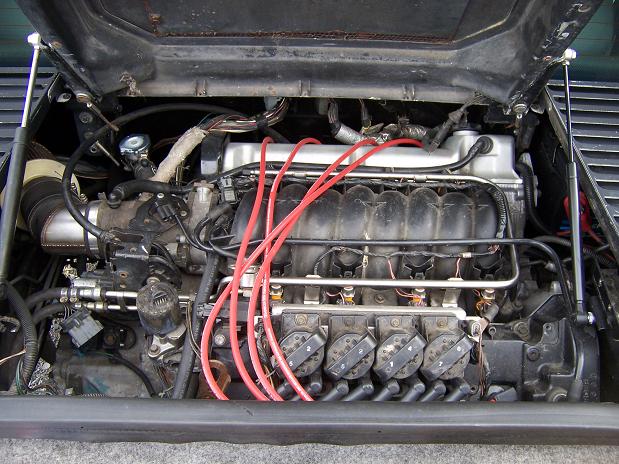

Here's a pic of my engine compartment with the shiny SS fuel rail, orange top injectors and F@#$ING RED, BITCHES!!!1! plug wires:

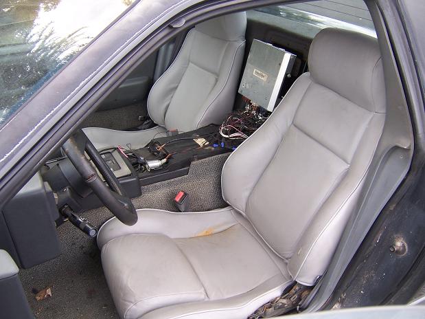

Here's a pic of my FREE Mr. Mike's seats. They're not pristine, but they're awesome for the price! There's a tiny bit of wear on the driver's outer bolster, but other than that they just need a tiny bit of cleaning.

Hmmm... now I'll have to go and double check my thermostat to see if I installed it right. I'm still not 100% clear on the orientation of the Tstat though. It might help if you could describe where the semi-circular notch in the lowest part of the Tstat goes in relation to some part of the housing.

The half-circle notches in the bottom flange of the thermostat don't care where they go. That flange is the recirculation valve. The only things that establish the preferential orientation are the two features I circled above. You can't assemble it wrong, as the hose connection won't screw all the way down if it's not installed the right way. HOWEVER, installing it the right way when it's on the car and pointing away from you is difficult.
