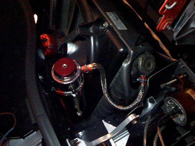

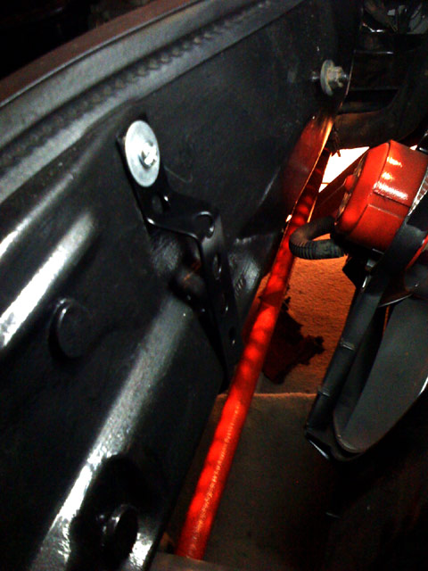

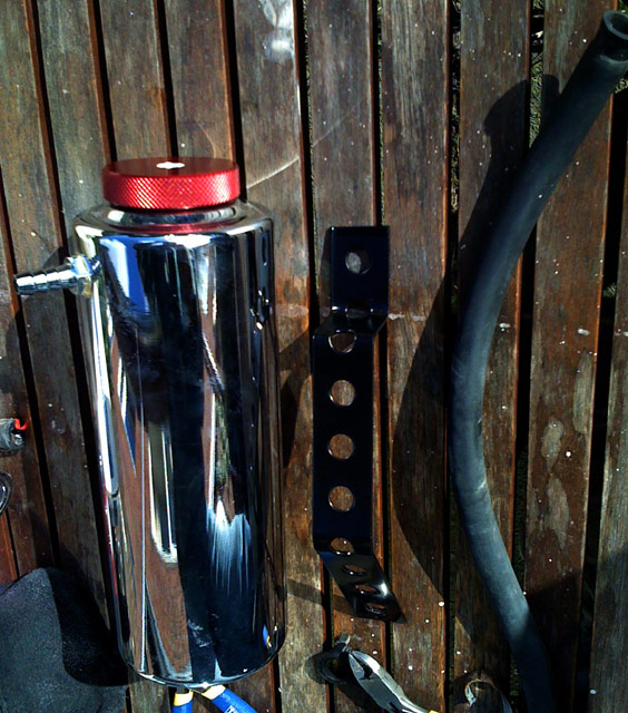

changed my fancy replacement radiator overflow can bracket setup to a custom bend basic bracket to clear the hoodvent and headlights..
painted and installed bracket

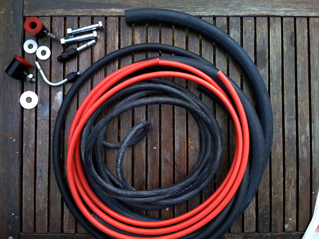

Got some tubing ...!
2m of 22mm ID heater hose
2m of 10mm ID fuelhose
4m of 8mm ID fuelhose
3m of 50mm2 battery wire (I have a front mount battery)...I didnt do a math on the needed thickness but it feels like a thick enough wire

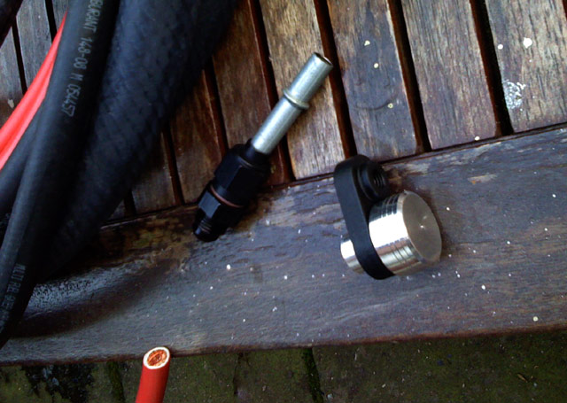

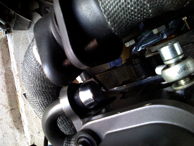

Turned a plug for the egr port on the stock rear (L67) exhaust manifold
testfit
I was thinking on using JBweld to stick it there...good or bad idea?

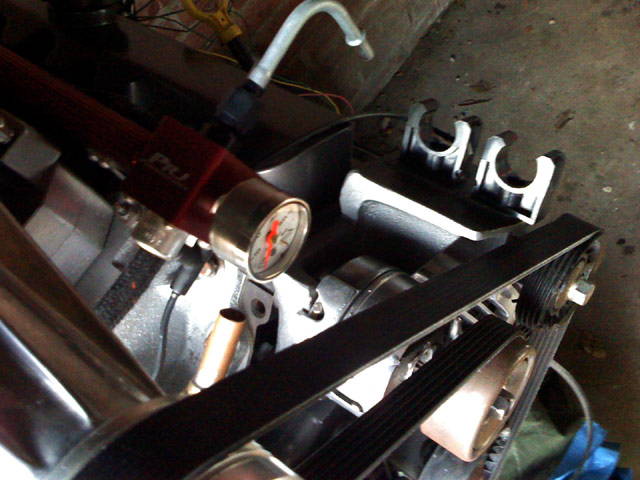

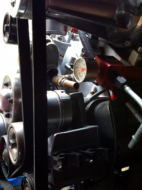

IC tubing guides
