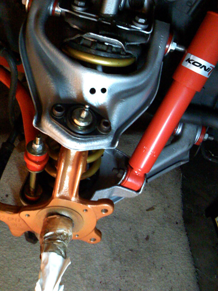

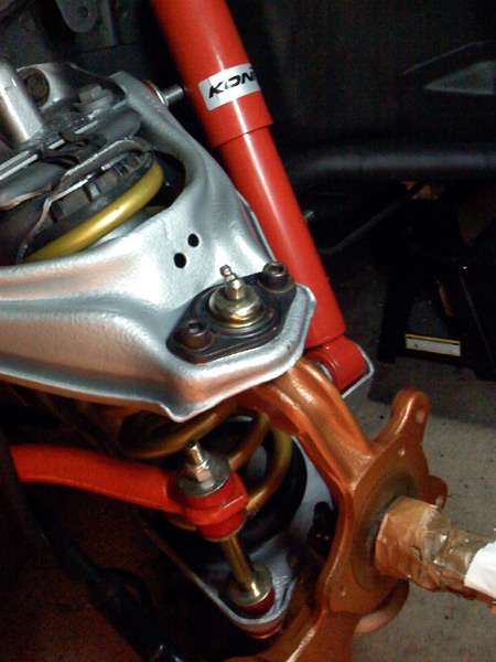

Most of the front suspension is finally done and installed..

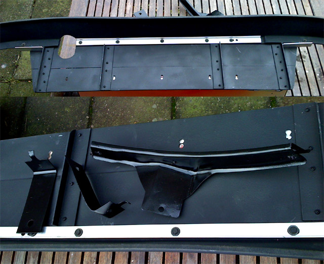

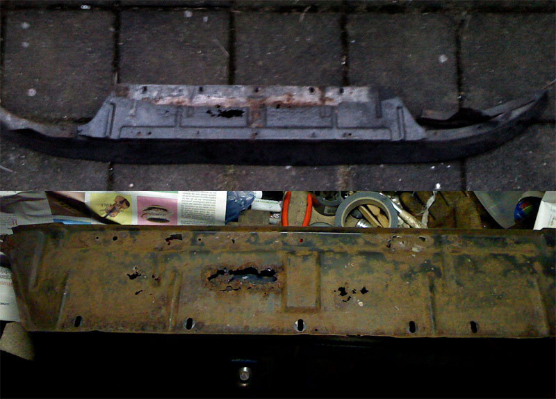

There are still a few jobs to do to the front underbody... first this airdam bracket is toast
 I just started to make a simple replacement piece in aluminium and will restore the other parts...then I can set up the intercooler hoses (I will have to add a little mod to the airdam for that) and then I want to fabricate a support bracket for the nose to feel save if I ever get to test the top speed ...when its done

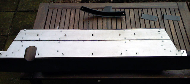

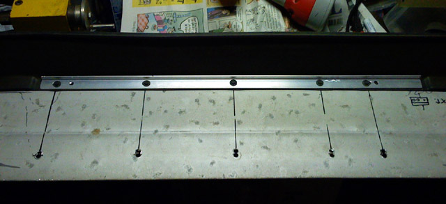

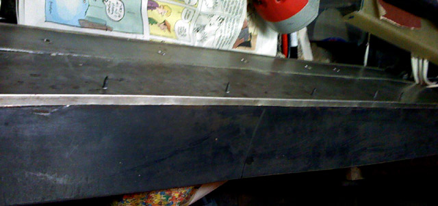

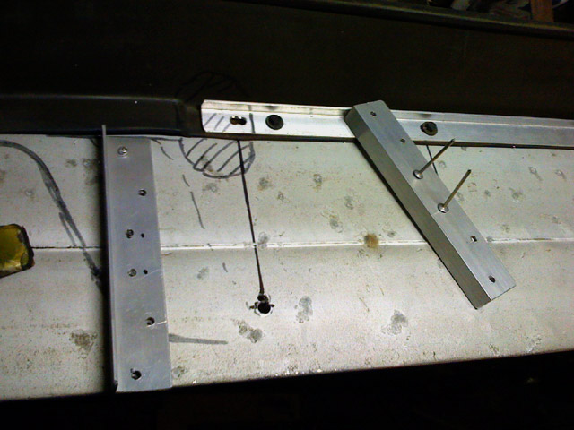

Started with some scrap aluminium with a good thickness
 mapping and drilling new holes
 testfitting

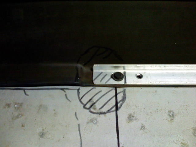

 This cut is needed to clear the IC radiator tubing
 I will use 4 L profiles for strength and pop rivet them

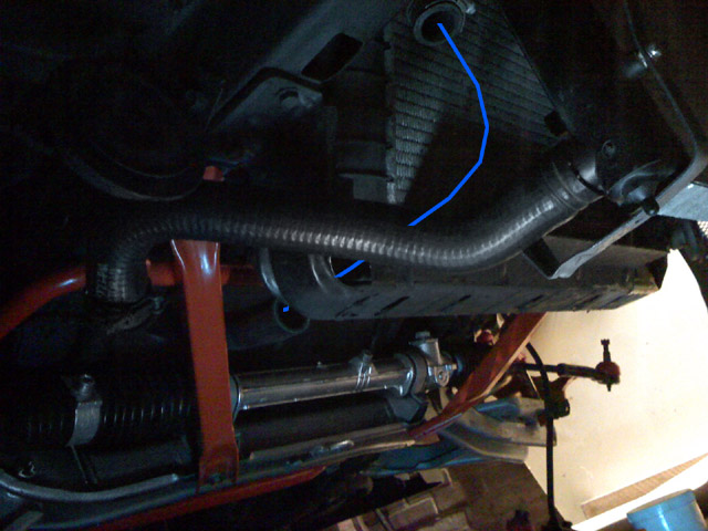

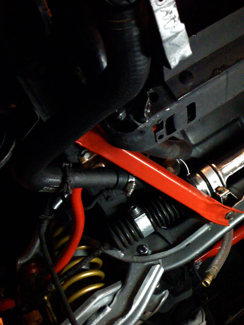

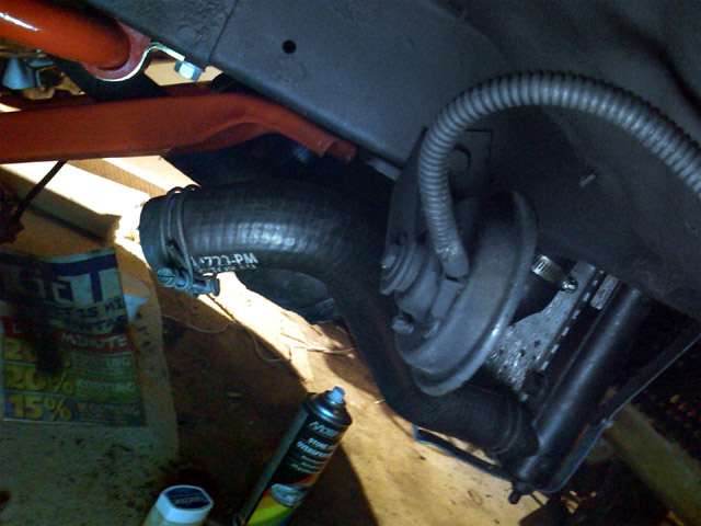

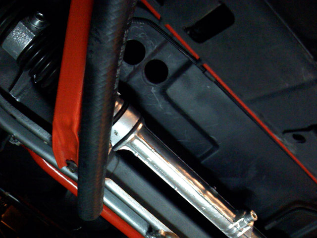

Now theres some extra space to try to setup the tubing for the IC radiator. I decided I want the pump mounted in the front trunk...for easy access I guess. This doesnt make the routing easier..hehe. After some trying and combining hoses and adapters:
 This is a Fiero hose, it fits and curves just right!

Some finished, cleaned and painted parts..:

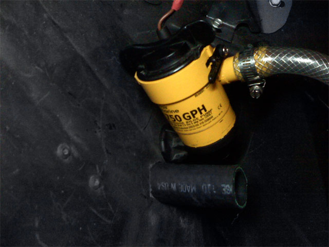

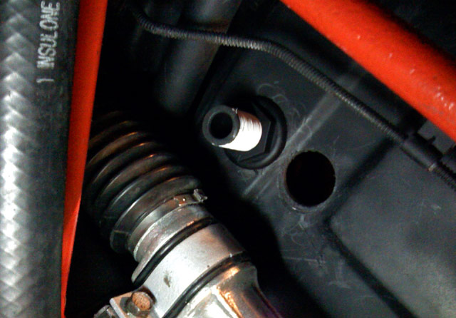

Ok, moving to the front trunk, I will pull everything out to route the IC plumbing first..

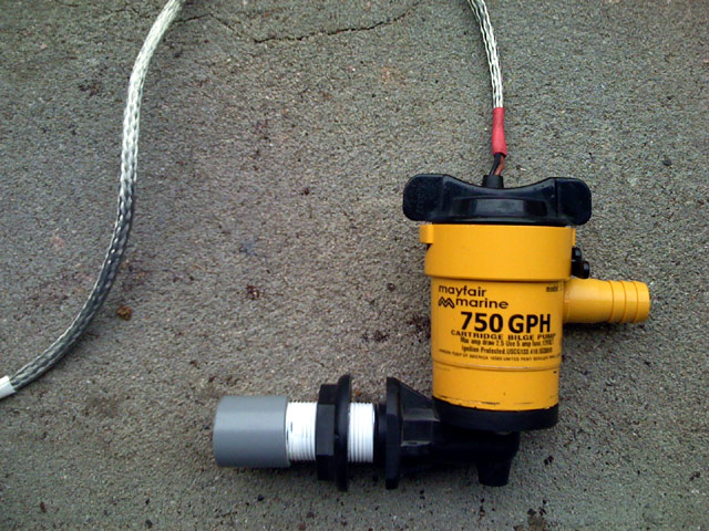

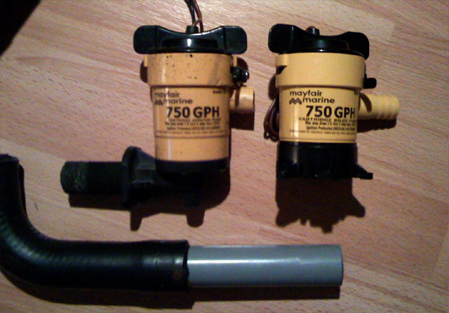

I got two bilge type pumps (1 new spare) with the kit, the used one has a cut or broken outlet so I am going to switch some parts..
Now it is set up, the threaded inlet and nut make it possible to mount it through/to the trunk wall, added teflon for sealing and made an adapter to mount the wider radiator hose
2 holes
fitting the pump inlet
I dont know about the reliabilty of these pumps (theyre made by Johnson), but they are easily replaced (click and turn cartridge type), cheap and now easy accessable (just lift the front hood )
Getting more stuff hooked up
