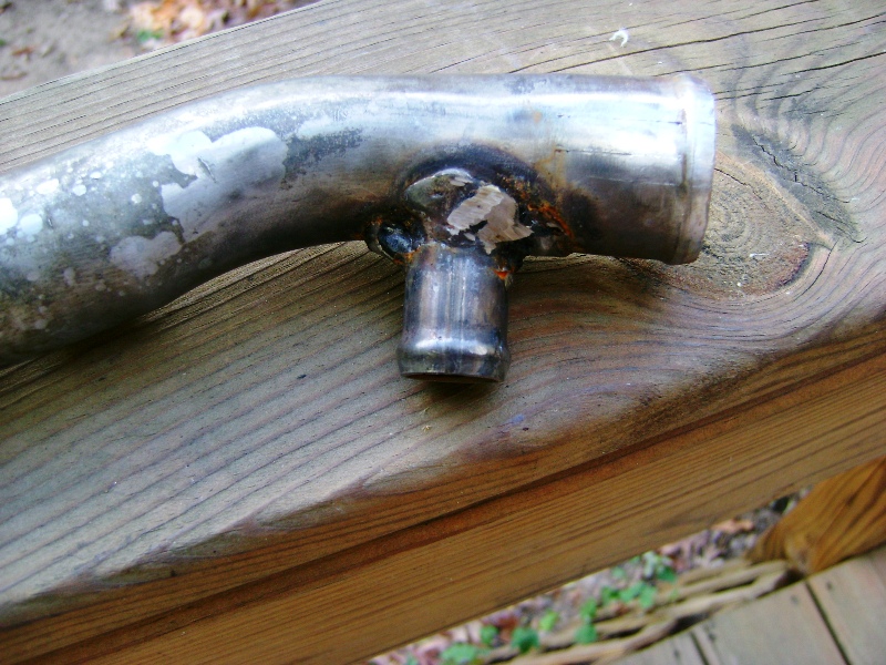

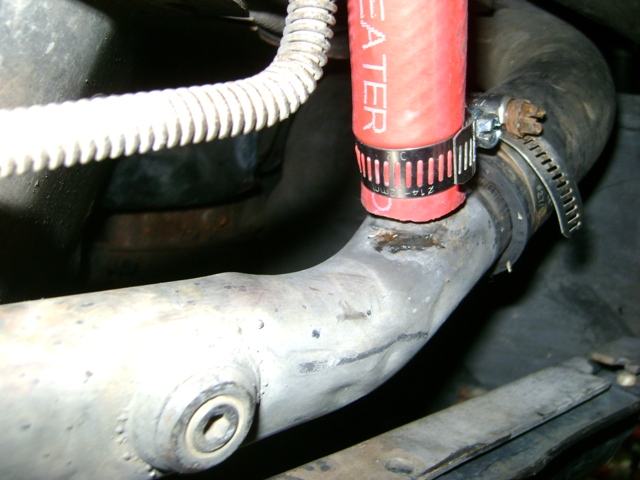

Went out in the garage during half time and removed this piece. The nipple for the heater return is leaking:
the leak
Gonna find me a shop that can weld stainless steel one day this week.

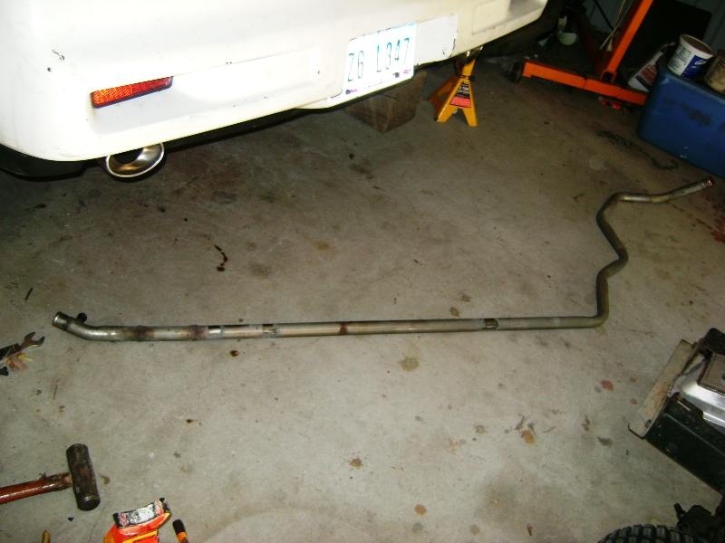

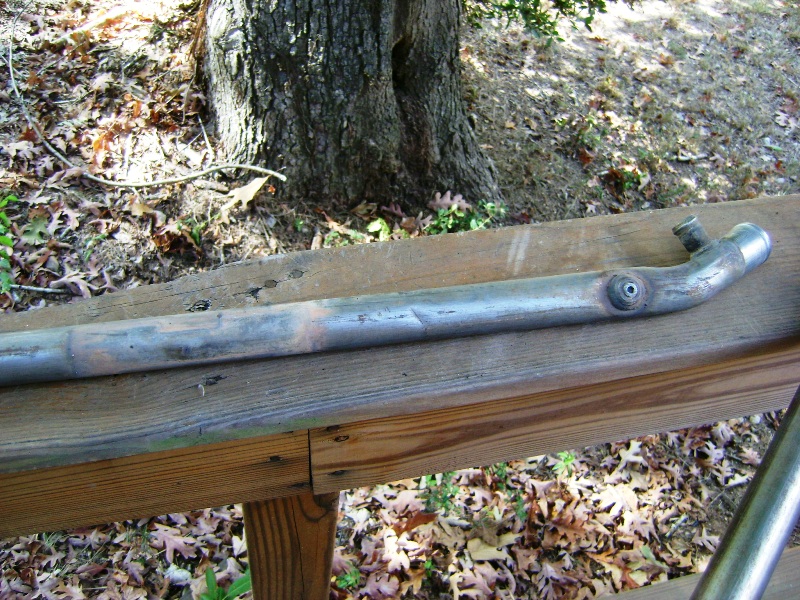

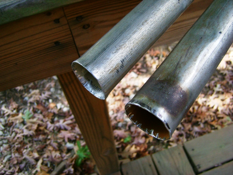

I removed all of the above again after having it welded up. Still leaks. I got a 24 inch piece of 88 return side pipe, with the nipple for the heater return, in the mail from Mstangsbeware a few days ago. I cut off the leaking part, and used a small ball peen hammer to put a small amount of flair on the extreme ends.
New piece
Flaired ends:

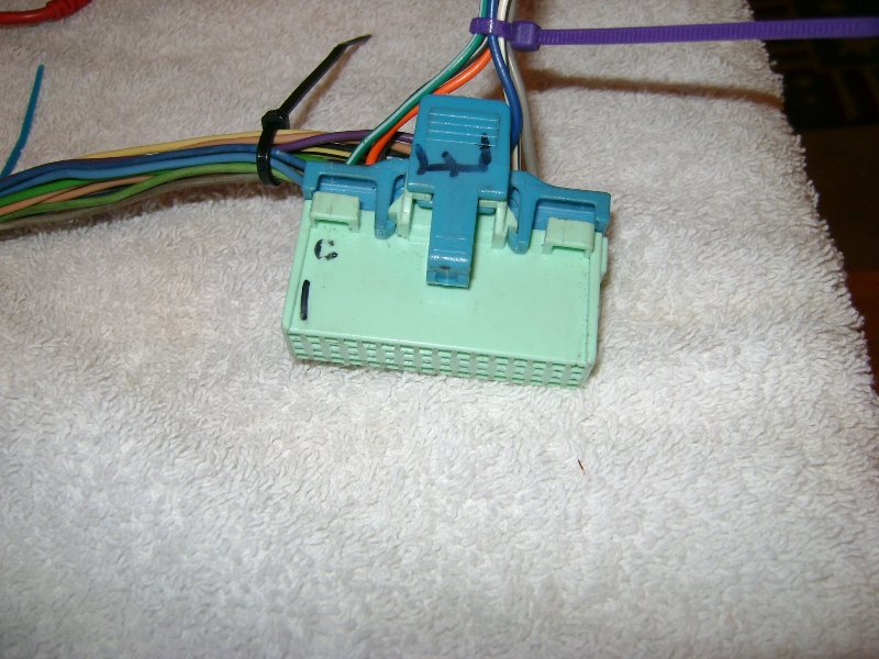

I am going down the line on each ECM connector marking the loose ends for reconnecting. If a wire stays inside the cabin , like speedo or VATS bypass, I am pulling them all to the dash side of the connector. I am gonna insert the green first, lay out the wires, then the top black, then the lower black one.
Green one ready for reinstall
