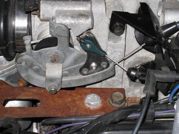

I promise you that I am not telling you what to do, but only a suggestion. The bottom cable comes out at about a 25* angle from the bracket mount. It doesn't look like it would bind, but very close. I know I am only looking at one pic, from one angle, but I just see it wearing at the point where the cable slides in the plastic sheath. I think that if you were to remove the bracket, and give it a little bend, it would guarantee no future issue in that area.
If I am off base, please disregard. If not, glad to be of help.
Tony
opm2000
JUN 06, 08:57 PM
Tony, I think you may well have a point. I'm all about trying the simple things first, and believe me, I'll try your suggestion right off. As proven by simply switching to this bracket & lever arm, the shifting actually works. As you have pointed out, it does seem to be in a bit of a bind.
