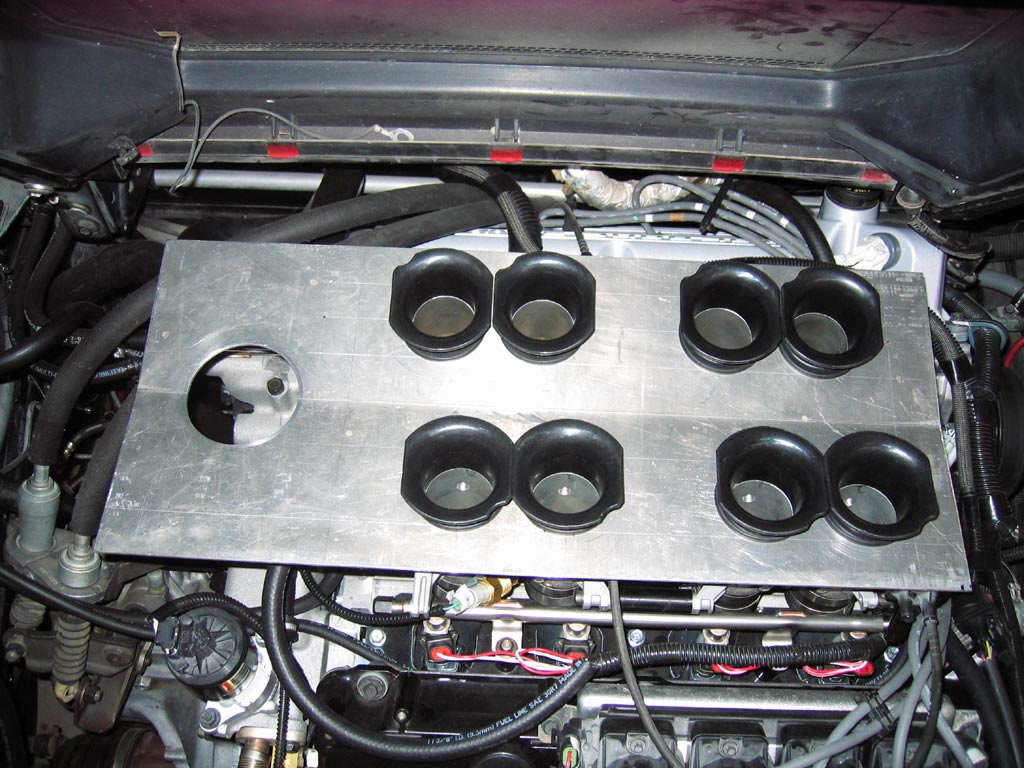

Not sure what that looks like but today I finally got all the holes cut in and the metal bent to match the angle of the ITB's. It needs to be trimmed some more but this is the basic idea. The FAI intake hole is only 3 1/8" right now as that is the largest punch I had. I will enlarge that as necessary to fit whatever tubing I end up using. For this to work properly I am going to need to cut and raise the decklid over the plenum. I will have to decide at some point if I will do that or not.

If you cut off the top of the velocity stacks just above the base plate "gromet" area, would that allow it to go under the decklid once the top of the airbox is fitted? It might hurt the airflow above 10,500 RPM somewhat however.

Hi Russ, I am glad you brought that up. With the full height of the vel-stacks there is not quite enough room above them to draw air unrestricled. I would rather not cut them down because it takes away from the "bling" factor. If they really do nothing in the stock rpm range I will cut them down to achieve more space between the ITB inlets and the bottom of the decklid.
