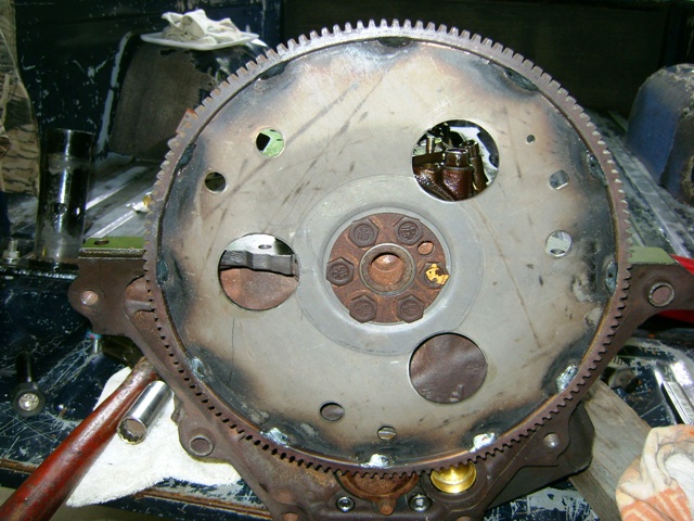

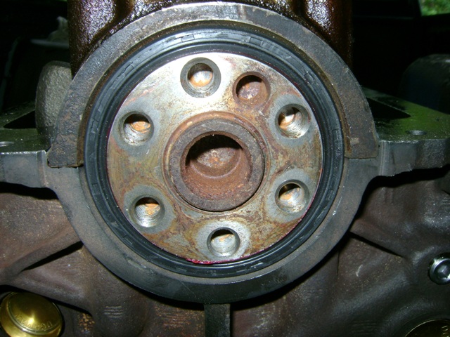

I backed my truck into the front half of my garage and rolled my engine to the tailgate. Sat the engine to the tailgate and removed the engine stand mount so I could have access to the rear of the block. I installed a new gasket on the rear cam cover this morning. Also put in the three expansion plugs on the rear of the block:
New Timkin rear main seal:
and the 88 Flex plate:
All fasteners were torqued to specs.
