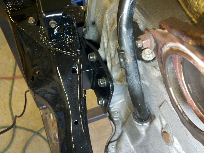

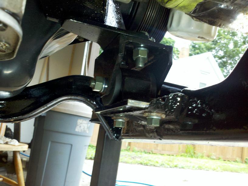

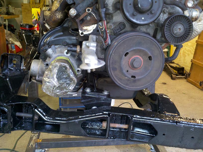

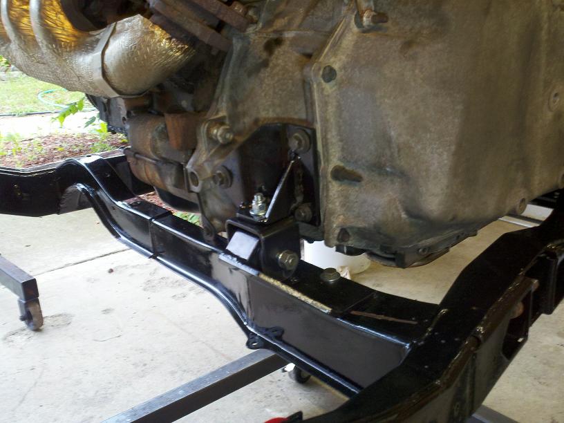

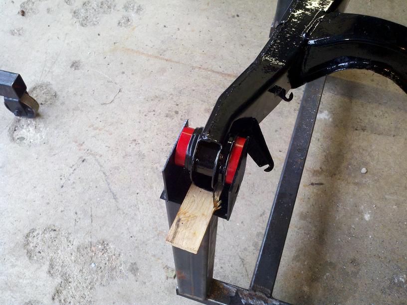

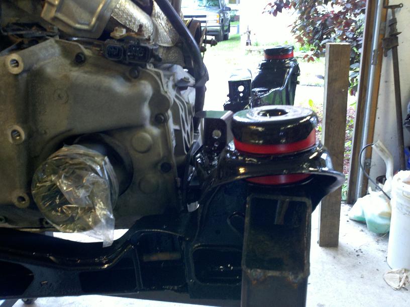

I finally got my cradle bushings today, still waiting on the control arm bushings.
Here are some pics of the fieroX mounts.
1fatcat
JUN 23, 08:26 PM
Those are the best pictures I've seen of 3800 mounts. Thanks! I never knew the front mount was only attached to the right side of the block.

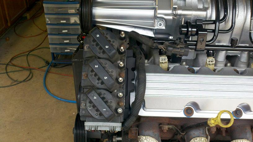

I did the Ignition coil this afternoon.
hercimer01
JUN 24, 07:06 PM
I am assuming this will clear the hinge and decklid. Right? Has anyone done this ? Edit Or does it have to go on show side fromthe rear of the car.[This message has been edited by hercimer01 (edited 06-24-2011).]
JamesCurtis
JUN 24, 07:35 PM
I do believe that will hit the hinge. It's not too difficult to relocate it by the battery tray or by the trunk. ------------------
RULOOKIN
JUN 24, 10:23 PM
| quote | Originally posted by hercimer01:
for sure it will hit the part the trunk hindges mount to i had the same issue so i mover the ICM to the trunk wall you will have to extend the wireing as well trust me dont try to use stock ICM location i wont work it to tight and a ***** if you ever had to change a coil or modual, I was even thinking of putting the coil pack inside the trunk pop a hole throught with a rubber gromet for your wireing and plug wires you will need aftermarket wires to do this ( longer ones)
sportcoupe
JUN 25, 07:52 AM
He may have to loose the decklid spring but it shouldn't hit the hinge itself. The spring may have to go anyway since they sometimes hit the supercharger. Mine did.
I have my coil packs mounted it the same spot as the OP except I turned my on their side for more room and easier access for the connections. I'll get a picture later today.
hercimer01
JUN 26, 12:51 AM
Any help would be greatly appreciated.
MstangsBware
JUN 26, 01:02 AM
Not going to work....You have to mount the coils else where...Best place is the battery tray and move the battery to the front.....
