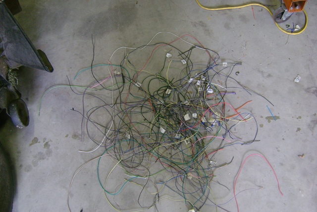

I have about 98% of the Cadillac injector harness finished as of this afternoon. Every wire that goes out to the engine is fitted and tied off for first fireoff. Tomorrow I will start adding the C203/C500. I hooked a battery charger to my fuseable links this afternoon. I had hand cranked up the headlights, and they both came on. The Blue Dingy thingie started singing to me. I couldn't see any dashlights on in the dash pod. Both dome lights were dead. I'll do more power ups after I have the next stage wired in.
This is how much excess wiring was in the Cadillac 4.9 injector harness:
