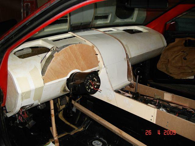

Chris_86GT APR 26, 06:08 PM
Last weeks progress...

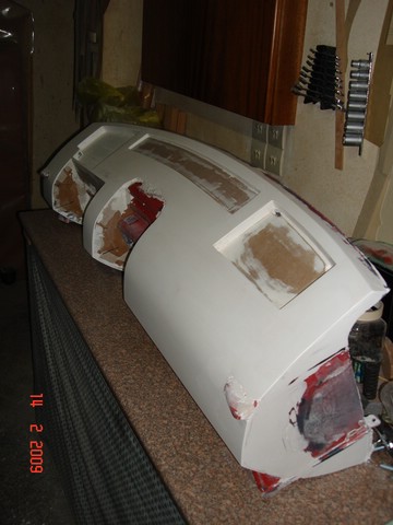

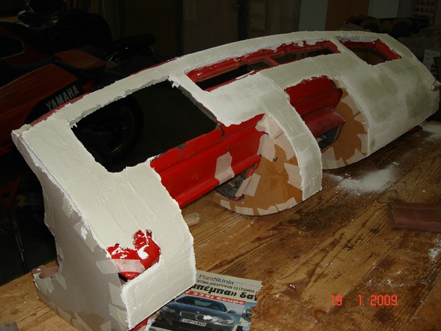

exoticse MAY 05, 03:31 PM
Chris,
I am going to be building a pair of custom dashes soon and was wondering what is that material you were using to craft and cover the dash just prior to fiberglassing ? Some type of plaster or foam ?
Also the brown material you are using as templates, throughout the build, is that cardboard, MDF, or something else ?

Chris_86GT MAY 06, 09:12 AM
Chris,
Oh and BTW your dash and side scoops look fantastic ! Keep the pics and progress coming.
I had some tiles glue lying around and I used this to form the dash. I use cardboard for the dash and mdf for the center console, if you want a straight part then use mdf cardboard is good only for curves.
I am not a professional, its my hobby, I am sure there are other methods to make a mold, but the stuff I used are cheap and I don’t mind the extra time I have to spent.
