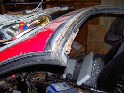

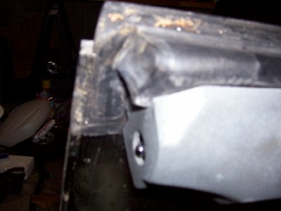

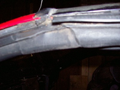

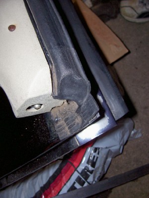

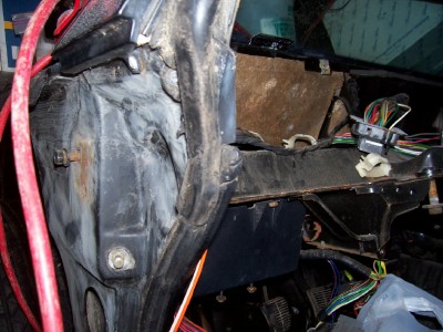

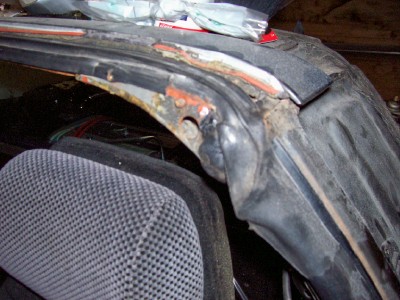

This was posted by another member on another thread, I think it's worth posting here to keep some good info at one place. Credit to FieroCustom
| quote | Originally posted by FieroCustom:

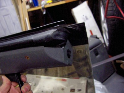

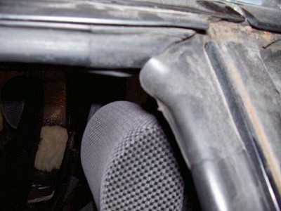

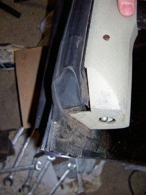

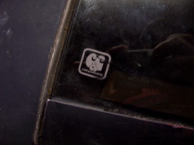

Ok, I just snapped and edited some pictures for posting, so here goes, a little introduction to the difference between CJB and non-CJB t-tops. With a couple pictures of the glass seals so you can tell the difference. 88 CJB glass, note the Cars & Concepts logo on it:
 This is a non-CJB glass, it also has a Cars & Concepts log on it:
 This is the union of the CJB glass seal and the CJB B-pillar seal:
 This is the union of the CJB glass seal and the CJB A-pillar seal:
 This is the union of a NON-cjb glass seal to my CJB B-pillar seal: (note the shallower angle of the glass seal, the non-cjb door seals are bigger than CJB to fill in that gap)
 This is the union of a NON-cjb glass seal to my CJB A-pillar seal:
 This is the B-pillar side of my CJB glass seal:
 This is the B-pillar side of a NON-cjb glass seal:
 This is the A-pillar side of my CJB glass seal:
 This is the A-pillar side of a NON-cjb glass seal: (Note the different shape of the front of the seal)
 This is the start of the CJB door seal, just below the A-pillar:
 This is the CJB door seal at the peak of the A-pilllar:
 This is the CJB door seal at the peak of the B-pillar:
 This is the CJB door seal at the midpoint of the B-pillar
 Ok, everyone knowledgeable about T-tops check these out, please let me know if any of this information is wrong. My car does have the CJB code, and I'm going under the assumption that the door seals and driver's side glass are actually CJB. That is what was passed down to me when I bought car. Passenger side glass is different because original owner broke passenger top. To my knowledge, the passenger side glass is non-CJB. Sleebie, I hope this helps you find matching glass and seals, because you want to be able to put these on if it rains without having to bail out your car. |
