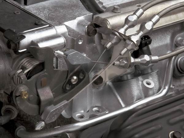

The yellow pantera has been languishing with an untuned transmission problem. It would not upshift or downshift, and burbled horribly when the accelerator was pressed. I replaced the water pump, optispark, and alternator last year. Things got a bit better, but not much. I took Blackrams & Fieroguru for quick spins and got various responses from "this is going to be fun" to "change the torque convertor".
So, back in the winter Blackrams horsetraded an '88 shifter & cables for a Lokar shift bracket. Being the frugal builder I am, I had tried making my own kickdown cable bracket, instead of buying the $50 bracket from Lokar. My LT1 is a '94, made with no provision for a kickdown cable. Only '93 LT1's have this option. But Lokar makes this neat little add on bracket.
Since I'm having a problem with PIP, this is a stock pic of the bracket. I'll post installed pics later.
PIP is up, so here is the harsh reality
My homemade bracket is the rusty plate with the hole in it. I had tried mounting the kickdown cable from the front of the throttle body, and attached it to the existing cruise control stud. That really didn't work too well.
But the Lokar bracket kit has this neat little arm with just the right geometry. It bolts directly onto the throttle body and has the proper rotation.
You can see the black bracket to the right, which both the throttle cable and the kickdown cable attach to. This is an aftermarket bracket, sold on ebay to accomodate transmissions requiring kickdown cables with the LT1.
So, I had time to install this gem today, light a candle and say a prayer....and fired her up.
Wow! I thought the LT1 was cool, but suddenly the trans is acting right. It upshifts, down shifts, kicks into passing gear, and goes full throttle whenever you smash the pedal. And it felt like there was a second or third engine in there.
Big grins.
