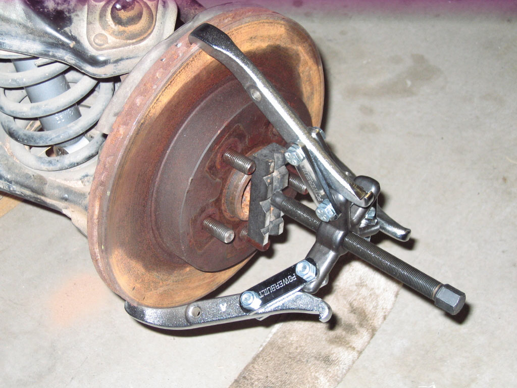

I started working on installing the brake flex lines and master cylinder on the 88 but ran into some resistance trying to get the front right rotor off. 24 hours of PB, heat, hammering and pulling finely paid off and I was able to R&R that brake setup. I just need do the left front brakes and install the flex line for the left rear brake. The master cylinder will be last to go on.
Picture of a stubborn right front rotor. This was after approximately 22 hours of working on trying to pull it off the hub. Amazing what 21 years and some light rust can do.
