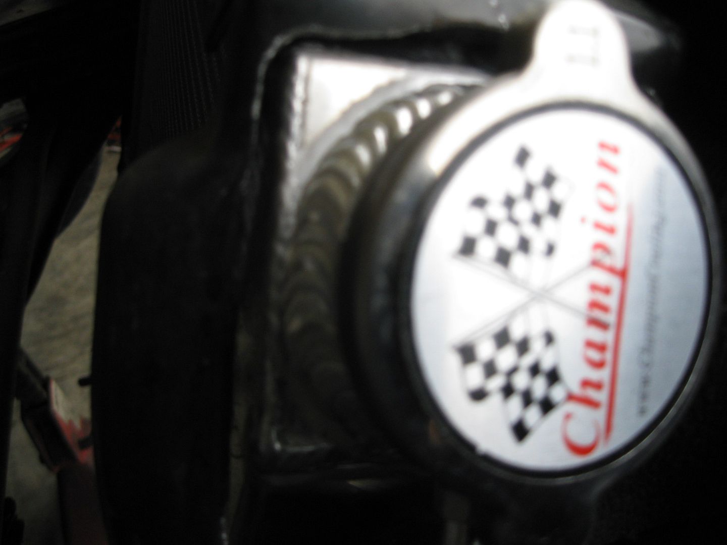

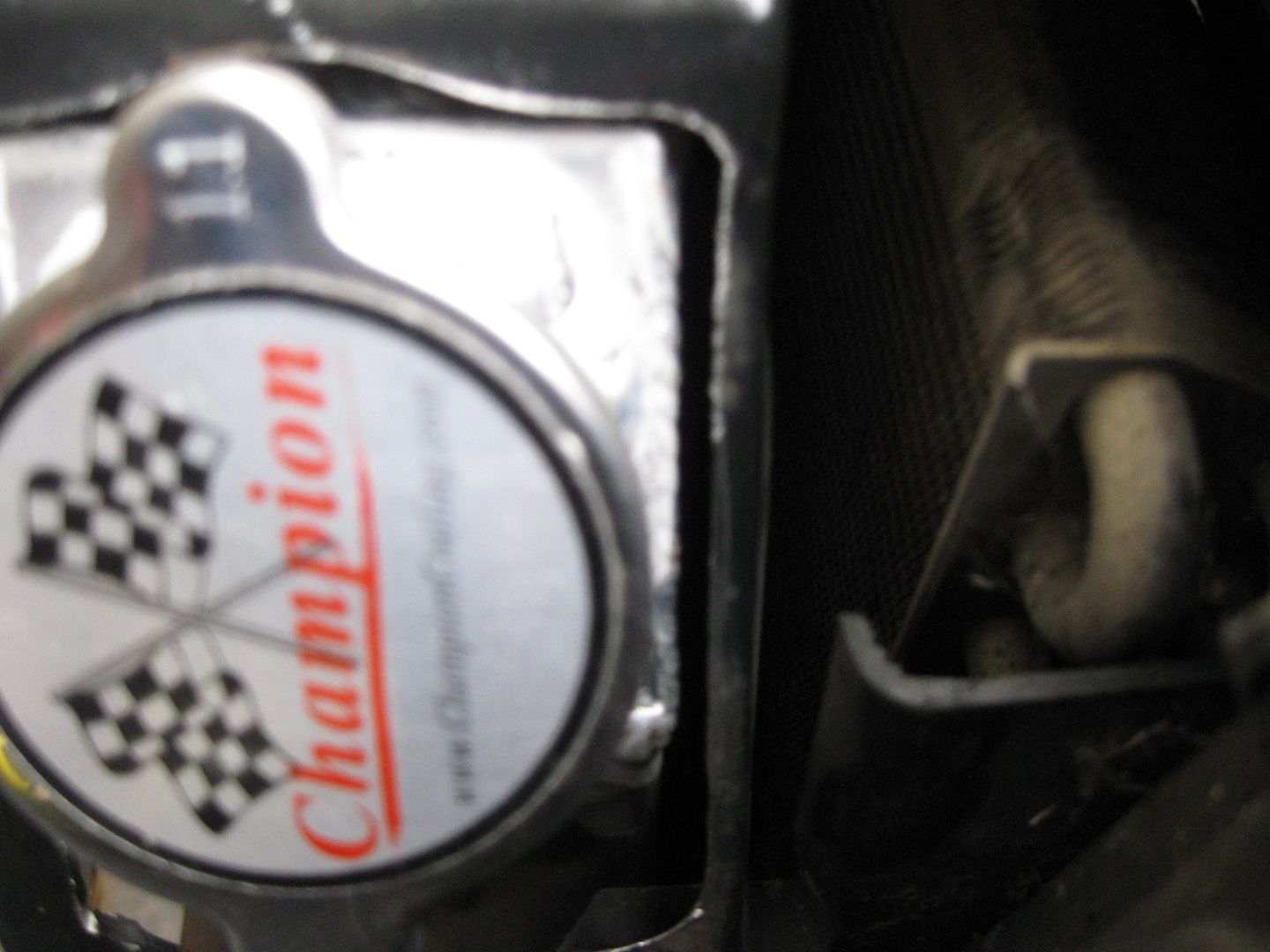

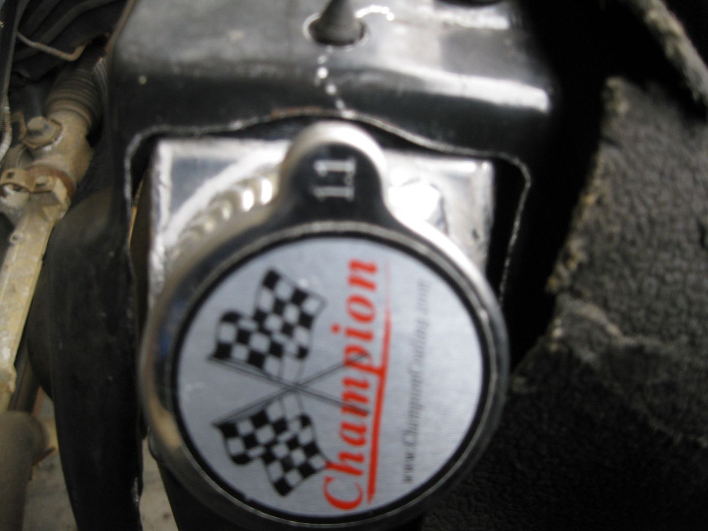

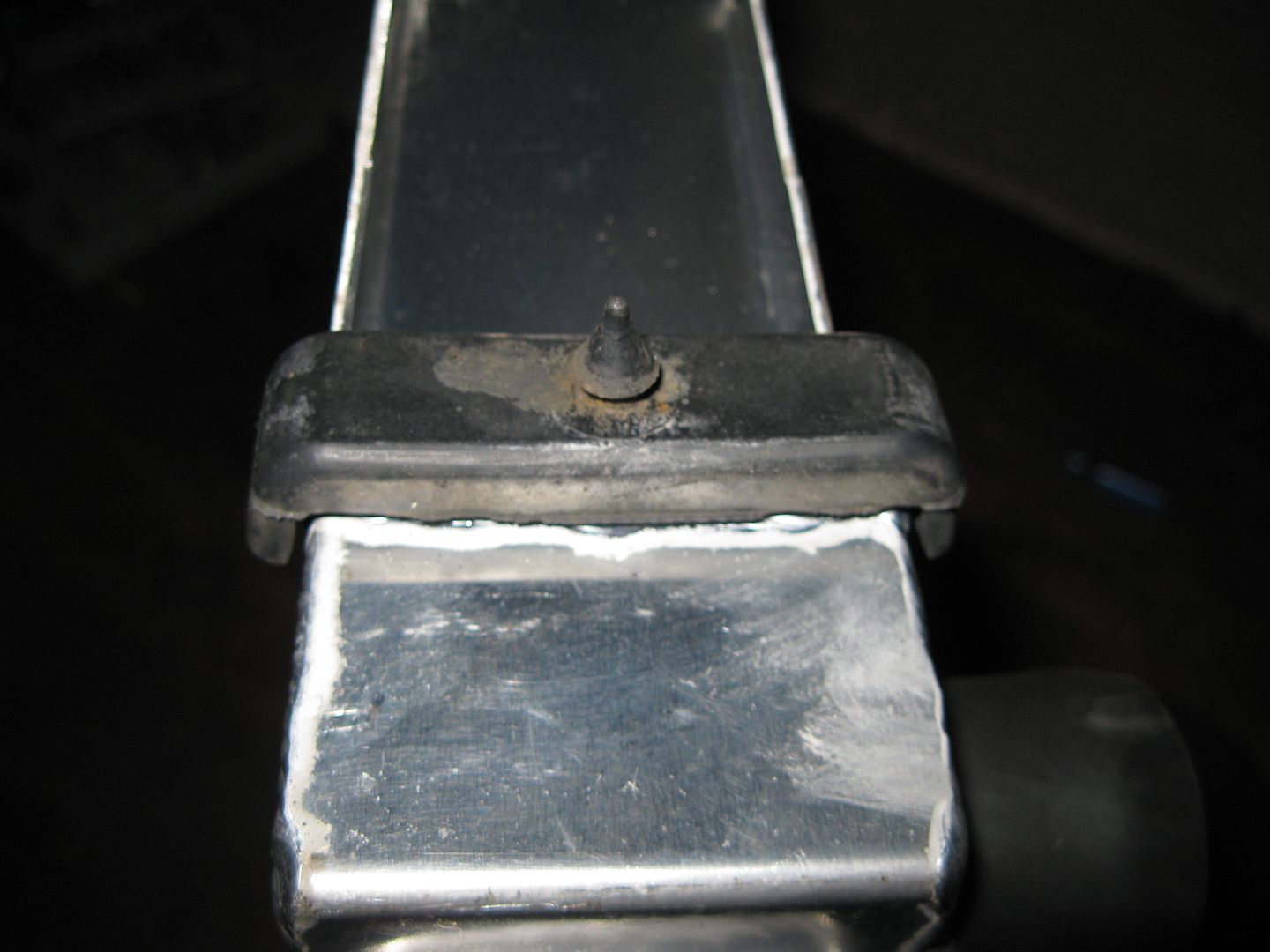

I think the radiator upgrade is now complete. I ended up reshaping the top rubber seats as well (modified one in front, stock one in back):
The only modification to the sheet metal was to open up the hole around the fill neck:
I didn't need to do any modifying to the driver side, probably because I was able to slide the radiator over about 1/8" (with the larger fill cut out) to get everything to clear.
