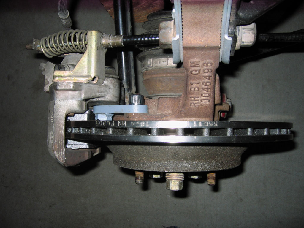

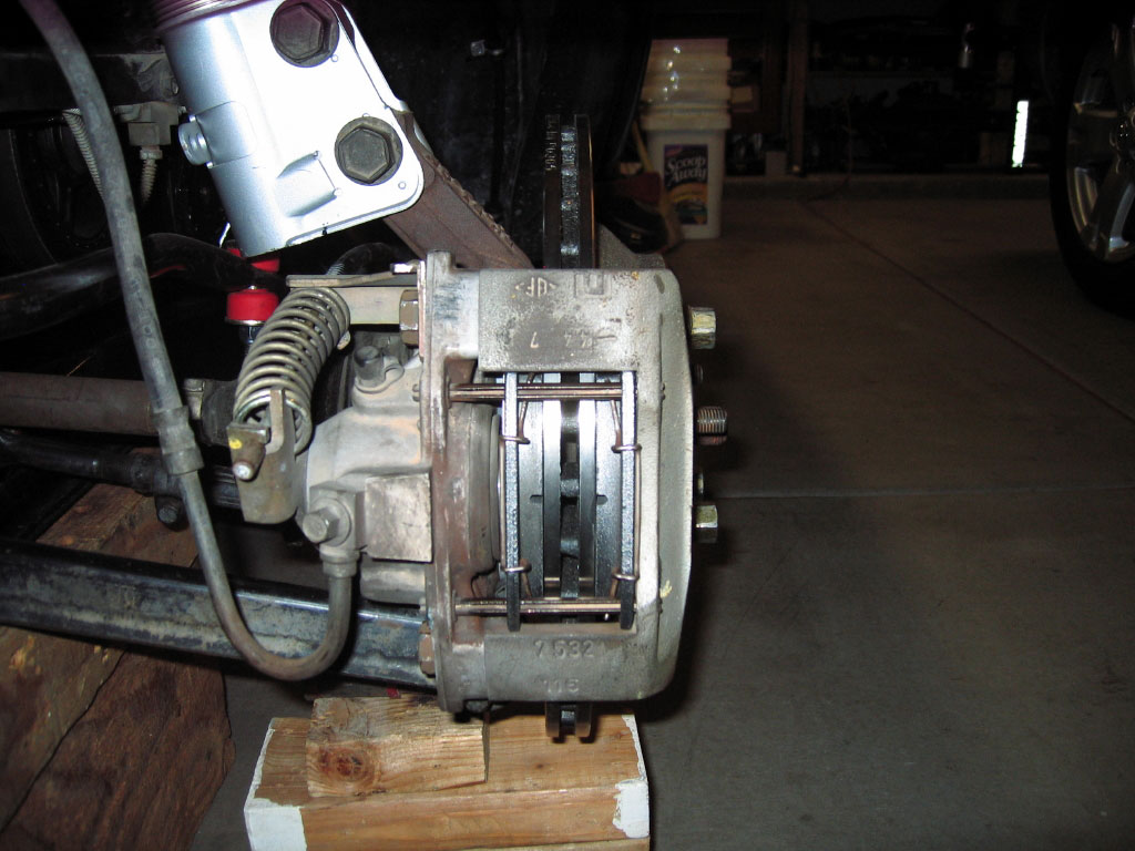

I found a company locally that was able to come close to the same cable setup that is stock for the Fiero. I had them sell me a cable that was 7" longer than stock for the cable that runs from the ebrake handle to the splitter/adjuster. It seems to be ok for now. I will have to see how it works over time. I am new at doing the Fiero brakes so I spent extra time tonight learning about them and completing a brake pad R&R for the right rear brake. The caliper appears to be the pre-recall style with the plastic air-vent plug in the face of the piston. It seemed to be in good condition overall so I just cleaned it up a bit and lubricated the sliders. I used the "screw-in" method to compress the piston into the caliper and that seemed to work fine. Tomorrow I hope to get the other side done and then I will start looking at how to get cool and clean air to the ITB setup.

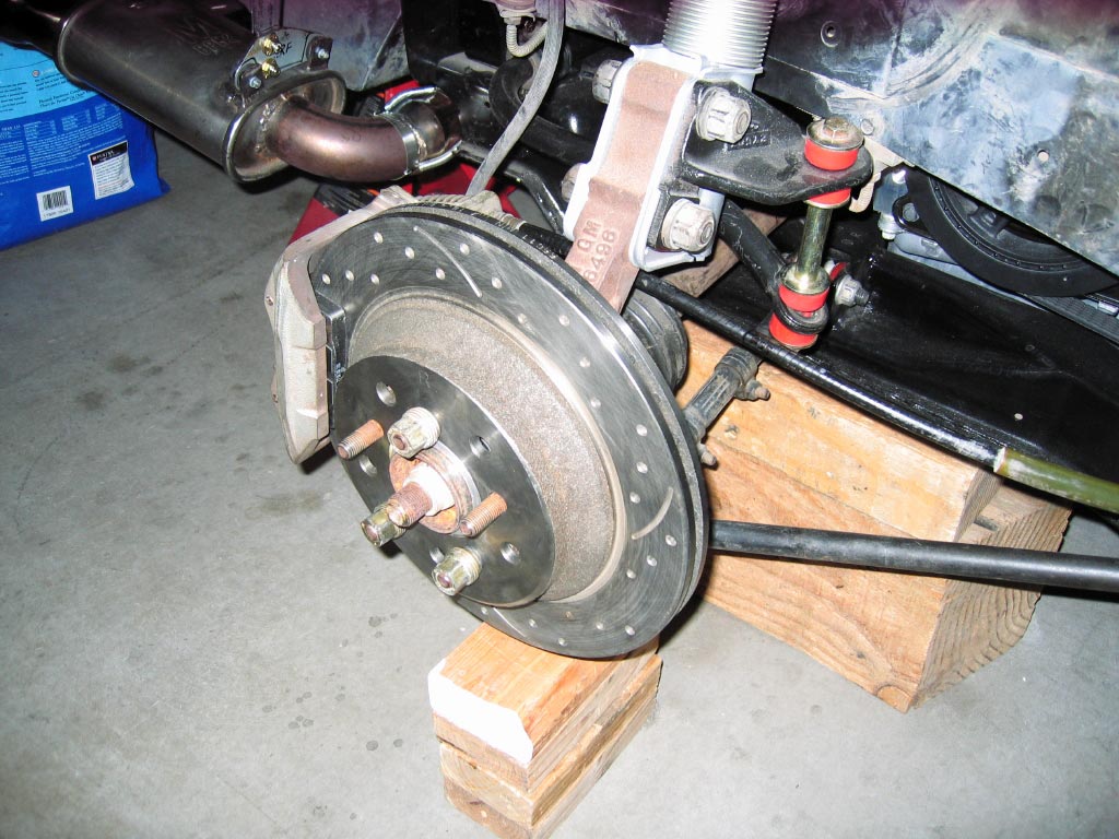

forgive the question, I am tired but, are those 12 inc corvette rotors?? They look like mine of which I am personally very pleased with on my car stopping power and anti fade wise

Why yes, they are. These are from the batch that GSXRBOBBY put together and sold several years ago. Thank you for the input, I was hoping that they would be a nice improvement. I still have some work to do on the brakes. After getting the left side cleaned up, lubricated and new pads installed, the brake pedal feels mushy so there may be a bleeding to do or maybe something needs attention that I missed.
