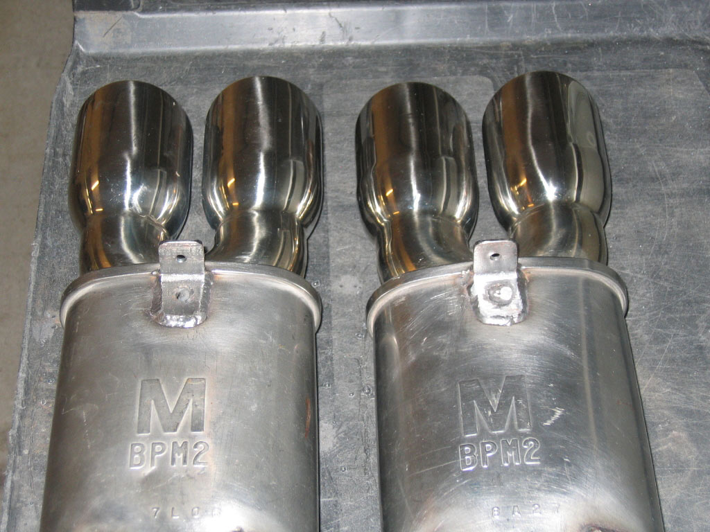

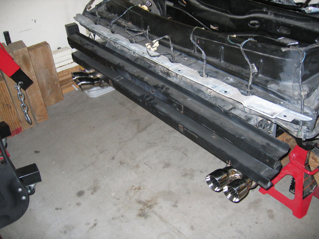

I kinda lied about only needing to put in coolant and hook up the + cable. There was the baby mufflers to put back on and I needed to clean up the install a tad too. The angle iron was cut and ground to improve the appearance and also get rid of the extra weight that was not doing anything. Then the stubby pipe was cut off the baby mufflers and some cut-down C-6 corvette resonator tips where welded on. (horrible weld job with the bad angles) I still need to install the ebrake cables and see how close I came with the brackets.
These C-6 tips look Bad Azzz to me!

I have those exact same tips I am using for my N*! What mufflers are those?

Hi Erik,
EDIT: Disregard my previous rambling. I did a search and found that the Mazda MX-5 (not sure what year) has these exact mufflers. They are the primary muffler of a two muffler system from what I can tell. Look at item number 9.2. Here is a link to the .PDF file that has the info near the top of the page along with pictures near the bottom of the page. I was given these as used for $10 each. The're really just straight perforated pipe with glass packing around them. Better than nothing though. I got a 10 minute video uploading to YouTube.com of the first start of this engine. It idles better than the first one and after it kicked out all the oil (in the form of smoke) in the left exhaust from the old engine, it seems to be running awesome with no smoke. I hope it continues to do this well. Now I will really have to work on getting this thing roadworthy.  Video link...  [This message has been edited by cptsnoopy (edited 04-19-2009).]

That left exhaust was very annoying till it cleared up ...It sounds quiet enough ..perfact for tooling around ..I bet it really barks when opened up and adds to the symphony of ITB's ..I'll check into getting some mufflers like that as I really have no room for them anywhere else unless I want to go with a stock style muffler config and I surely don't because its all about the sound for me

I took the instrument cluster off and fixed the temp gauge and tachometer. Now that I got it all assembled again I can see what kind of trick it will be to get the ebrake cables routed and connected.
