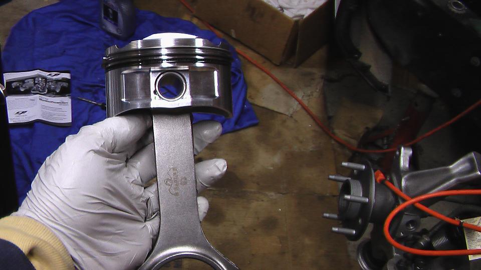

Are those the CHRF Arias pistons?

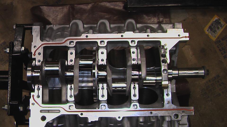

The Pistons are CP, about two years ago I talked to you via this forum and followed your lead. They are 12:1. The block is a 04 with an 04 crank. In 04 some cranks were forged, this one looks forged based on the seem seen in the picture on the rod journal. The balancing guy who did the rods, pistons, rings, writs pins, and crank thought it was a forged crank too. He said the set up we have is the lowest rotational weight for any V8 he had ever seen. in addition this was the last year for the LS1 ECU style crank pick up. I write software for a living and once worked on a product that used the Delphi PCM32U (LS1 ECU), as a side project I re-flashed that ECU with my own boot loader and program code completely erasing the GM software. I plan to use this ECU on this project.

Very interesting info on the forged crank. I knew the RWD engines had forged cranks. It would make sense to use the same part in both engines. The Northstar does have a lightweight rotating assembly. The small bore means that the pistons can be lighter than anything for a Chevy. I took 300 grams per cylinder out of the stock bobweight between the Eagle rods and CP Pistons. Did you have your crank balanced conventionally (by drilling holes in the counterweights)?
