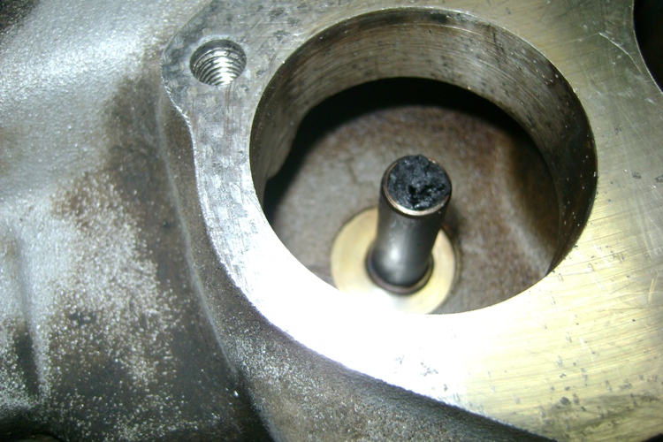

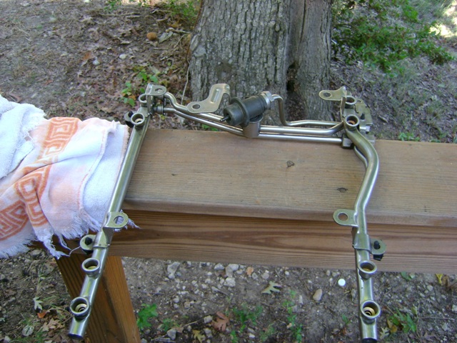

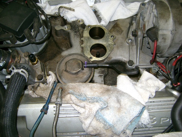

I went out at 8Am and removed the fuel rails and the old injectors.

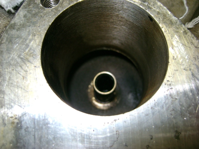

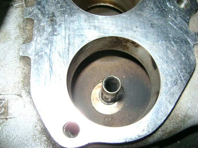

Underneath the throttle plates:
I used a 1/4" drill bit with my fingers and removed that crud. I then used a shop vac to suck out the pieces. If you do this and decide to blow air threw there, some of the stuff will come out of the forward hole, so watch out to keep it out of your eyes. Ask me how I know:

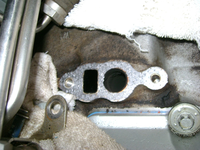

I removed the EGR valve. I used compressed air and the air comes out threw the rectangle hole. This was easy. I should have done this the first time I had the throttle body off of the car.
Just knock the crud loose with a drill bit, then blow and clean it out with air, and a shop vacuum. When I used air in the rectangle hole it came out of both of the two holes in the center of the throttle bores. The rectangle hole is on the drivers side of the engine.
[This message has been edited by josef644 (edited 08-08-2010).]

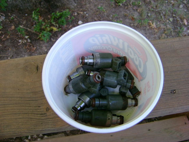

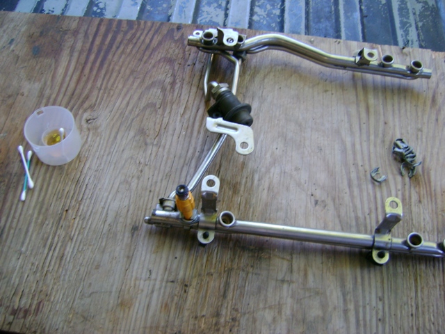

Finished up installing the new injectors this morning. I went to NAPA to get a new EGR gasket to have all of that finished before installing the rails and injectors.
Going on the rails.

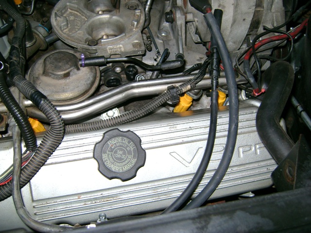

Back on the engine:

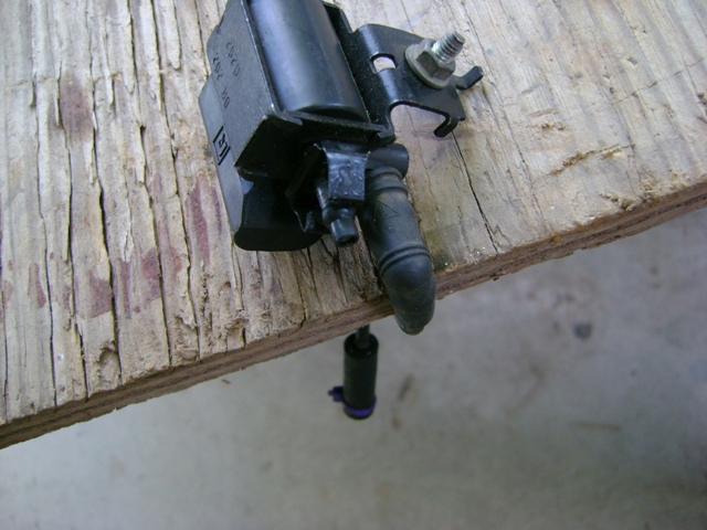

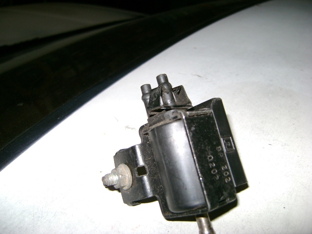

Here is a shot of the EGR solenoid, There are two outs for plugging the EGR. One has the metal retainer , and the other doesn't. I forgot which one is supposed to connect to the EGR.
Anybody know if it makes any difference , and do I need to block the other one off or something?
I gotta say that my miss is gone and this engine runs fantastic. The car idles a few hundred RPM higher than it used to. The exhaust smell is different also. That was the fisrt thing I noticed after I started it up in the garage. I took it for a quick 2 mile trip in the neighborhood. It's like it has a V8 in it now, and not just a V6. The difference is amazing.

I started going threw my old photos I had posted in this thread, and found this one. It told me most of what I needed to know. I am still not sure what the second nipple is for.
Fieroseverywhere AUG 10, 09:51 AM
I think the second one is for cruise. Can't remember now. I use the same one for EGR and have the second one capped. Be sure to use a silicone cap. Rubber didn't last long for me.

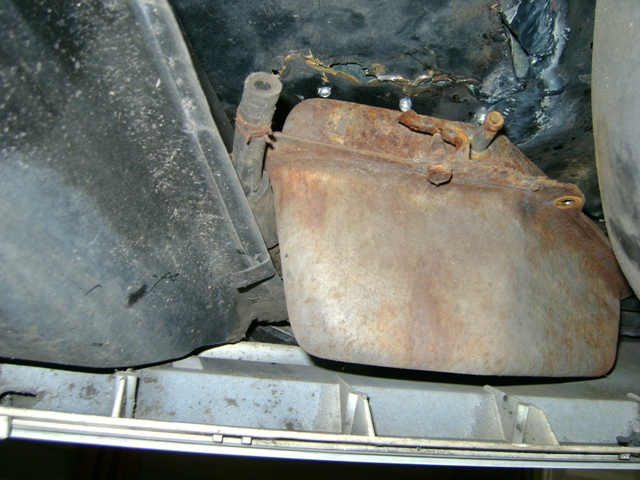

I removed the passenger side rocker moulding and quarter panel this morning. I was trying to get access to the expansion tank. I can't see any mounting bolts. I am thinking that I am gonna have to remove the rear section to replace this tank. I wanted to hook it back up to the car. It's just wasting space the way it is now. That would also be a good time to repaint the rear roof section.
I removed the driver side quarter panel .
Gonna repaint the two quarter panels before putting them back on the car.
