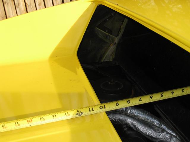

The Pantera opening over the engine compartment sets @ 10" back from the rear window, and I assume functions the same as the stock Fiero ventelation set up. I've never done tuft tests to see whats going on when driving. Might be interesting. It does seem to allow the "chimney effect" to work quite well when just setting still.

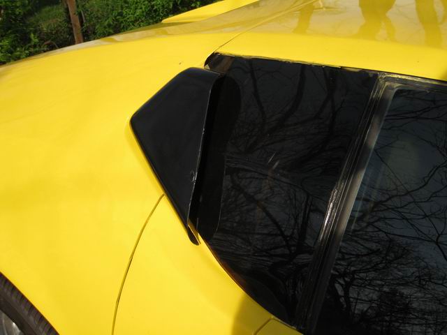

Not a real good pic, but this Pantera is equipped with small scoops where the stock Pantera has "gills". I'm sure they at least contribute to air turbulance when on the road. Looks like tuft tests are due.

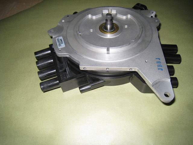

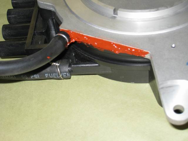

To get things started, I had to replace the evil optispark on the LT1.

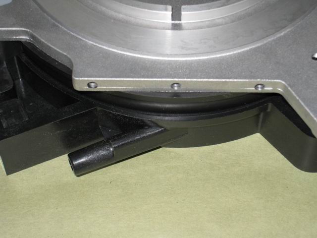

Mine is a '94, and so is blessed with the pin driven unvented optispark. Here you can see three small weep holes at the base. Also, unexpectedly, my ebay replacement came with one of the two required vent fittings, seen just below the weep holes...
So....
I plugged two of the weep holes and fitted a vacum line in the third hole. We will see.

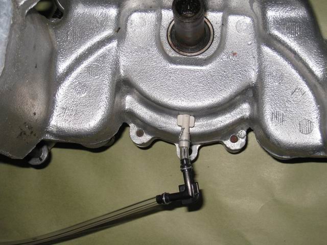

Whenever you hear an LT1 owner talking about replacing their optispark, they usually have nothing good to say about the water pump. It is located just above the optispark and of course it also has a weep hole. GM, what can I say?
Anyhow, I tried a similar fix here as well...
Just for clarification, the clear hose is only a drain hose, no vacum source involved. I used clear tubing because there is such a small amount that actually weeps, I wanted to be able to see it. The tubing is routed so that it loops once, again so that I can see any trace of weepage.

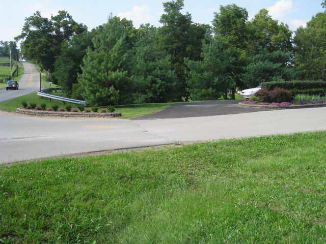

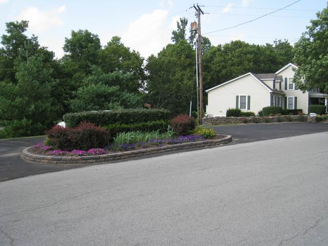

It started with a small retaining wall & shrubbery to keep traffic off the lawn
Then I had to redo the parking lot bed, give it a wall, make it look decent
The roses were Mother's Day gift, guess I over inspired ms Patty
I had to edge everything, and mulch it, still need 4 more truck loads of mulch

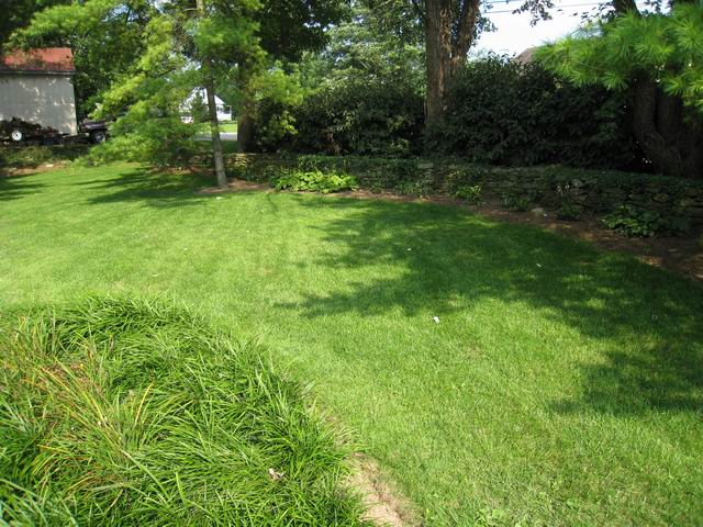

I took up the slate sidewalk and relaid it to "high heel" standards, for guests, I reckon
