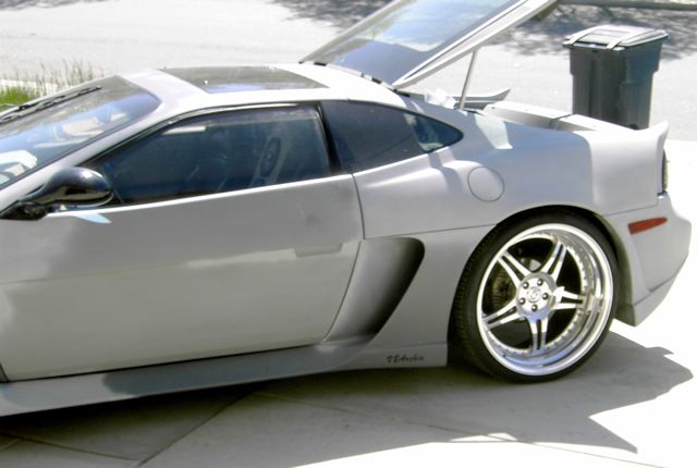

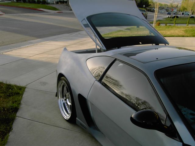

Dean it's probably too late to incorporate this, but one thing madcurl had Archie do that really stands out on the widebody kit was add some hips.
It almost looks like a little shelf on top of the rear fender caps, but it looks like it just involved moving the rear pillars inward ?
Really sets the body kit off and gives it an even more muscular supercar appearance IMO.[This message has been edited by exoticse (edited 05-17-2009).]

Tony, I had noticed the hips on Curly's and CarLo's cars I like them but to do them to my car I would have to redo the intire rear of my car and I have done that way too many times already  I like it the way it is, also with the spoiler I made on the rear it gives it that look from the rear as well. D.
