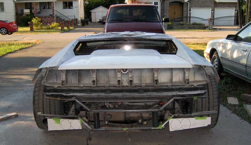

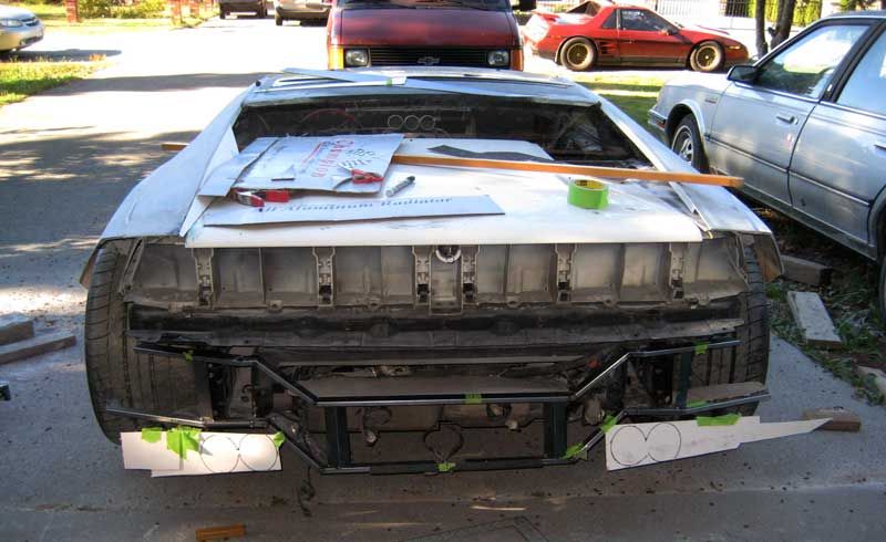

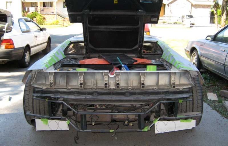

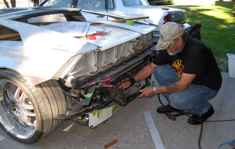

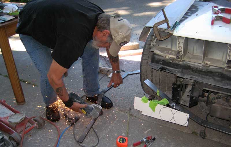

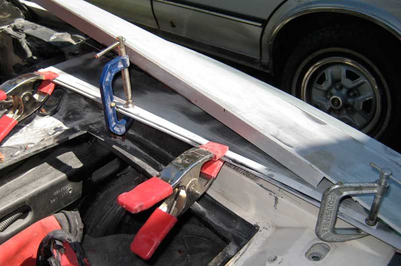

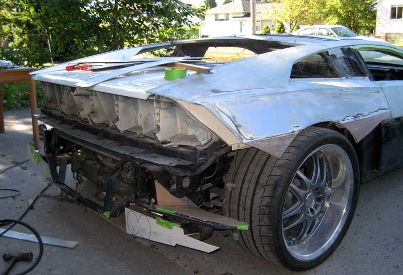

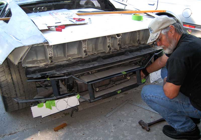

Today Clynt and I started tweaking rear wings again, working around without altering existing exhaust system (that budget thing)
just moving exhaust tips in board, mocking up again...
Tweaking
Wings look like ZZ Top logo
[This message has been edited by Car-Lo (edited 08-16-2012).]

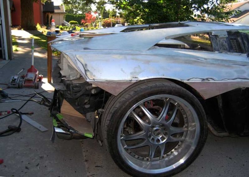

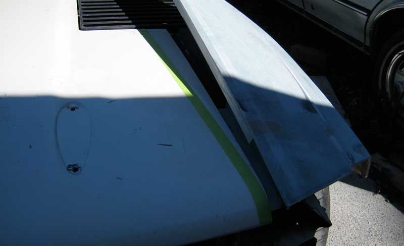

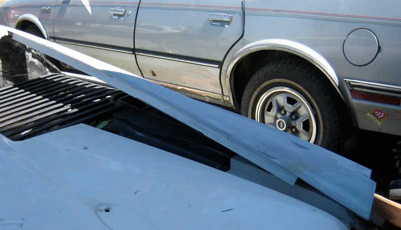

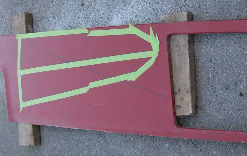

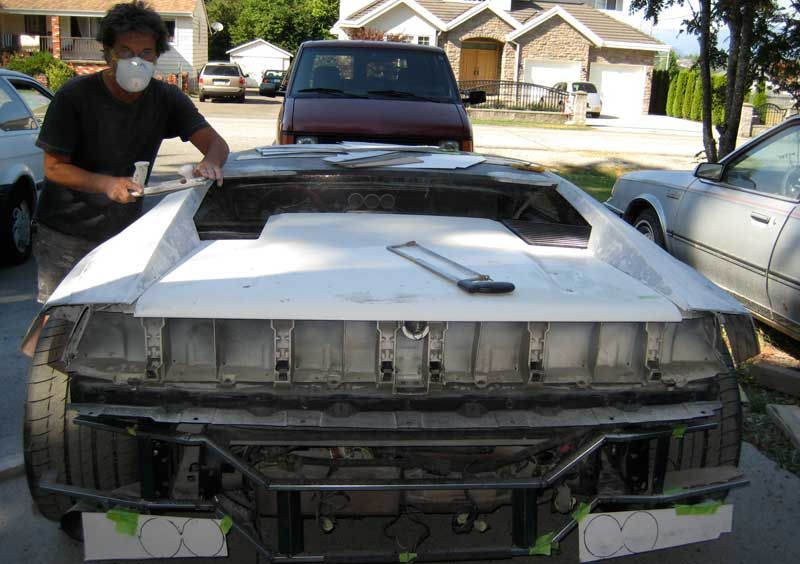

Today's playing...
Taped mark to trim deck lid
Trimmed

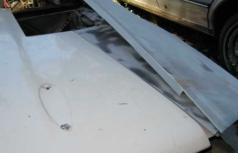

Taped pieces to cut from hood scrap

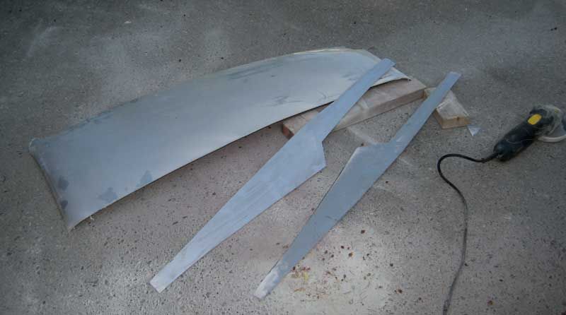

Pieces cut, sanded and Pliogrip on
Pliogrip back stop
Then cut out pieces from roof scrap
Pliogrip on pillars
Sanding flush to pillars
[This message has been edited by Car-Lo (edited 08-17-2012).]
