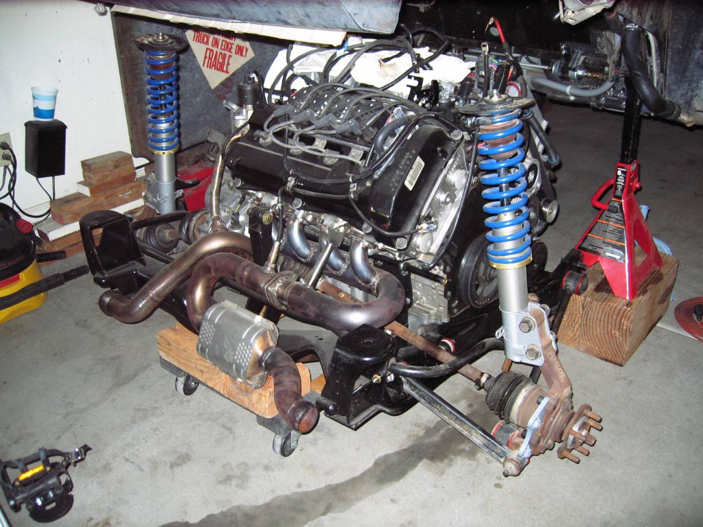

cptsnoopy
APR 10, 03:49 AM
Finally got something done. Bad engine removed:
IXSLR8
APR 11, 01:50 AM
So your not using any muffler and just using a cat on each bank? So, how loud is it?
I've got a 80 series flowmaster on my N* and thought it was a bit loud. I think I'm going to find some short muffler tips.
