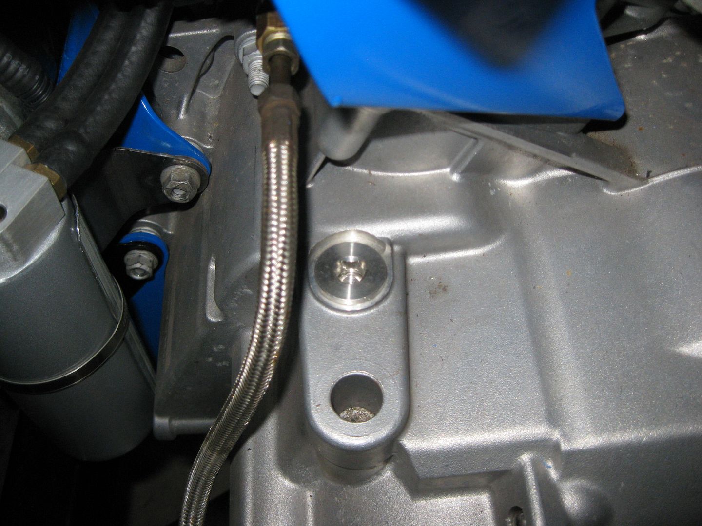

fieroguru NOV 14, 06:19 PM
Confirmed... O2 sensor plugs work great for the fluid fill cap on the F40. I will probably put an o-ring on it to help ensure a leak free seal.

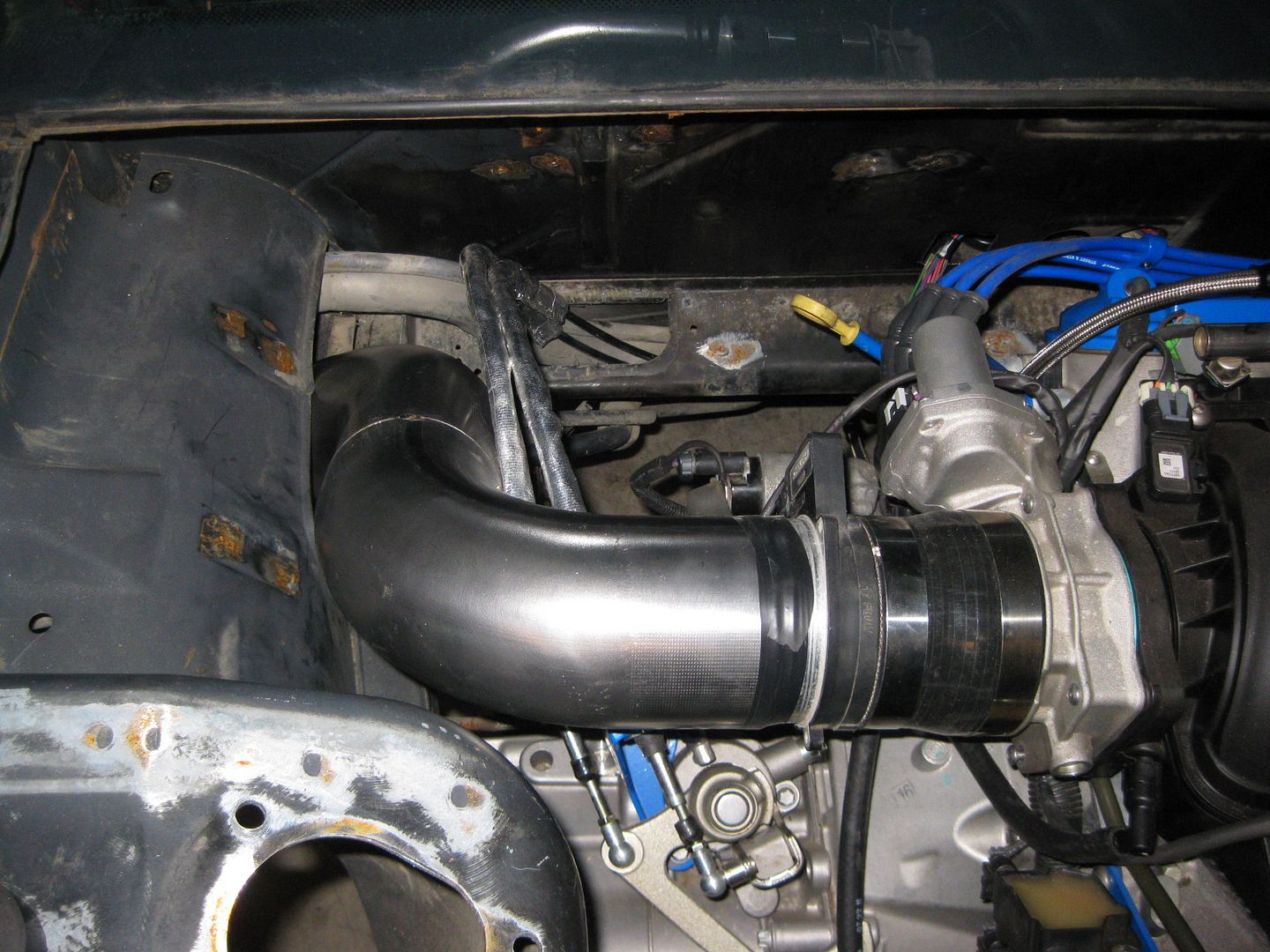

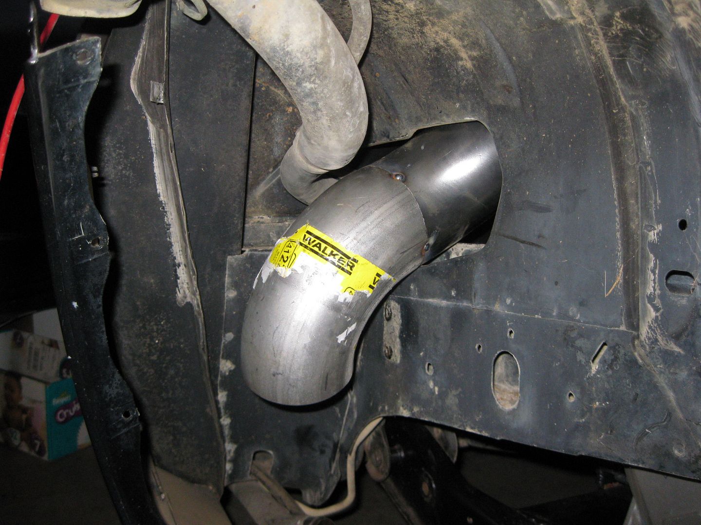

The 4" exhaust pipe sections for the cold air intake showed up as well:
Not the filter I will be using, but it was handy:
Now I just need to finish welding it up.

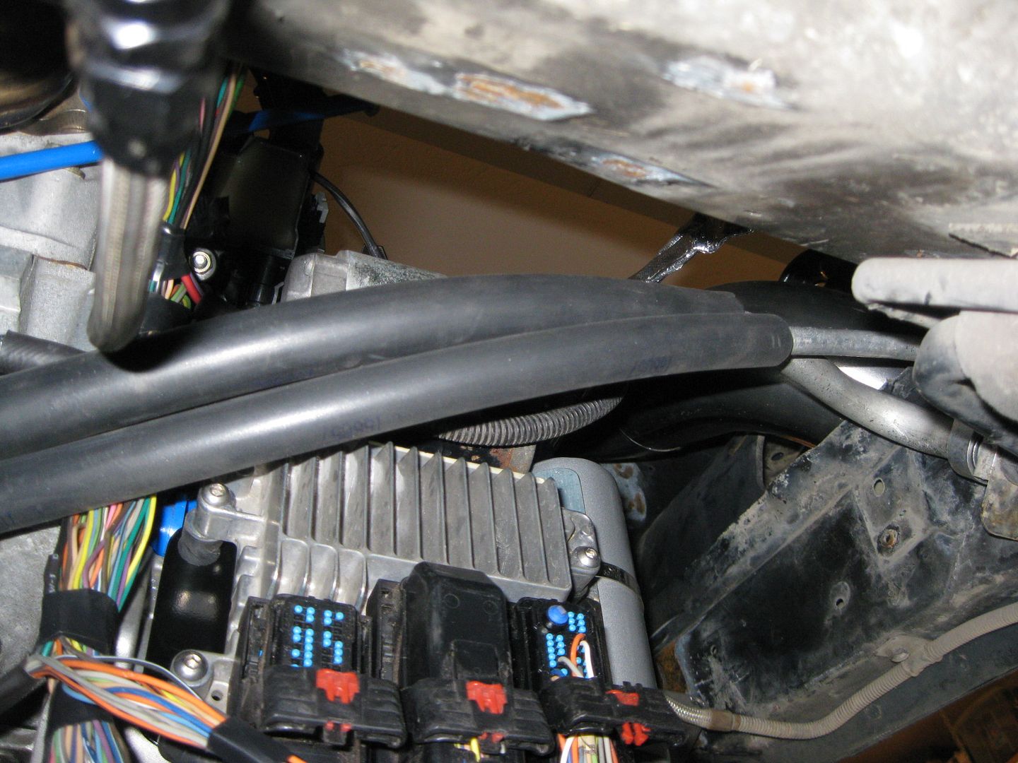

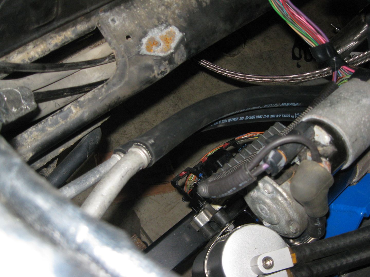

Been working on the AC lines...
I used a cut off wheel to remove the oem crimped hose clamps from the LS4 compressor end as well as the Fiero chassis aluminum hose ends. Then It was a matter of cutting the new A/C barrier hose to the proper length. Here are some pictures of the test fit:

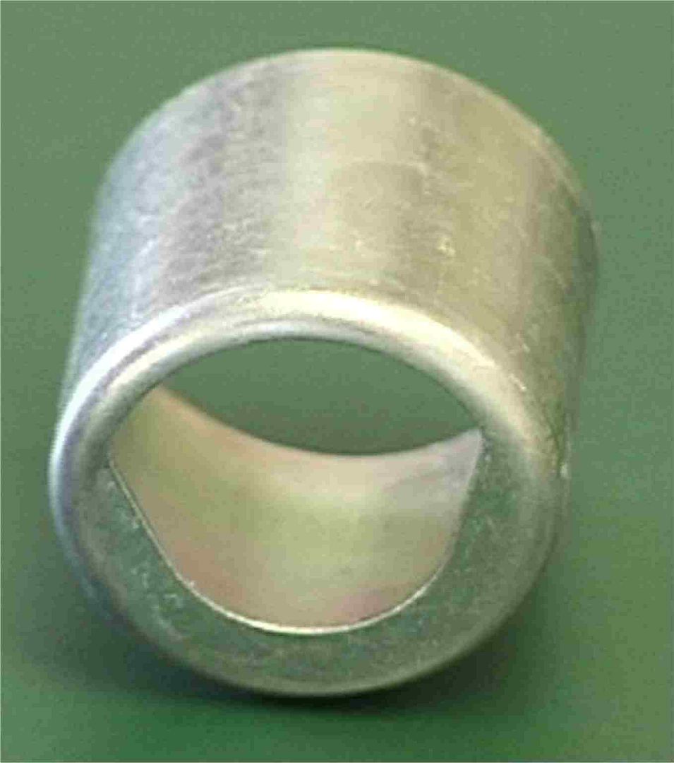

While searching for the ferrules for the ends I came across several types for the OEM bead lock (the ferrule is locked between two beads on the fitting) fittings. Most of them required a larrger hole in the ferrule so you could push the ferrule past the beads and use a c-clip to retain it. I am sure those would work, but I also found some that had the larger hole offset:
http://www.mobileacproducts.com/ferrules.asp
So these just slide into place, fit in-between the beads, then when centered by the hose they are locked into place. Pretty slick setup, so that is what I am going with. You can buy the ferrules in packs of 25 for each size and they come to about $1 per ferrule. So I am buying 25 of the #8 and #10 and will likely sell the left overs in the mall.
Here is a nice how-to on using these ferrules. It covers removing the old hose and assembling the new one with these ferrules:
http://www.mobileacproducts.com/hose_repair.asp
For crimping these, I am planning to just take the assembled hose with new ferrules to NAPA and have them crimp them for me. The other option is to buy a crimping tool... but they are about $150 for the cheapest one and I don't build A/C lines very often. One of the most compact crimpers I have found is the ATCO 3300 Handi-Clamp:
You can buy the whole tool with the dies for $155 from here:
http://tswf.com/koolkarzonline/tools.cfm
Or you can buy just the 2 needed dies (#8 and #10) and use a large bench vice to compress them. The dies are only $20 each from here:
http://www.atcomail.com/forsale/3300parts.htm

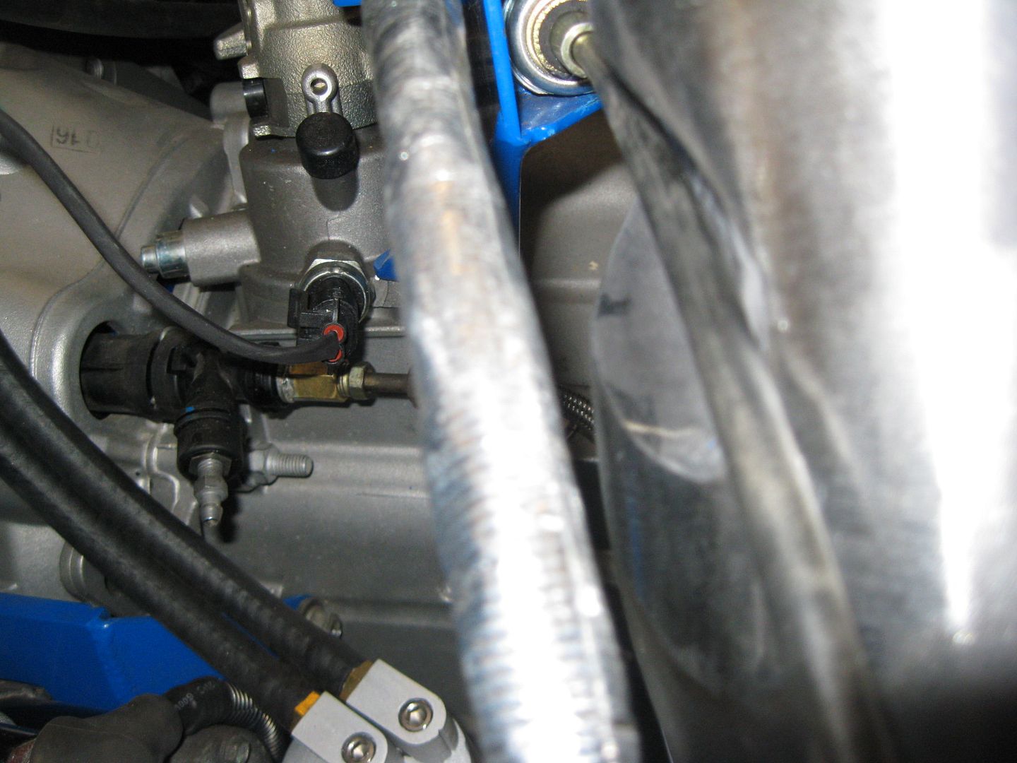

fieroguru NOV 17, 12:48 PM

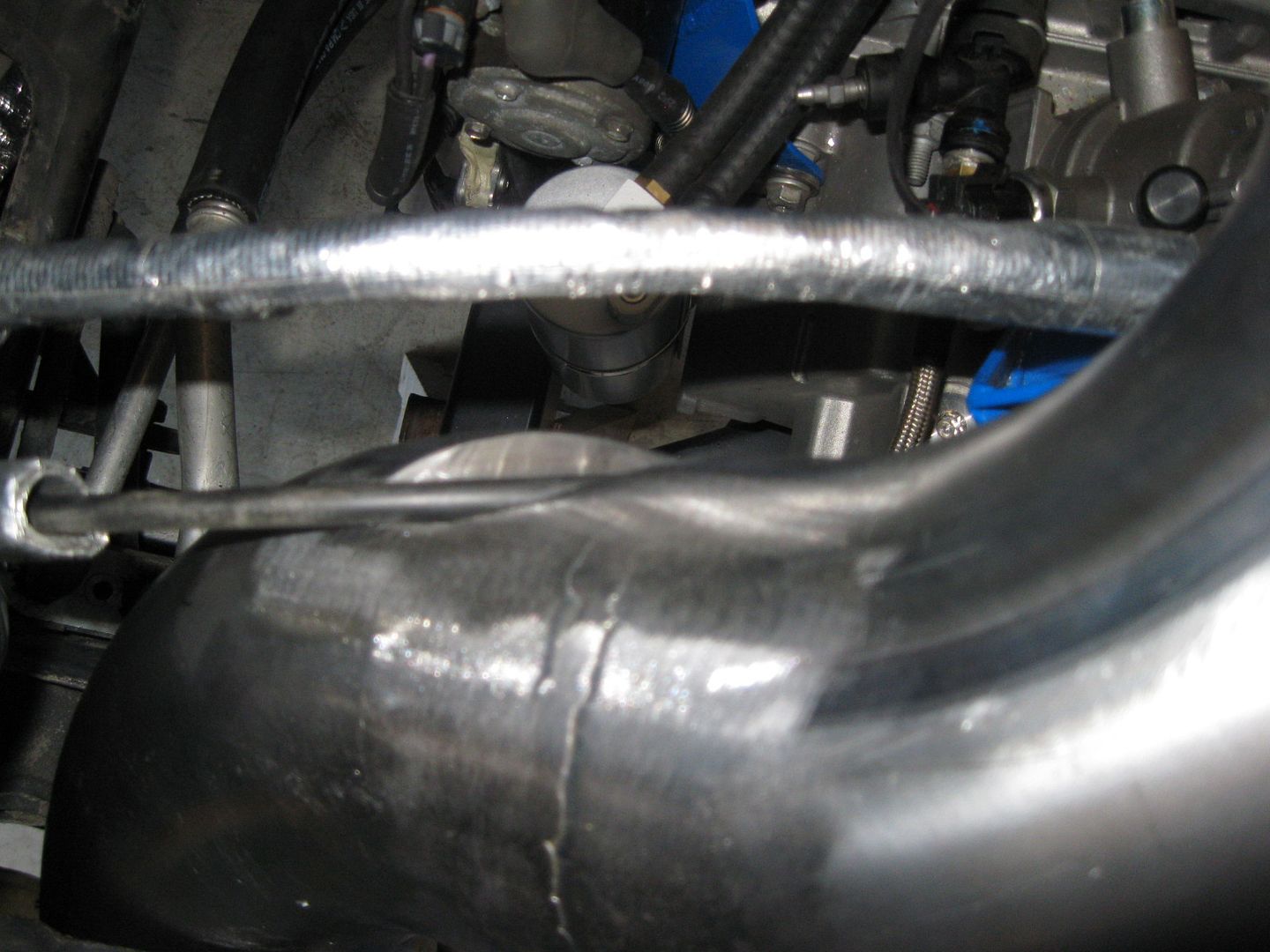

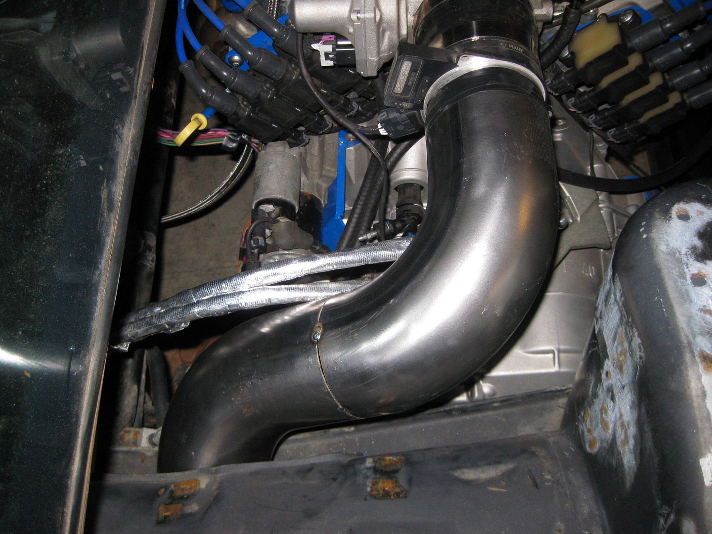

The cold air intake is pretty much done. Just need to sand it down and paint it.
I ended up putting a small notch in the air intake to avoid bending the shifter cables:
