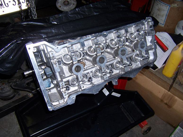

Cylinder head bolted down with no valvetrain:
Valvetrain assembled. How many different applications are in this picture? I have a Crane moly-disulfide lube on the intake cam, Comp white lithium lube on the exhaust cam, Clevite bearing guard in the cam journals and lifter bores, ARP moly assembly lube on the upper head stud threads and under the nuts and blue Loctite (or rather the Permatex equivalent) on the bottom threads of the head studs
