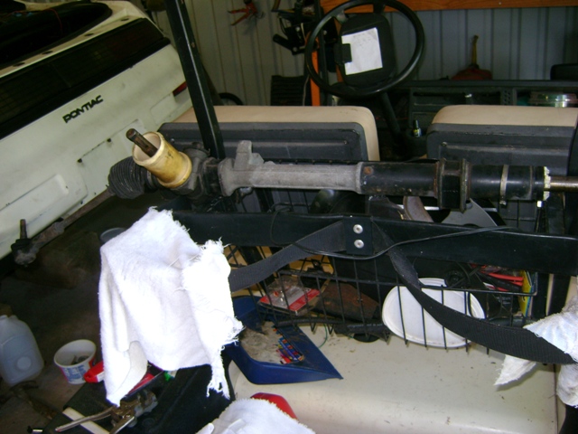

Removed the rack from the car this morning. It was a piece of cake. Removed the two mounting bolts I had left in place. Loosened and opened the coupler and moved the rack forward to un couple. Removed the brake line fastener that lives under neath the brake master cylinder. I had some slack in the lines. Removed the one brake line fastener on the passenger side. Mover the rack to the passenger side to get the outer tie rod clear, raised it upwards . Then just lifted it out on the driver side. About 10 minuets total. I used a small hammer to re seat the plastic bushing. Wish I hadn't. Now it is seated in there and I'll have to play with it to get it out of there.

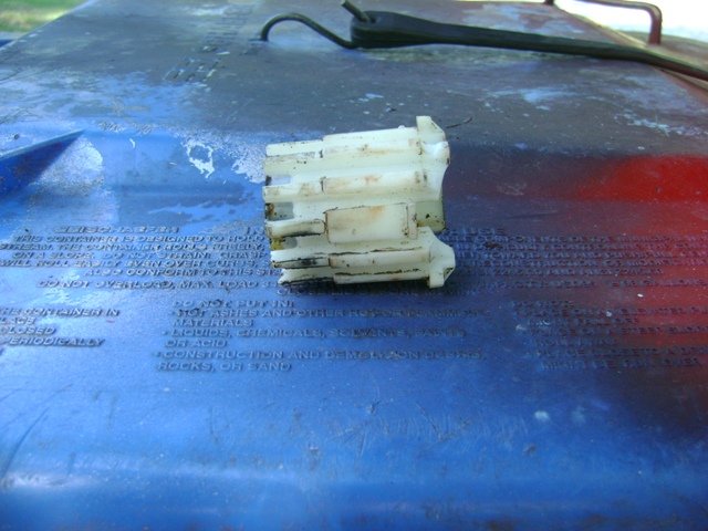

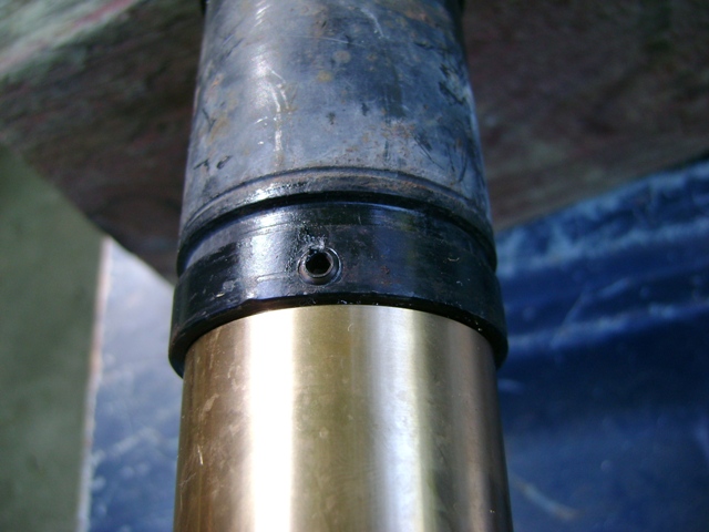

Used three small flat blade screw drivers to lift the locking tabs on the old rack bushing. I got it out enough to drive it out of the tube.

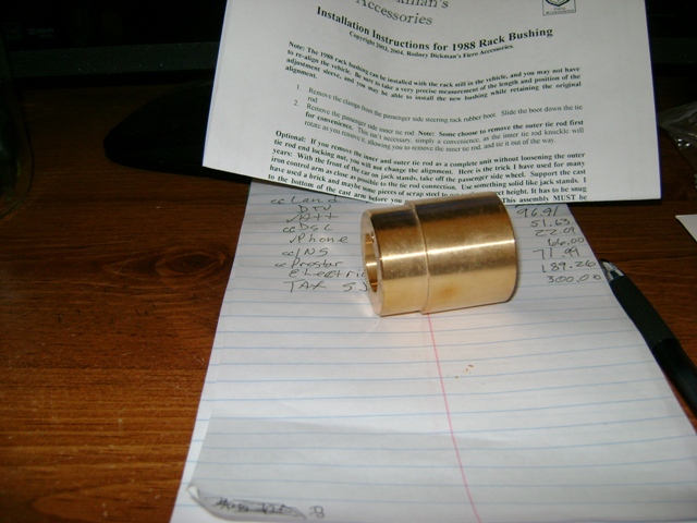

Ordered the bushing from Rodney Dickman this afternoon
Bushing shipped Wednesday morning.

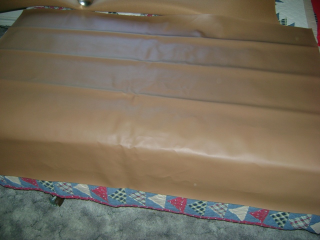

I got a 4 foot piece of beechwood headliner fabric, 3 foot of the same color vinyl as my seats, and a can of 3M Super Trim Adhesive. The 3M stuff is $20.00 a can now. I am gonna cover the firewall cover I got from MstangsBware on the end of June. It is in real good shape, just dirty and nasty looking.
and

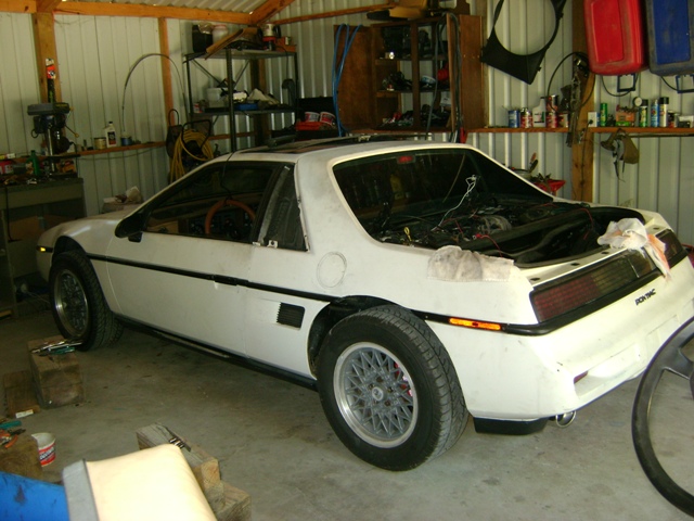

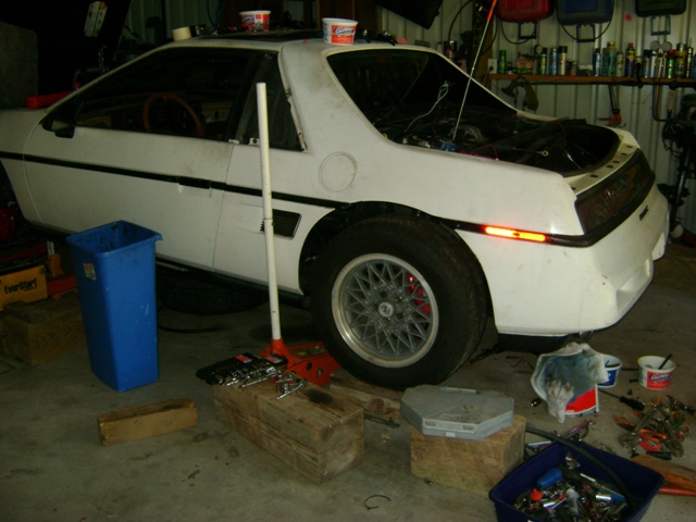

I put the rear wheels on the car this morning. Looks more like a car now than a swap in progress.
After installing the vinyl on the firewall cover I am not happy with the 'Plastic' look, and have trashed it in the can. I prefer the one in the car now.

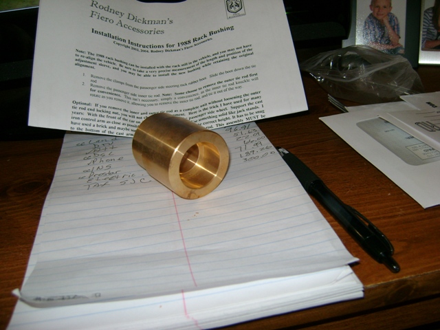

Got this in today's mail:
and
Nice instructions, and appears to be well made. I will photograph the install and post them up for prosperity. I am gonna try to do this Sunday morning.

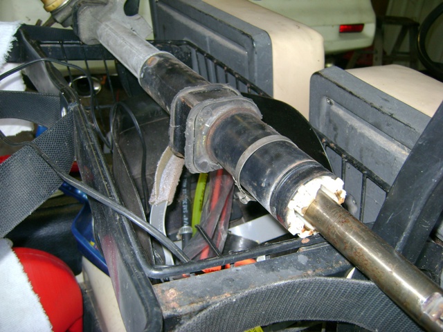

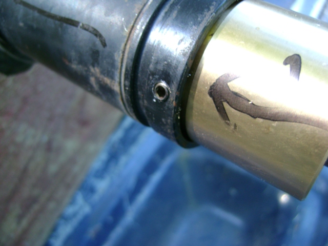

I installed the rack bushing this morning. At first I used a 10-24 Allen head screw to hold it in the rack tube. But ran into a fit trying to get the bellows boot over the heads
Old one out
and

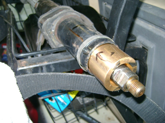

drilled the first hole and threaded the hole. Installed the first Allen screw.
Removed the Allen screws and installed two Allen set screws until flush with the outside of the tube.
other side too
I am out of Loctite, and will have to get some and use it before staking these. I want to install the rack back in the car in the AM
This rack issue was just a pain in the rear end, but wasn't hard to do as Fiero repairs go at times.

All four on the ground.
