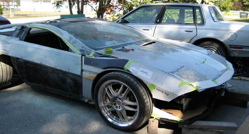

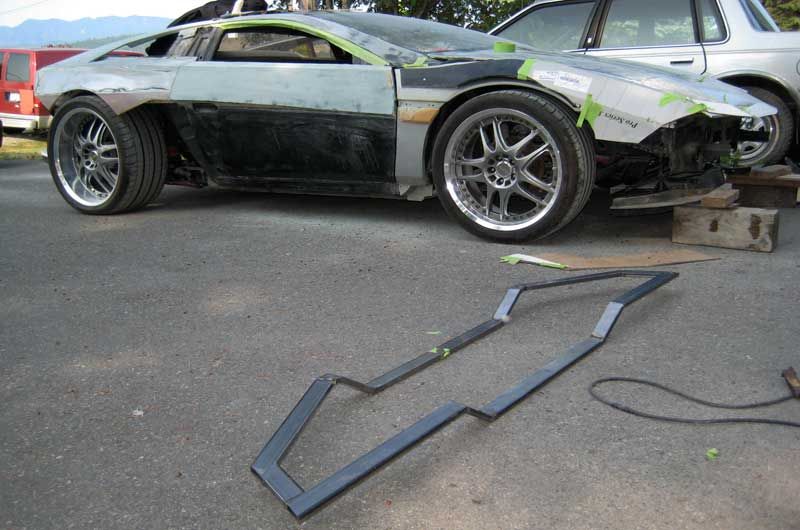

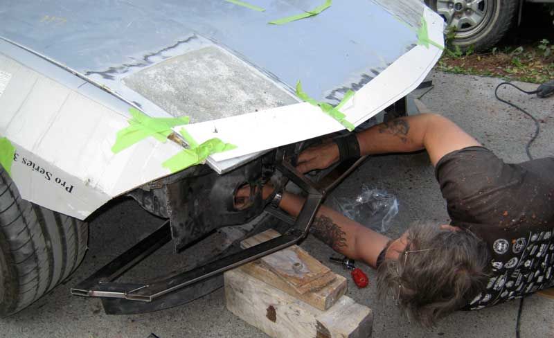

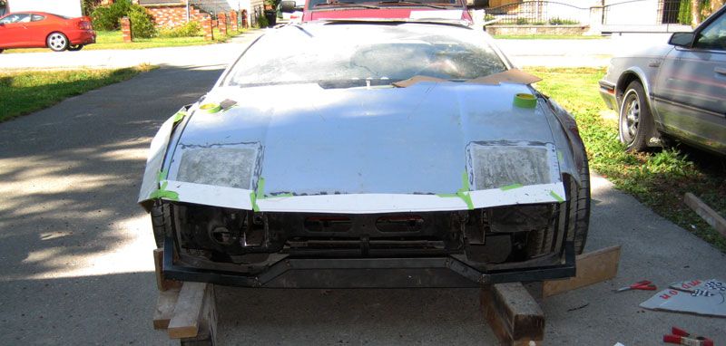

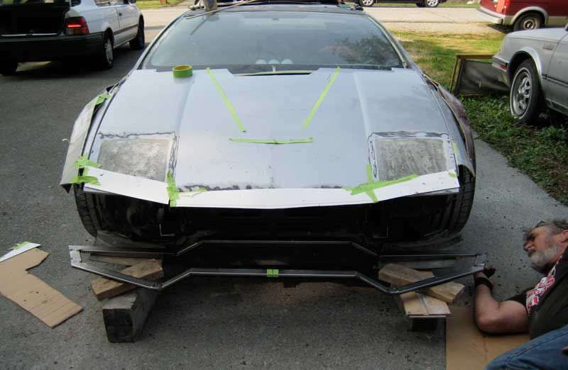

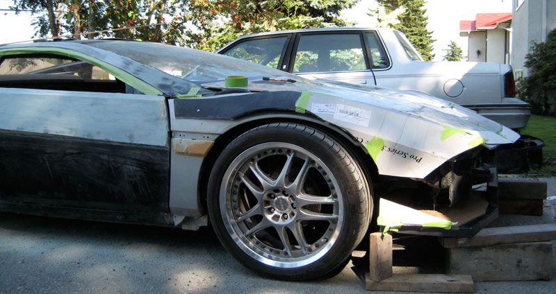

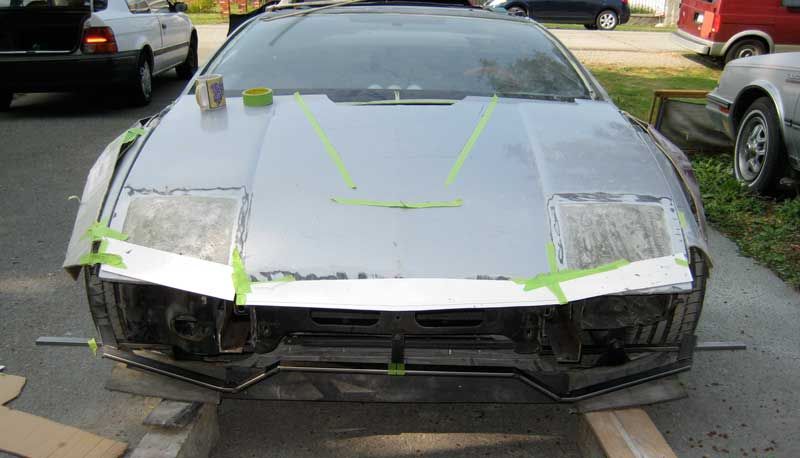

We had lots of thin wall angle iron perfect for rough mocking up wing, Clynt starting to play with size and shape...
It's a start and lots of tweaking yet
Tomorrow Clynt and I are going shopping for proper iron material to fabricate frames, front and rear wings

If I can offer one suggestion, make that splitter out of steel or something. If you don't want the entire front splitter from steel at least make the leading edge of it. We are not talking about a bone splitter hardness, but WAY MORE than fiberglass and foam. I remember the 3 of us having a discussion about the front air splitter we made for my nose. Clynt said Steel frame, I was on the fence about it, and you said the fiberglass would be more than hard enough, so we "I" decided that foam and glass would be good enough. Well the first little tap / nudge I made to a concrete parking block and I put a crack in it. I am a bit worried about going for my 150mph run with it. At 70mph it works amazingly well, even being a bubble top Fiero there is a noticeable difference / improvement in airflow over the car. Don't ask me to explain it, cause I can't but the car just feels more planted, and with the top out, windows down there is considerabley less turbulence around the car.
So please take that into consideration when building your lower wing/ air splitter, we have high parking blocks here, and all it would take is Once, Just Once to forget that its there or not see it and pull up too far and CRUNCH.

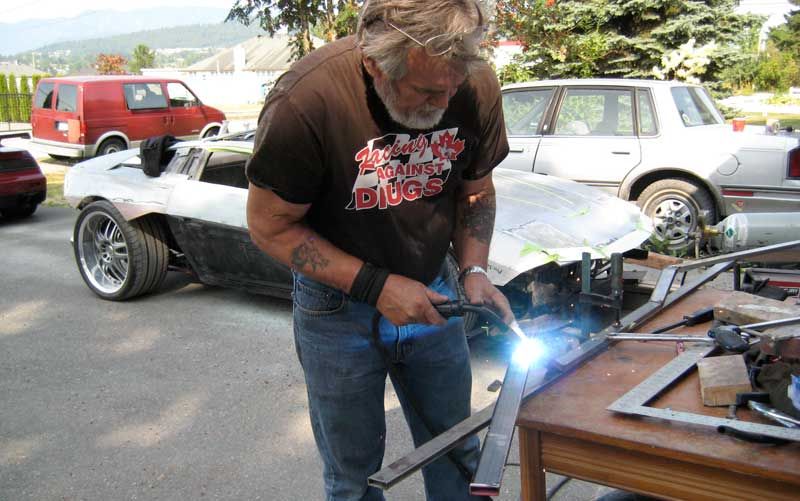

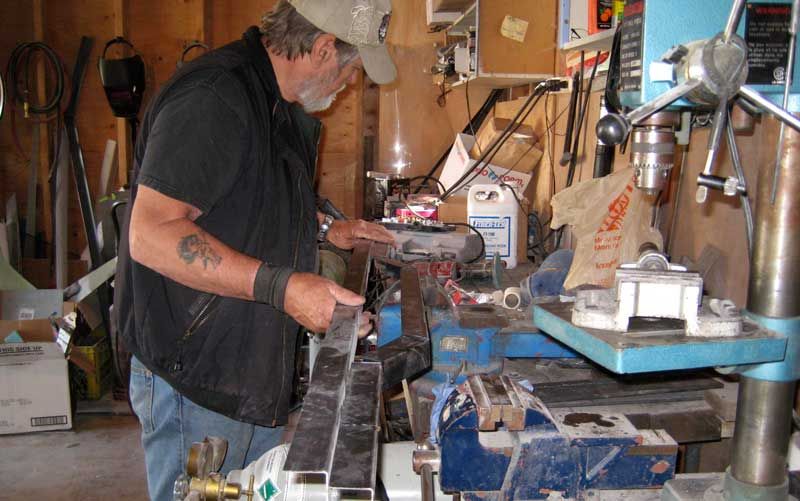

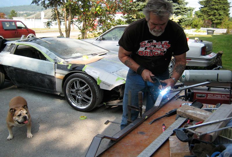

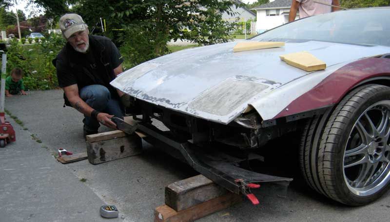

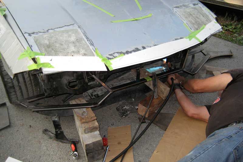

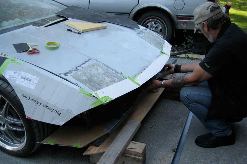

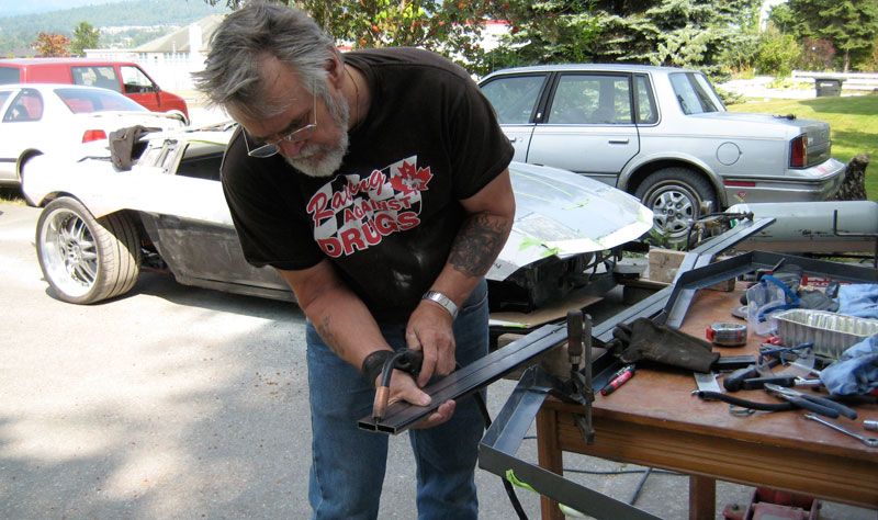

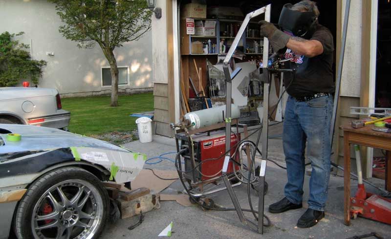

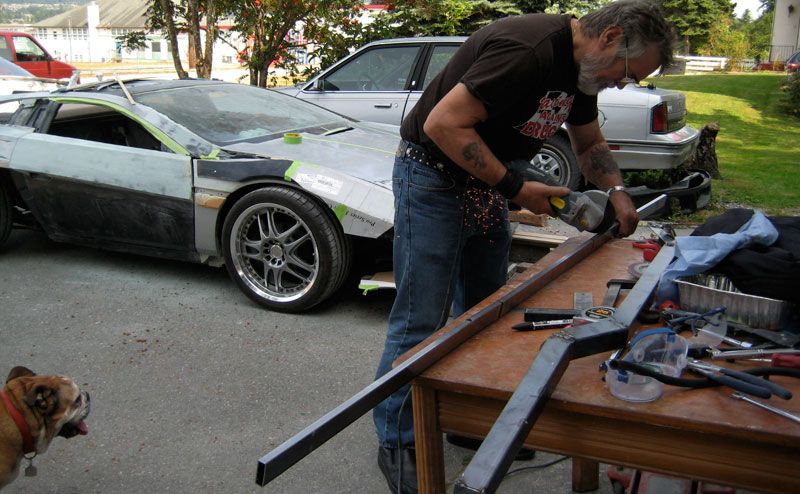

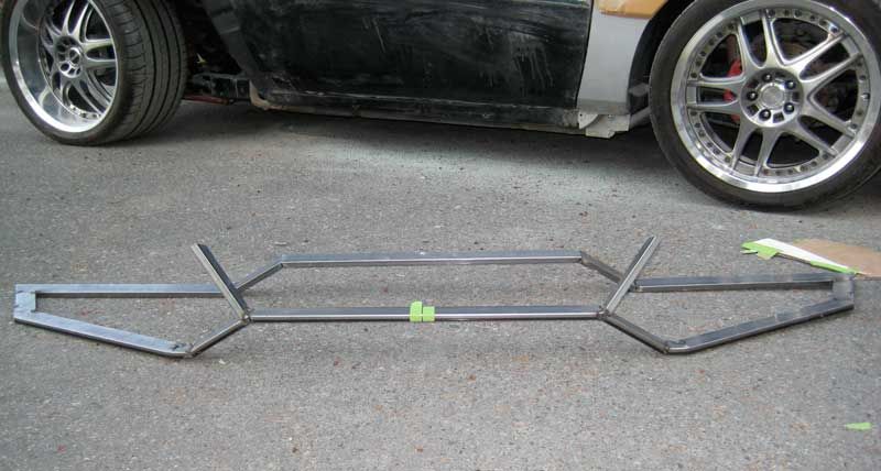

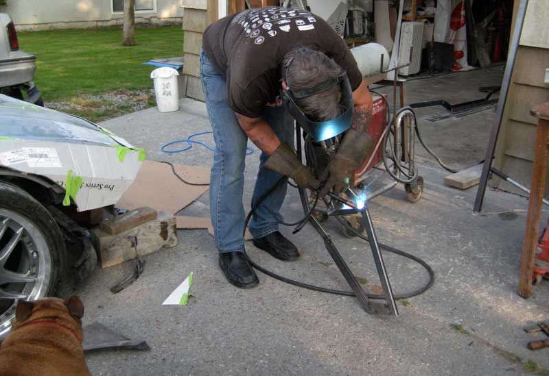

Today Clynt and I went to Metal Supermarket in Langley and got nice rec tube 1.500x .500x.065
and after that stopped to visit Blair at this chocolate shop for a latte.

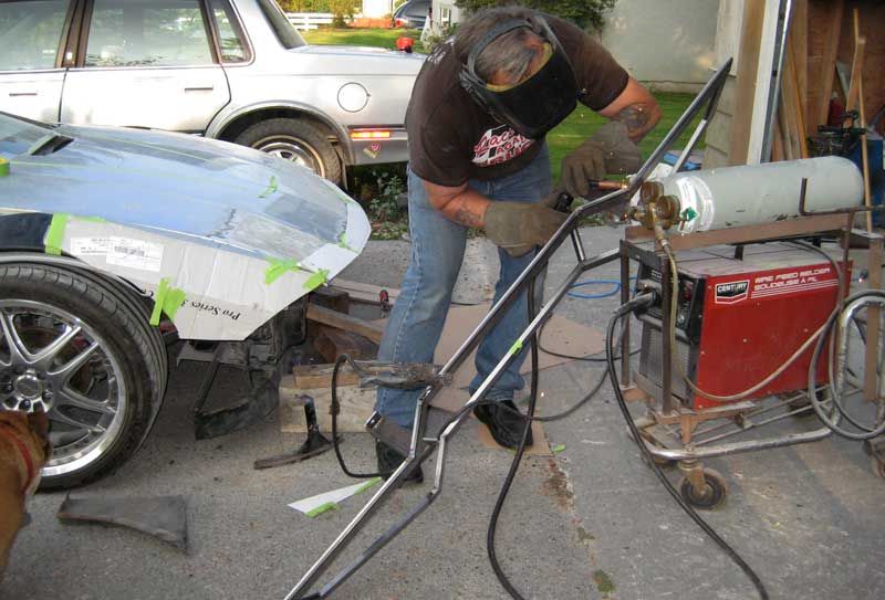

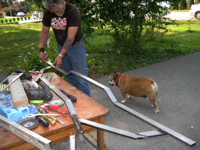

Clynt having fun fabricating front wing frame...
Bolting rear brackets to RBS2 frame (to have wing removable)
Tack weld rear brackets on wing frame
Another good day...
