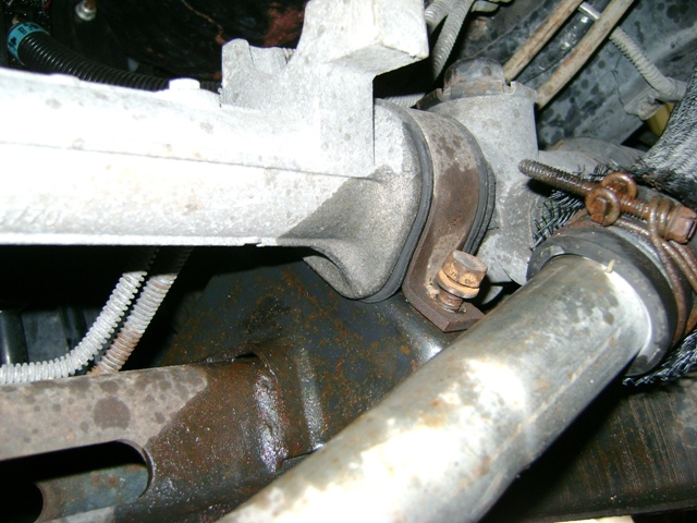

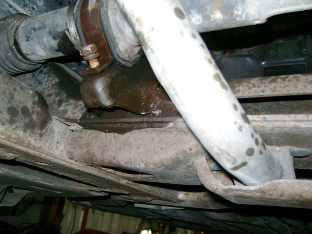

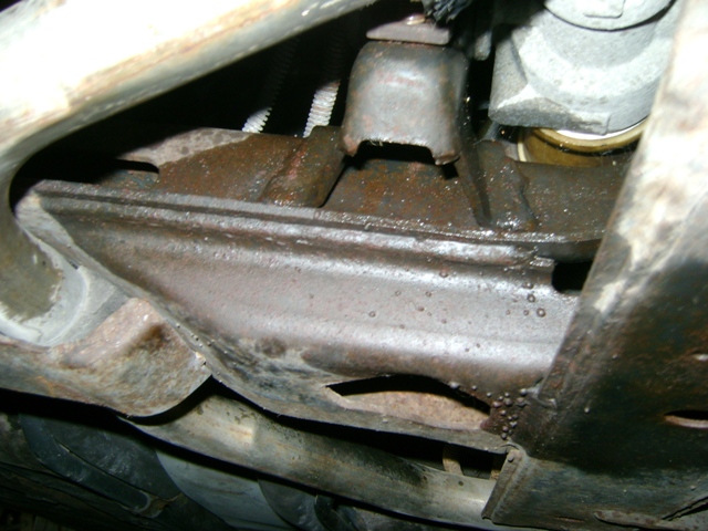

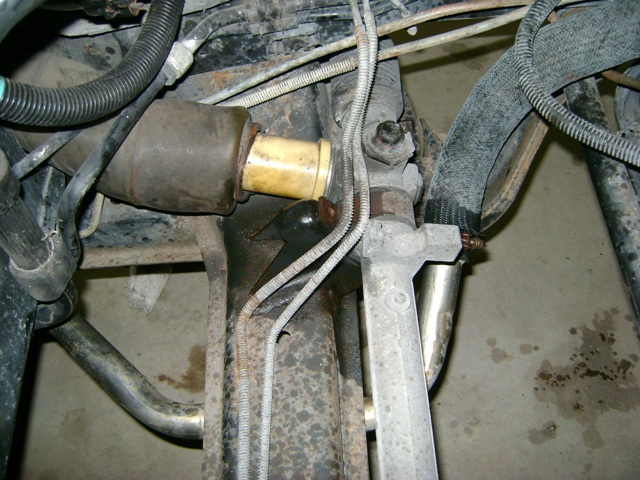

I have to mow in the AM, I want to remove the spare tire tub from the front compartment so I can spray down the rack mounting bolts several times over the weekend with PB Blaster. I want to get the rack out for repair. I will be ordering Rodney's 88 rack bushing Wednesday.

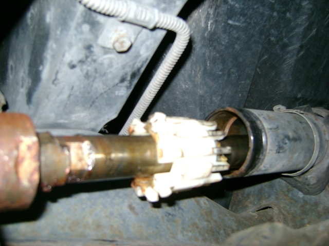

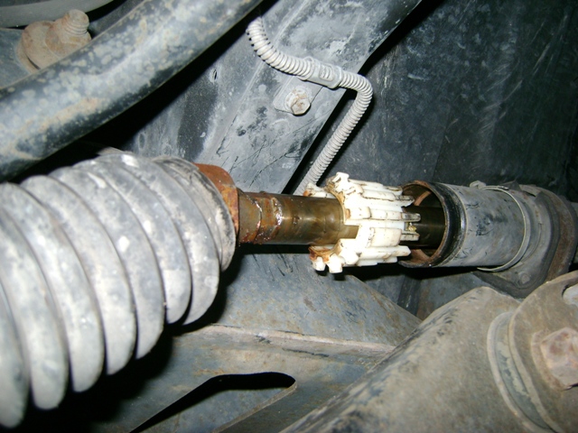

Got finished with supper and went back out to the shop to remove the spare tire tub. After I got it out it appeared that the bolts were totally clean, so I gave them each a good shot of spray, and took a chance. All four loosened up and came out. I put the two lower ones back in the mounts because I have to get the tie rods and steering coupler loose some time in the next two days. I need to get to Autozone and rent their small pitman arm removing tool.
I can not beleive that they all came out so easy. I have had cold sweats thinking about busted off mounting bolts.

I finished mowing , and went out in the shop for a bit. I removed the cotter pins from the tie rod ends and loosened the nut until the top was flush with the top of the stud. Sat a bottle jack underneath the knuckle's arm, then I put a 2 X 4 on top of the nut. I gave it a nice blow with a hammer. Both sides popped loose. One good blow was all it took on either side of the car. I'll fight the coupler in the morning.
Shower time. Through for the day.
