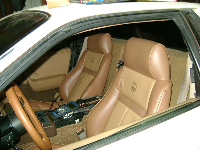

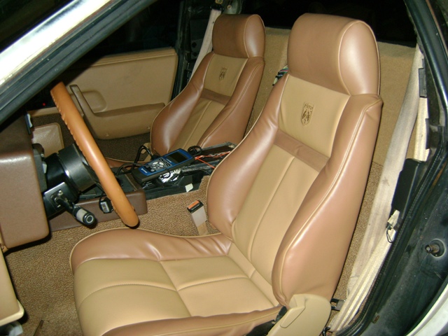

Installed the seats into the car. My grandchildren are coming and I had to get them out of their bedroom. So out into the car they went.
 and
Installed the two rear side marker lights I got in the mail today. I also put new bulbs in to all four of the sockets.
My brake master cylinder and parking brake cable came on the FedEx truck today.
Installed two fine looking Jen-You-Wine Fiero Thomas tan sun visors that arrived in today's mail also.[This message has been edited by josef644 (edited 07-09-2010).]

Man those seats look good Joe. I am going to have to order a set for my Formula.
