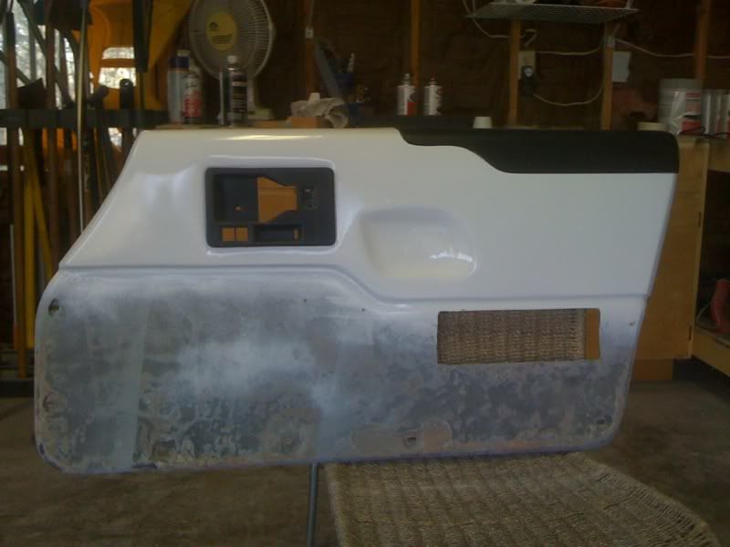

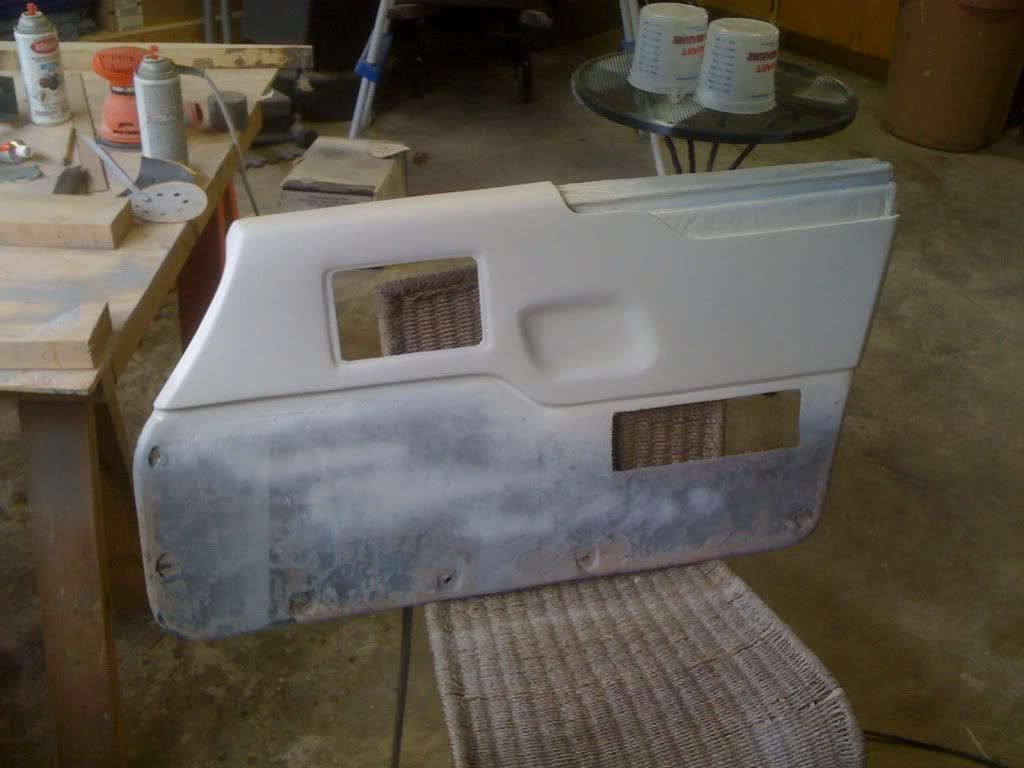

After counterless hours of sanding I finally sprayed the first layer of paint on the door panel
Final sand and primer
First few layers of paint - As you kknow this is the fun part. Paint, wet sand, paint, wet sand, high gloss clear coat, sand etc etc etc... I actually really enjoy this process.

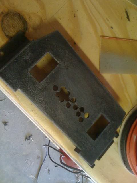

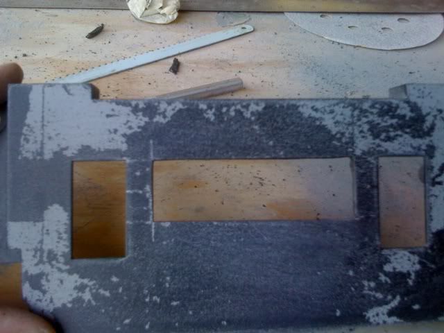

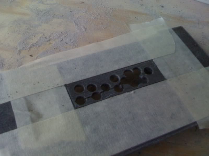

I had an extra window switch plate lying around and decided to cut the hole for the iPod - there's tons of room but I did have to remove one of the bolt holes
Measuring the lines
Drilled a few pilot holes
Taped out the area to cut - I used an X-Acto knife, modeling file and and saw blade and took my time - no need to rush
The process took about an hour from start to finish
Another
I then sprayed with primer & flat black

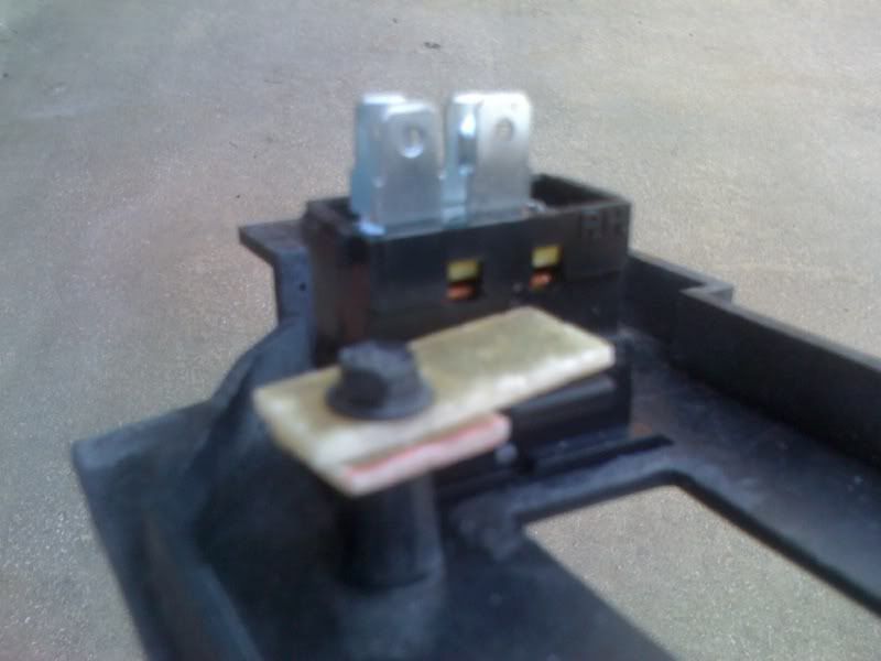

Because I removed one of the bolt holes I quickly fabricated a simple support when the button is pushed
Installed - turned out really nice. All I need now is the iPod docking station and connector to the back of the stereo (but I think I need a new stereo as well... DANG IT - LOL)

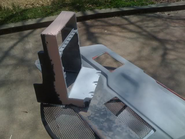

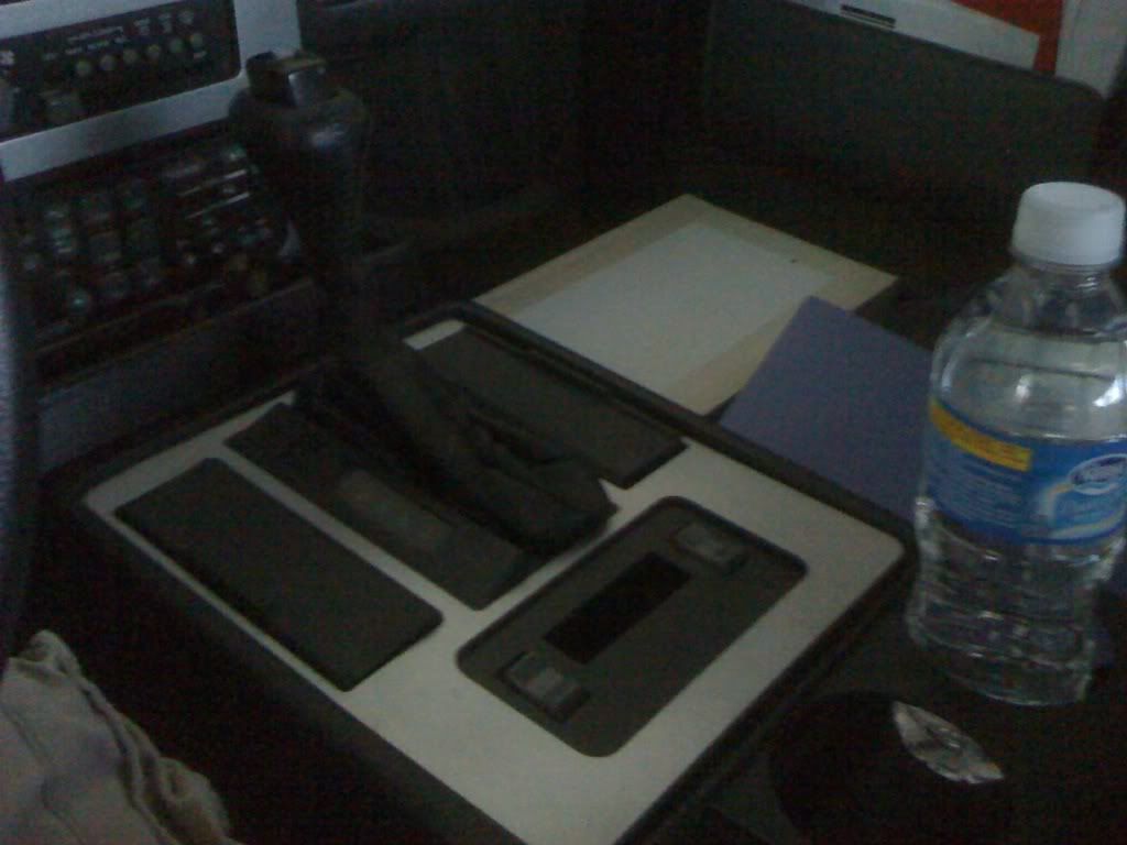

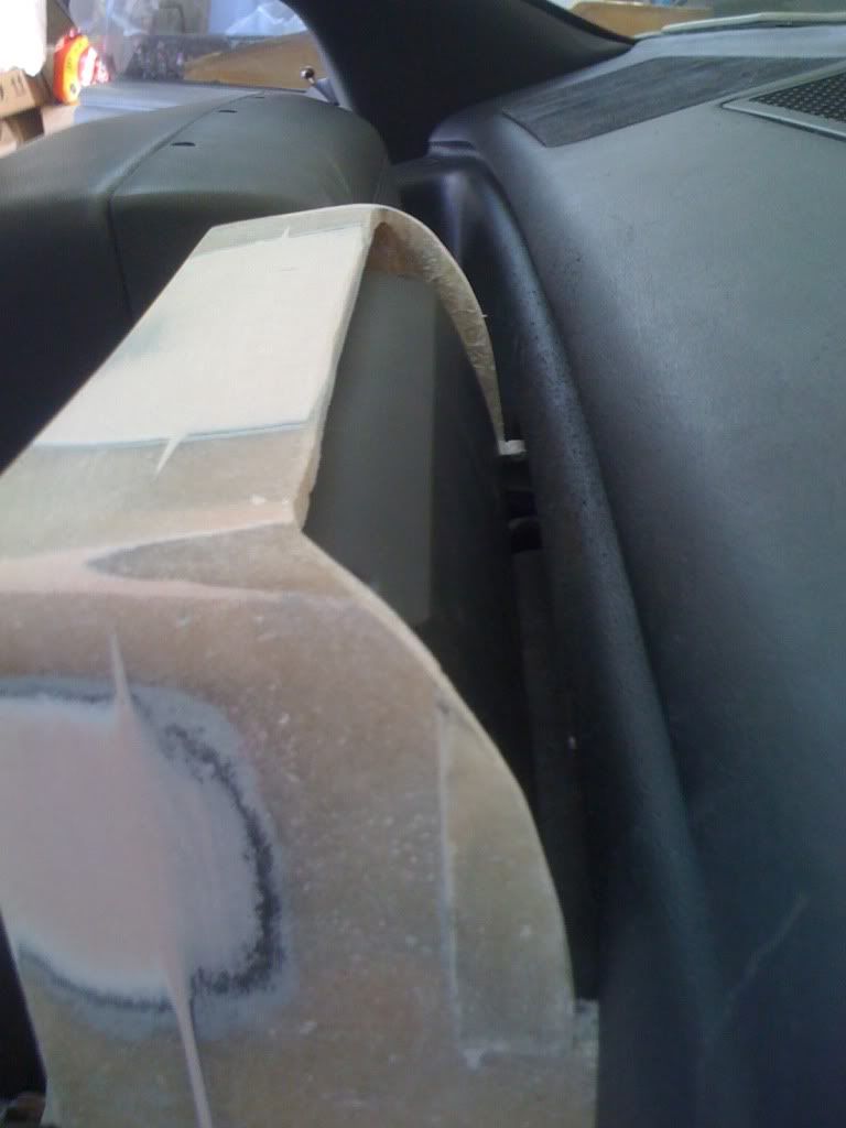

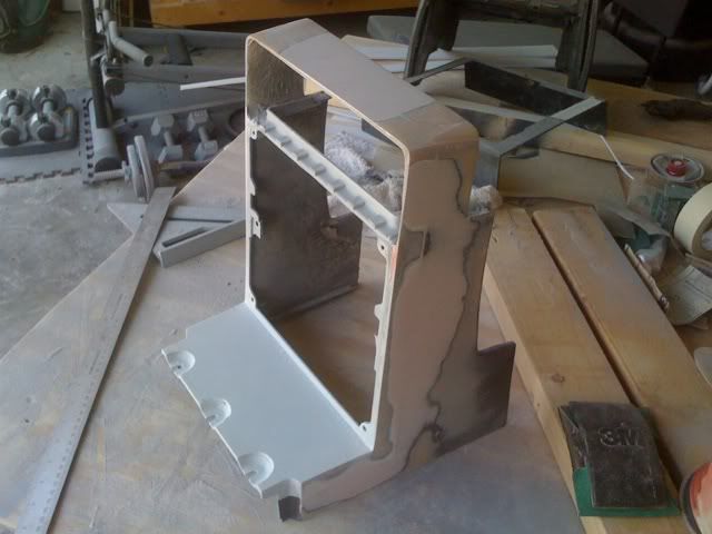

On to the console. I ran into a wall on this project. As you know I have to find a way to cover the gauges up top. The idea was to create a nice rolled cover going down the back side of the console. However, this is impossible to do with the consoles current configuration / design. The horizontal piece of the "stock" console - where the upper gauges mount - is directly in the way when removing / installing the console. So.... I either remove the horizontal part of the structural or I create an entirely NEW piece that actually covers the console - kinda like a lid - GREAT... another lid... LOL
As I said in a previous post, I want to utilize the stock plate covers. However, I run into another problem. The A/C vent surround on the backside of the plate cover will have to be removed in order for me to successfully create a cover that can be removed / installed using the stock mounting hex locations. It's kinda confusing... I'll take more pics tomorrow

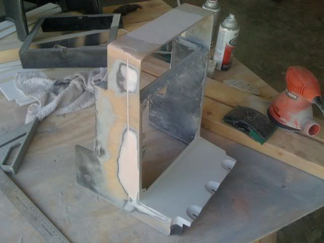

I added lots of filler to the console
Sanded smooth
No more sag in the middile

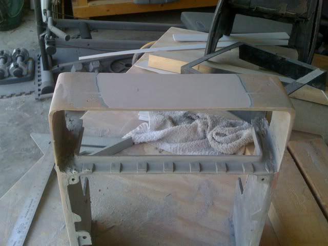

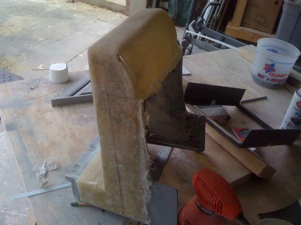

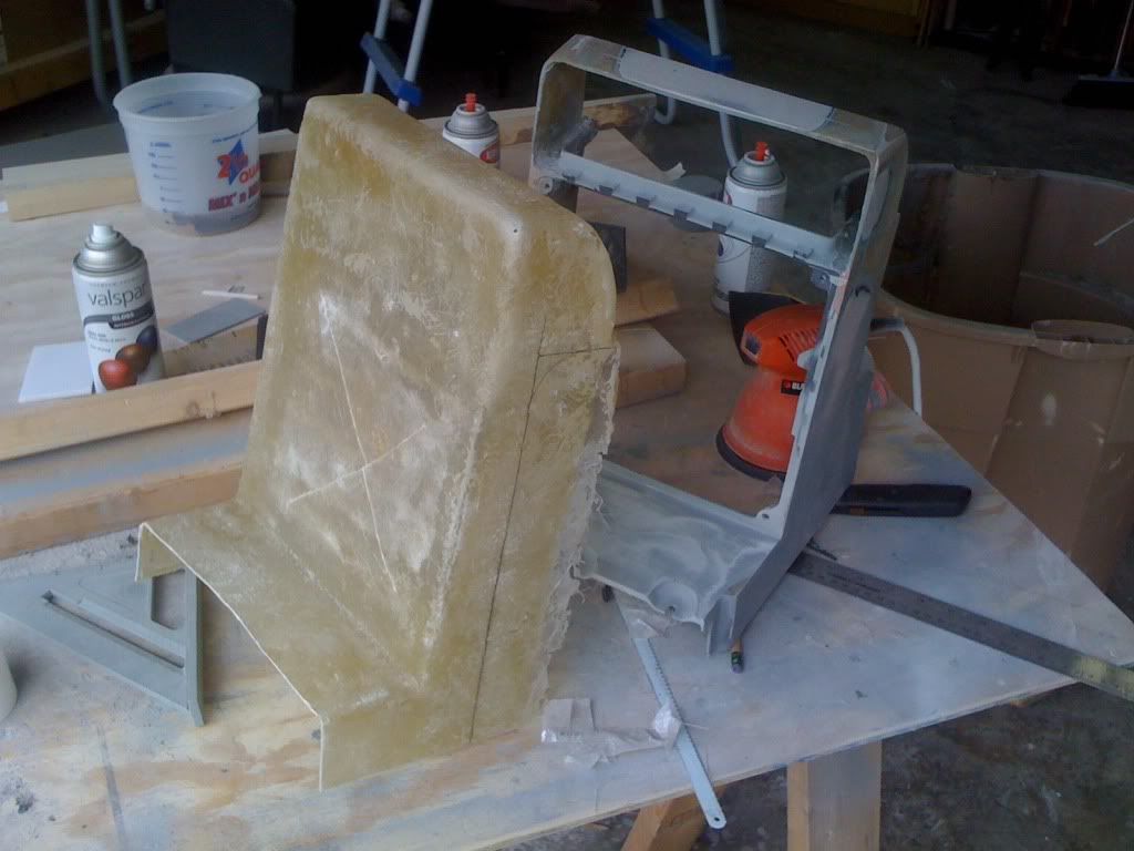

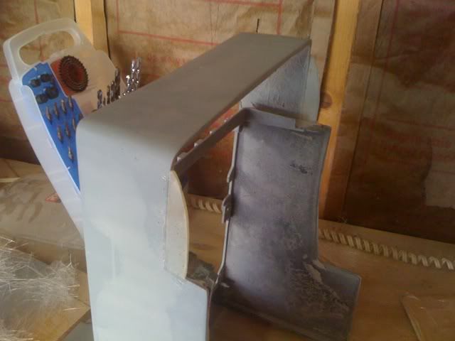

I then began the process of creating the back side of the console

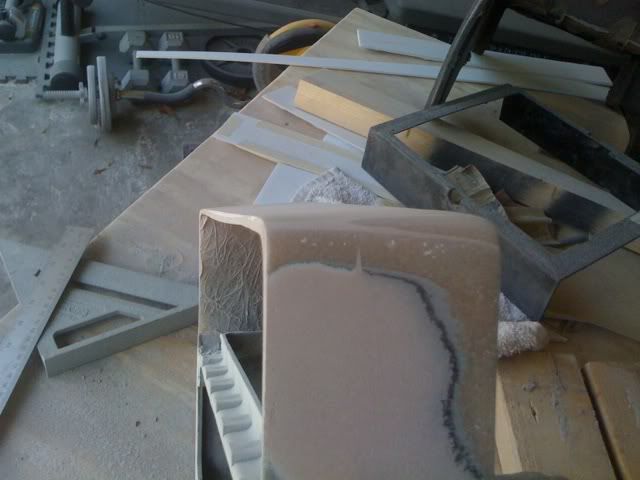

Hot glued them into place
Another

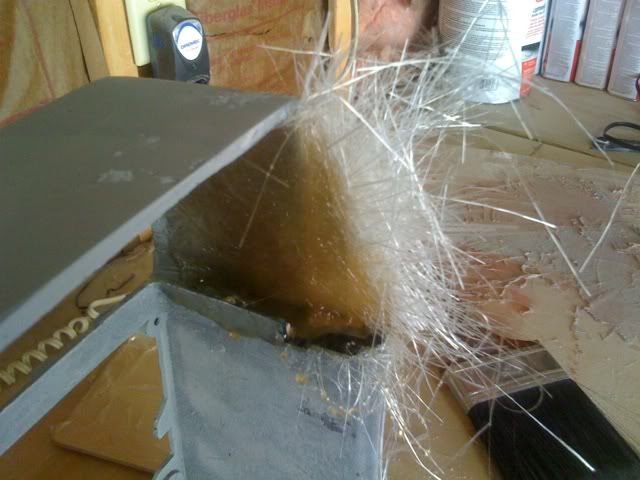

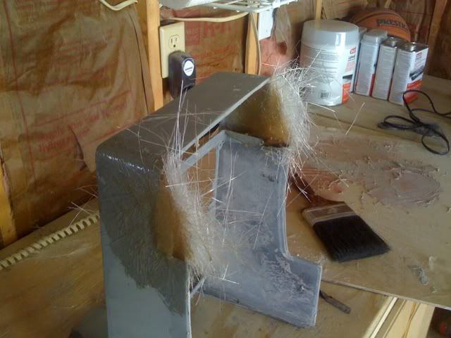

Then added fiberglass for strength
I then removed the excess and sanded smooth
Tomorrow I'm going to try to create a cover and see where that leads. I've begun the masking process
As I said, I hit a wall on the radio console. I have no doubt I can do it... it's just figuring out the correct steps. Until tomorrow

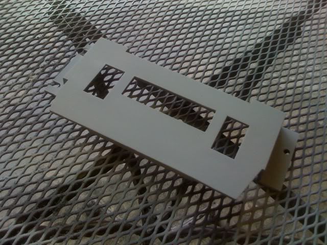

I just had an idea for the radio console lid/cover plate. I'm still going over it in my head but i think it's going to work. The white area is the new cover portion. It will add a little bulk to the console and I'll add some visual highlights as well. I'm still tinkering with the design.

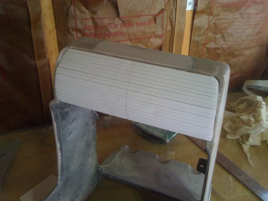

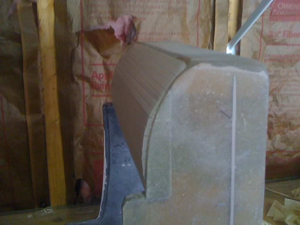

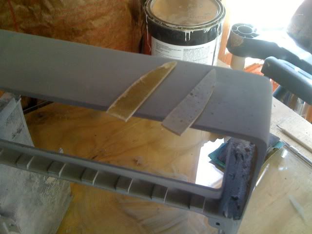

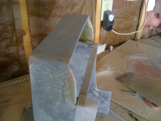

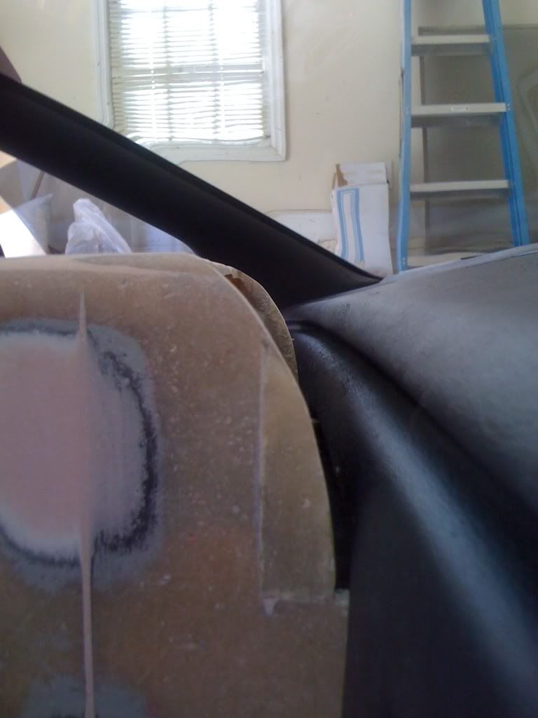

After tinkering with the console design I rounded out the back side of the "gauge pod" area
Using foam core I then created the curve to close the gap

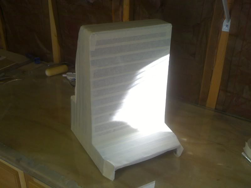

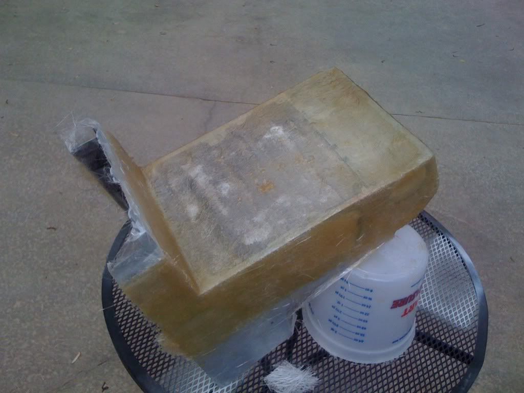

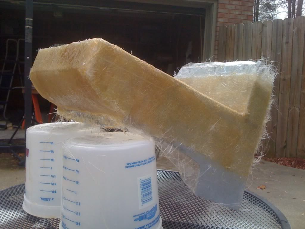

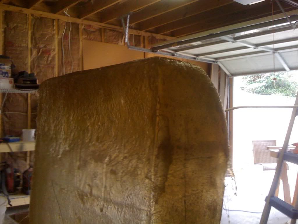

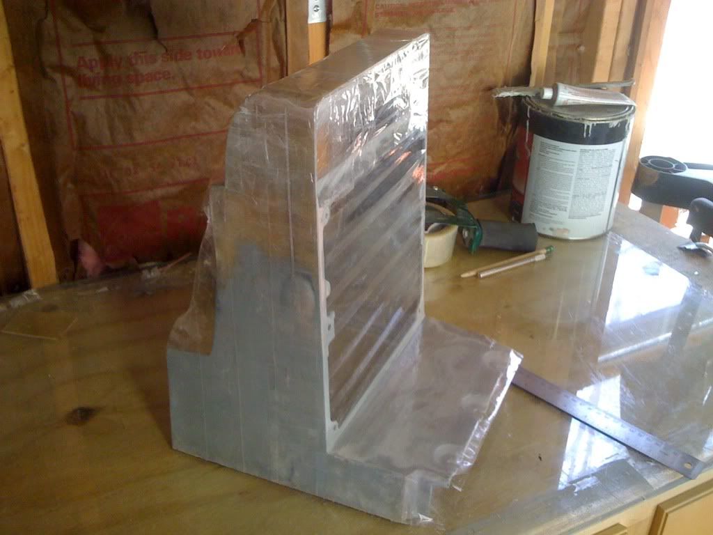

I then covered the entire console with clear packing tape to prep for glass

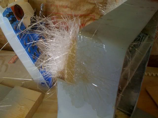

Covered with glass and tanning in the sun
I sanded the mold while it was still attached to the console. I then pulled it free
Adding more layers of glass to build up the thickness and fill in the holes
I also painted and wet sanded the door panel - I'm really happy with the way this is turning out.
