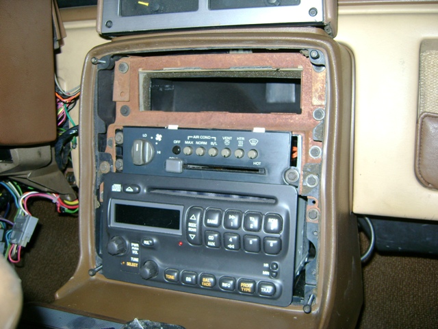

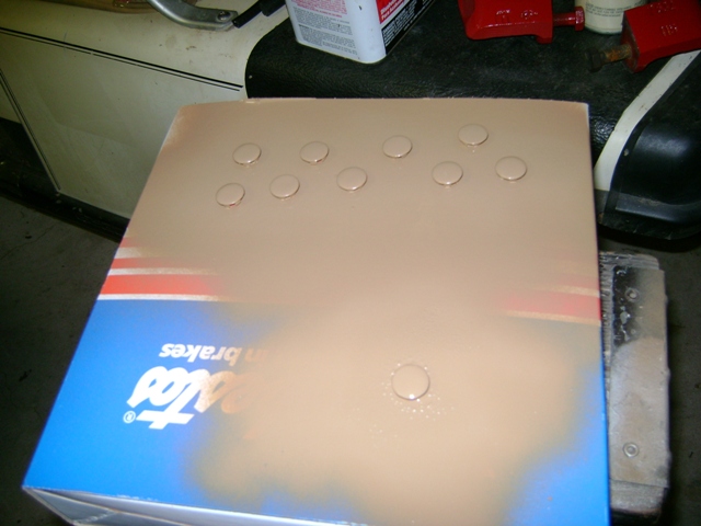

I painted ten buttons that go on the plastic trim at the bottom of the doors. I installed a real nice radio HVAC surround Poe gave me Tuesday.

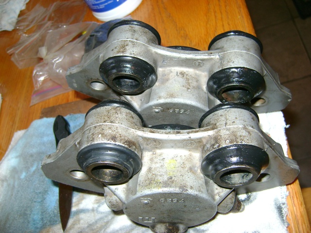

The mail delivered me the 88 brake slider boots I had ordered from The Fiero Store. I installed these on the two front calipers. They will go back on the car in the AM.

I installed the front two calipers and pads this AM. I am gonna have to remove the pads as it just occurred to me that I installed the ones with the squeal tab on the wrong sides. I had forgotten that they are supposed to be on the front facing direction
Installed the radio surround bezel.
