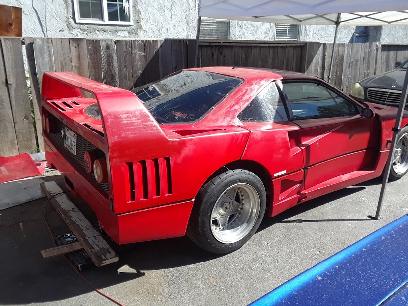

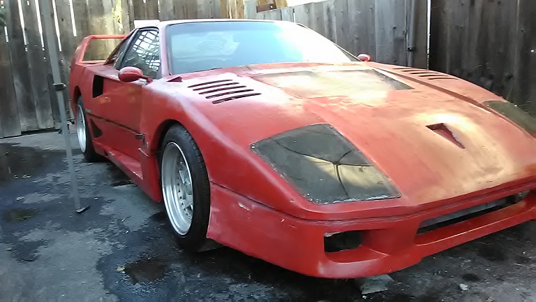

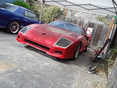

Still too much for gas! Got the rough-in done n some paint slapped on. Coming out damn good. Going to try and make the center scoop outta a sheet of aluminum. Im so sick of sanding.
Car looks great at some angles
and pretty lame in others, hood looks yuuge this way
The look im going for
Now its off to some mechanicals, car overheats now idling in the driveway, install a new tach, pull fuel tank n clean sender, oil change, n new ebrake fittings

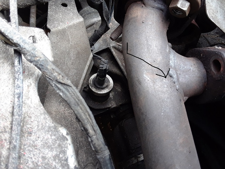

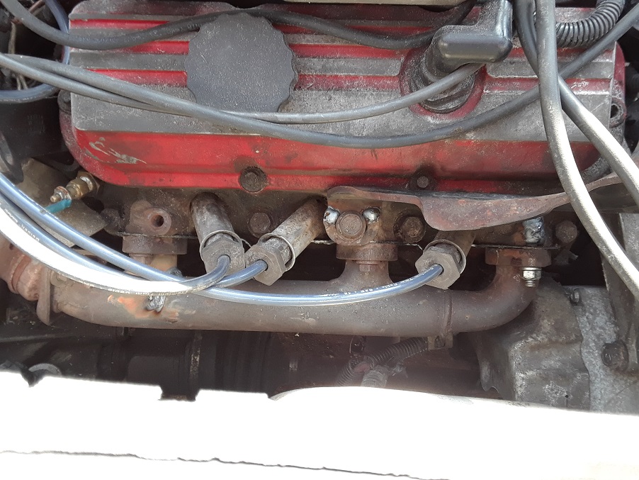

Started to attack my exhaust leak, im pretty sure its comin from the manifold. Lol I got a fierrari but it sounds like an old bug total veedub. Warmed up the motor n cracked the bolts loose, found a small crack in the mani

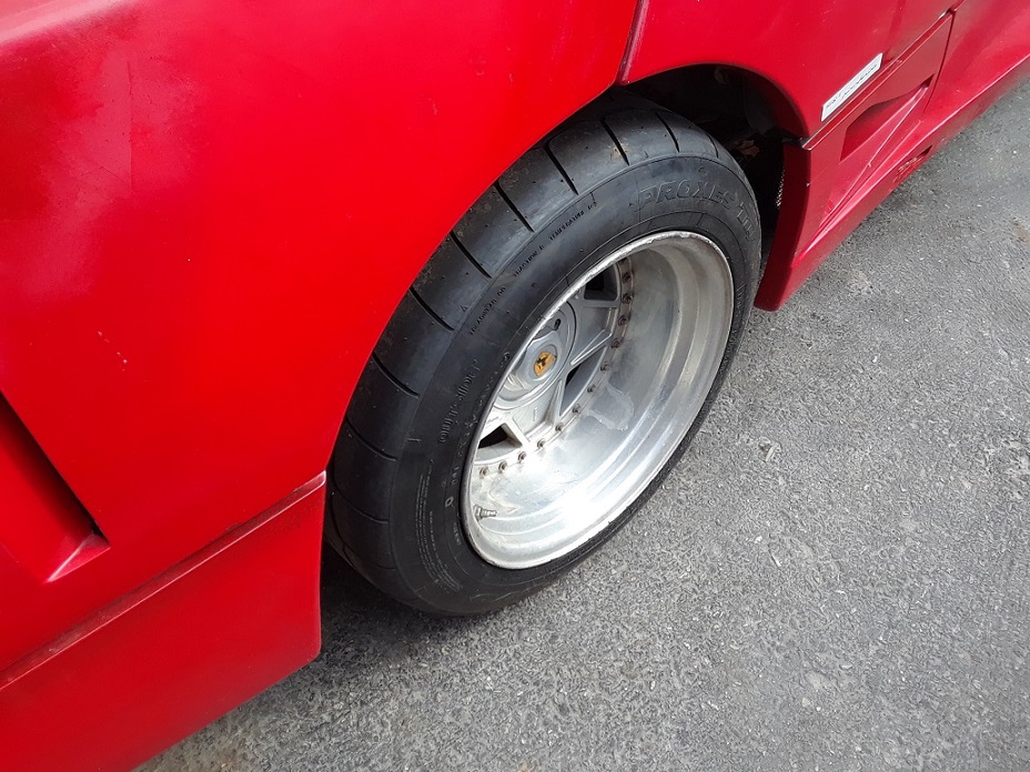

Got some new tires 275/45/16

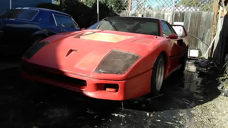

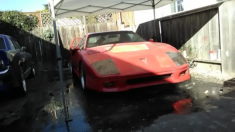

cut up the front to make a grove for the air splitter thingie those cars have. Should be easy and free to fab outta alum.
I got most of next week free so i can get to the shop n get some stuff done. Already got my headlight buckets punched out, almost ready to cut the body and mount them. I have the front hood scoop in alum just need to bend it

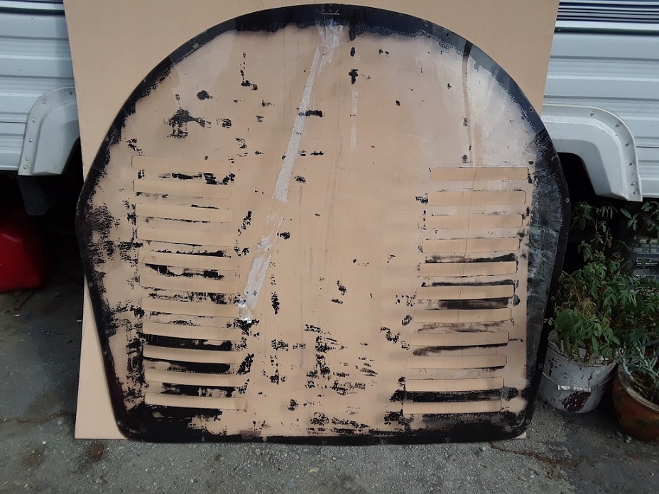

Went to tap and got me a chunka hunka polycarb for the bck window. $160 yowza! Its in but now I gott figure out whudda do about the vents, hmmmm..... anybody done any thermoforming?

Alrite alrite had a long day at the machine shop. I helped them w some stuff, they welded all my stuff. Got the exhaust stud welded in, manifold crack welded, and dogbone bracket welded together. Car sounds good now no more leaks. What I though was going to be a big ordeal turned out to be simple and easy.
Also got my headlight buckets ready for fitting
Got the hood aligned and welded properly to the car and started making the air splitter.
