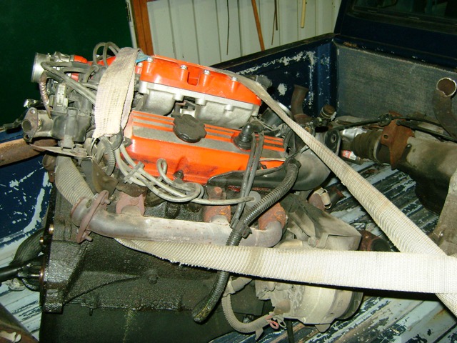

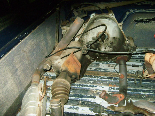

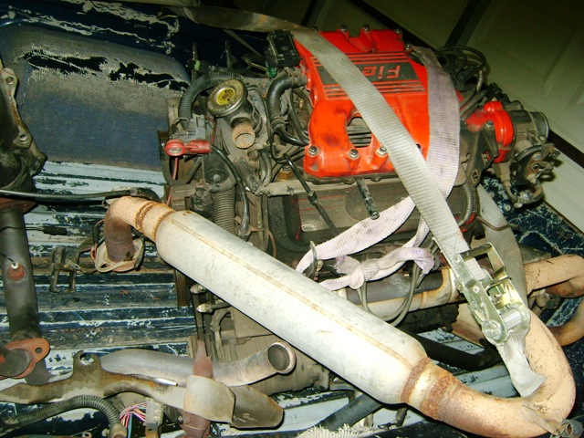

I was able to score some parts I was needing from MstangsBware in North Texas today.
Transmission, and exhaust system, CV axle:
Whole 87 GT engine w/ starter and alternator, etc:
and
I got my air breather rubber intake hose, from Matt, and a V6 Automatic ECM, from Katatak, in the mail today. I have a few things to do next week now!!

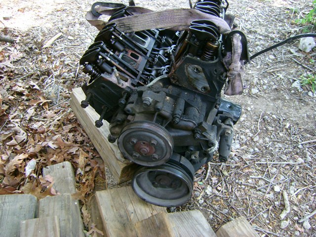

Just about there Pat. I have a 88 V6 engine mount on the way now
Today I got the top end off of the 2.8, and most of the brackets. I will remove the water pump and timing cover am.
