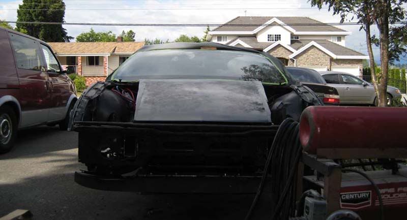

I do like that stubby nose, always thought that fiero's resembled a firebird a bit too much with the stock nose. What are you using for a windshield? Dodge caravan perhaps

The stubby nose goes well with the rear, I'll be doing something like that (no name lambo nose)

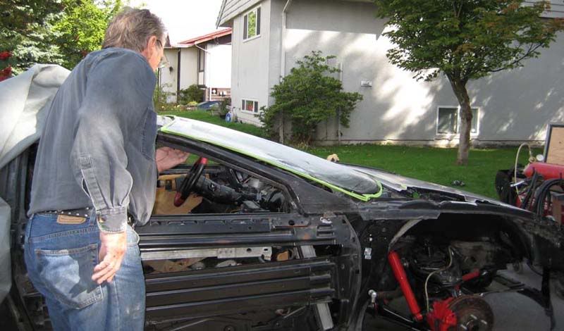

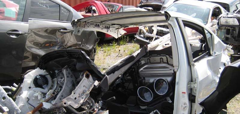

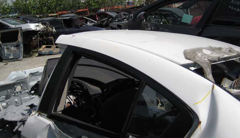

Went to the auto wrecker and here it is, 2010 Mazda 3

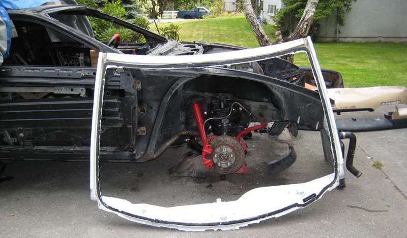

We laid the windshield on to see how it would fit...
That is still on the old RBS, the windshield will be laid back another 2"
The windshield is 2" wider at top, so the chop will be done different than the first, roof will be widen and lowered to fit windshield

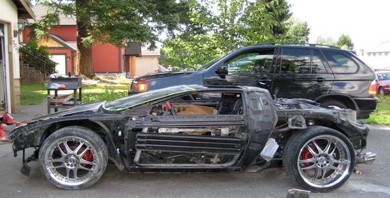

Car-Lo SEP 29, 10:14 PM

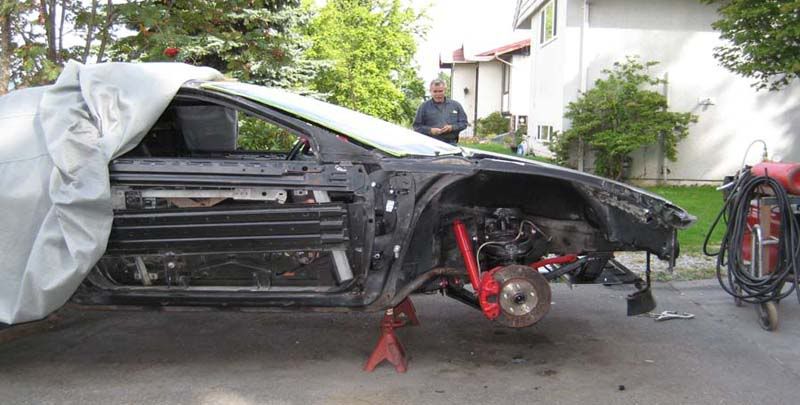

The old RBS stripped down, with windshield laid on...
85SEnochie (Terry) photoshop showing 2" more chop....

Sorry for me jumping to conclusions but this is awsome! Are you going to retain pop-ups?

Anytime Chris !

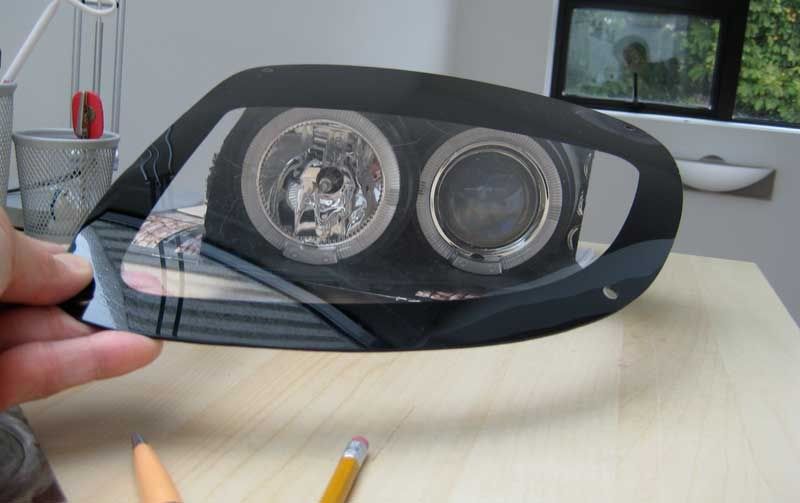

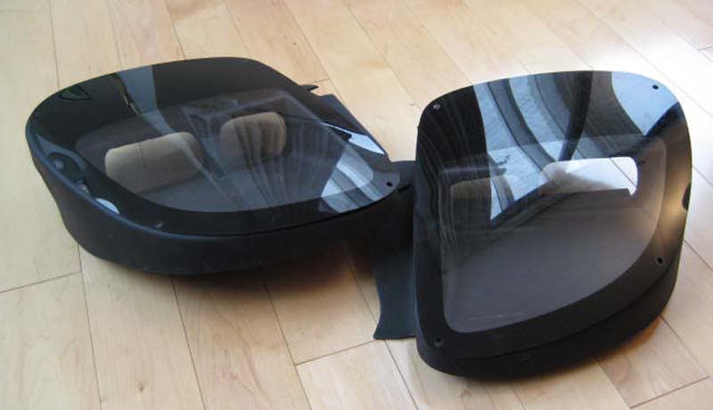

I had the Mazda buckets with Mustang dual projector lights now for 2, 3 years maybe more, I forget
If I do use them , I'll tweak them by adding mean looking eyebrows OOPS eyelids !
