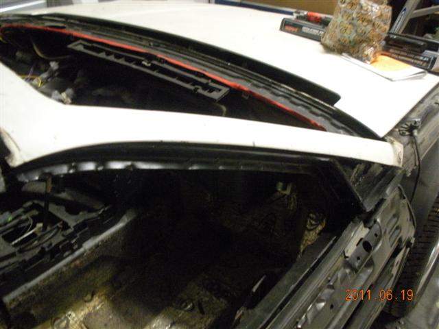

I might have leaded some to believe the windshield is cut down. It is not, I laid it back the same as I always do. I can take more detail pictures but if you look the windshield panel has not been cut or the a pillars. I did have to chop this car different than the others but all of the ones I have done are different in some way. Gianina and I discussed it (I had to get her approval) and I like the way the Ferrari kits use the extended windshields and the way it transforms the look so I went with the Sebring windshield. She has two styles planned for this car. With either one the windshield will add to it. I can say it will have Celica blacked out angle eye headlights because they have already been ordered. I also want to test fit the production car windows that I think might work in a chop. This is only the beginning. jscott if she uses the Fbody interior I will need your help. I also want to thank everyone for your interest and compliments.

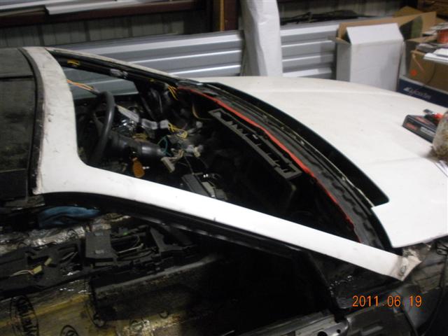

No problem, The Sebring windshield fits the stock frame of the Fiero. It is a little longer and more bubbled that is why I have to move the wipers out. Picked it up from the kit car forum and it has been done there. I could put the Fiero windshield I took out in the opening but it is broken. I am telling you I did not cut down the windshield opening just laid it back like on the other chops. There is no thunder to steal my wife wanted a Chopped T-Top Fiero and she has one.
.jpg)
.jpg) As you can see the windshield frame is uncut. I hope that helps

So from the pics its hard to tell, but did you have to push the back end of the T-Top panel into the roofline further than stock. It looks like the black plastic "filler" panel is missing. If so, then I can see how this may work, but when the glass is off, don't you have a small portion 3"- 4" of the sail panel extending into the removed area. If so then I finally get it. It works, and may look good when the glass is on, but how does it look with the glass off.
I'd love to see more pics, and some with the glass off.

| quote | Originally posted by qwikgta:
So from the pics its hard to tell, but did you have to push the back end of the T-Top panel into the roofline further than stock. It looks like the black plastic "filler" panel is missing...
Thanks agian for this thread. I've always wanted to chop my T-top.
Rob |
.JPG)
From this picture it appears the t-top is sitting in the same location with respect to the B pillars. If it wasn't that would mess up the sealing surface.
