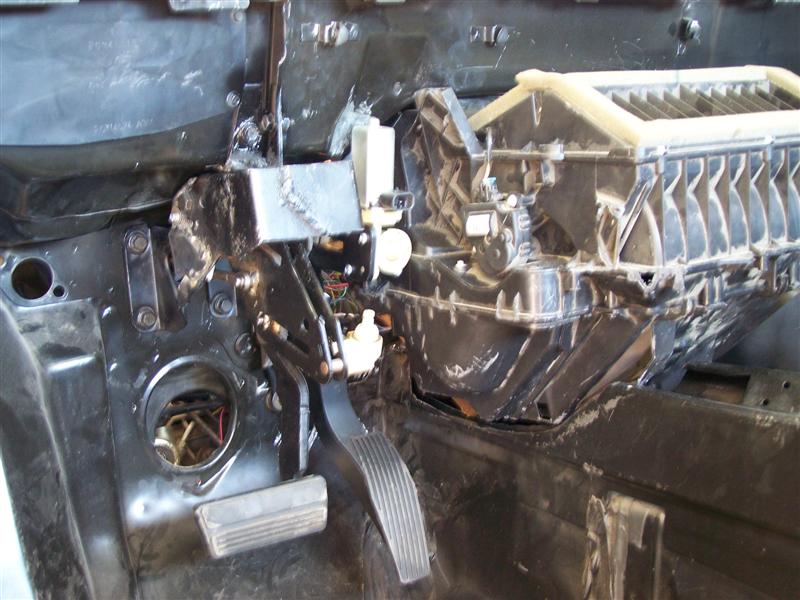

ok got the wiring in as you can see i had to remove the stock gas pedal and put the 06 in since its drive by wire. i had to fabricate the brake switch to work on the fiero pedal. i had to fabricate the 06 master cylinder to work. and the air box is in, all the wires and dash components are in now im just cleaning it up. i also have the 2 radiators on im using civic radiators. and now i have to extend the wires for the engine bay to the rear.

Rickady88GT MAY 15, 11:15 AM
Originally posted by merciero:
I have the same HVAC you are installing, but I could not fit my foot in between the HVAC and gas pedal with the system were you have it. I placed mine a little diferently so I had greater foot room. And still used the adjustable pedals.
I used the Fiero steering shaft but removed the "U joint" and instaled the aluminun "U joint" onto the Fiero shaft.
BTW that "aluminum" beam that was under the dash IS NOT aluminum. It is magnisium. DONT burn it. I had fun with some of the shavings in a metal can and a lighter. DO NOT DO THIS AT HOME if you get hurt or burn some thing down, dont blame me
