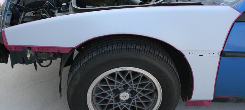

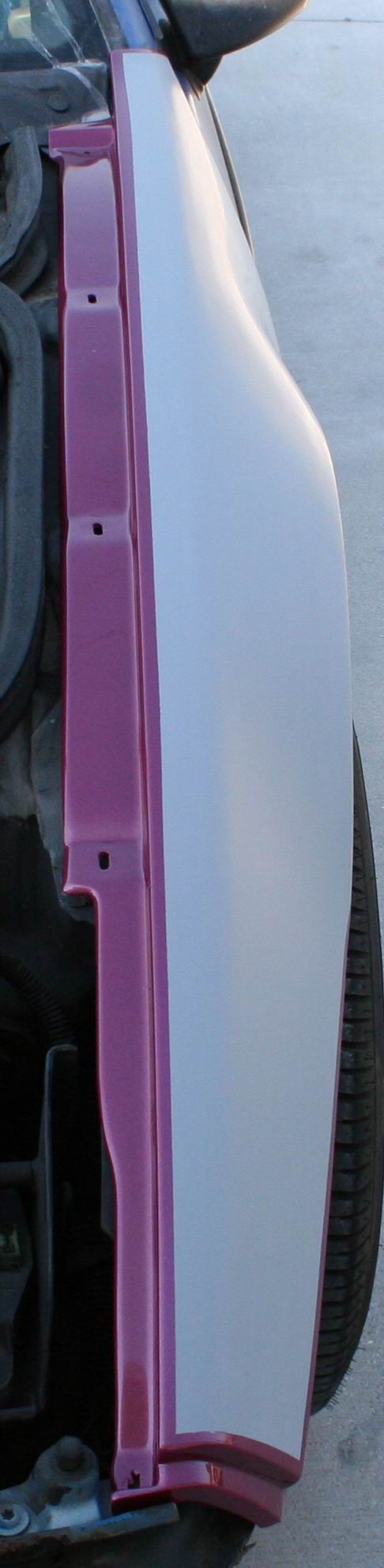

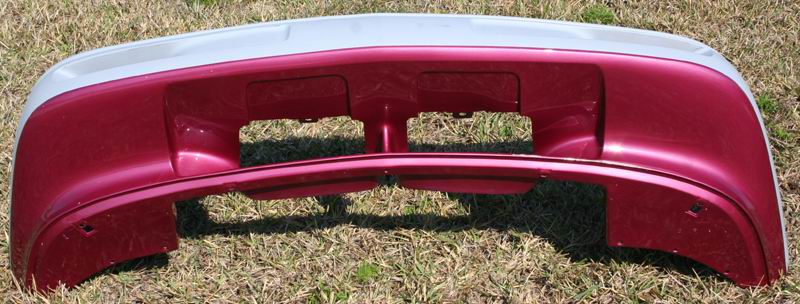

GKDINC came over a week or so ago and we played with the gun a bit. We got it figured out finally and it turns out that I had the pressure a bit too low and was pushing too much material through the gun. I also did not have the fan adjusted right. I finally got the hood, bumpers and fenders re-primed and fully sanded. I sprayed all the edges and the underside of the front bumper with color and clear. I also got the whole underside of the hood painted black and coated with semi-glosss clear. I am very pleased with the turn out so far and my girlfriend is loving the color! I will post some pics later.
JimmyS FEB 17, 03:09 PM
A few pics... more later.
Fender with edges painted and cleared
Bottom of front bumper painted and cleared
rogergarrison FEB 17, 04:12 PM
Looks good, but you made yourself a lot of extra work. When you trim in edges, either mask right on the angle where you have a sharp edge, or DONT mask it at all. I always get the panel all ready, spray the edges and let it overspray, Then just mask the trimmed area, scuff the panel again and shoot it. By masking the way you did, you now have a distinct line that you have to block out. Ive seen edges like that pop back thru finished paint. Not to where you can feel it, but in the light you will see the line. Same thing happens when you put striping on, even decals. We did semi cabs a long time ago, refurbished for used truck dealers. We chemically stripped the whole cab body, primered, sanded and painted them. Most after a month or two, you could look at it in the right angle and read the signs right back off it. And remember this was on panels that were stripped to bare metal. Block those edges and hope for the best. Lighter colors will hide it more, but very hard on dark colors like black. Looks like its going to be pretty nice though. I personally love any shade of maroon or burgandy.
