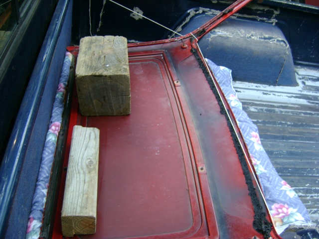

Made it home with my new non sunroof top from MstangsBware's house:

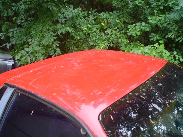

Just got thru doing this with josef644....Took maybe 45 minutes to get it off but most the interior was already out of the car. Was easier than what I thought but does require some patience...
Thanks to Stephen's help this wasn't to bad at all. Here it is in the bed of my S-10 truck before we tied it down for the ride 225 mile back home:
Made it home safely, with no damage to the new roof. Scored a bunch of parts I was in need of from Stephen. Non sunroof headboard, and some real nice beachwood dash parts. Just cost me a burger meal for him at Mickey D's.
Thanks for all the help.
Joe Crawford
Cleaned all of my plunder from Poe's place , and my tools out my truck this morning. Hung the top in the garage. I was gonna do the 88's front calipers this morning, but it is 100% humidity. 9 am and it is already nasty outside.
