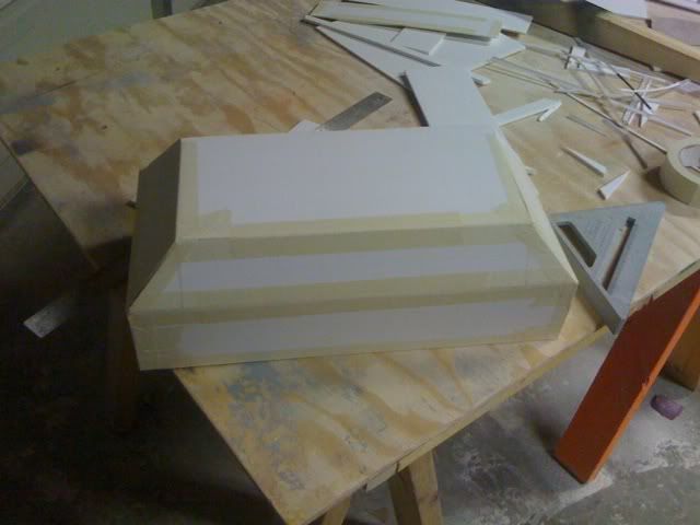

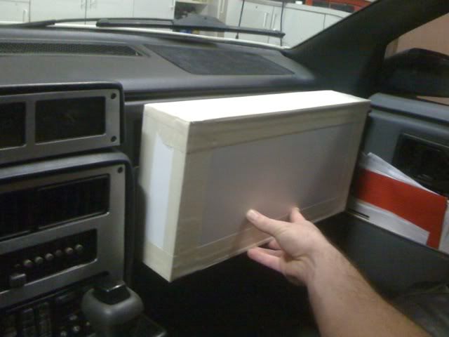

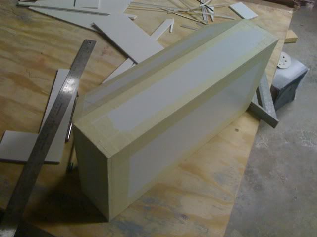

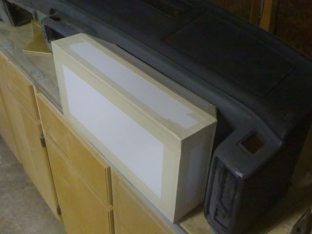

I created a foam core mock up of the glove box. I followed the same basic look and feel of the gauge pod but the shape might change. I still have a few minor modifications to do. What do you guys think if the basic shape?
In the car... not a very good shot because of the tilt
Modified
There is a lot of potential for a glove box. More to come
revin
MAR 11, 10:42 AM
the large square won't hold much like that. where the "pocket" is now, you can knock that out and go for depth. I would think at least 10" back into the dash. mock up again

Hmm, I would say it looks a little too tall. Still nice, just seems a little big. I also agree with this!
| quote | Originally posted by revin: the large square won't hold much like that. where the "pocket" is now, you can knock that out and go for depth... |

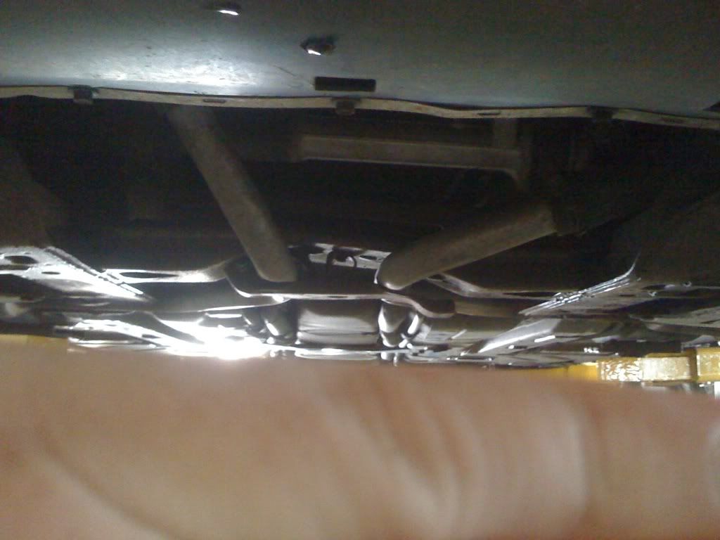

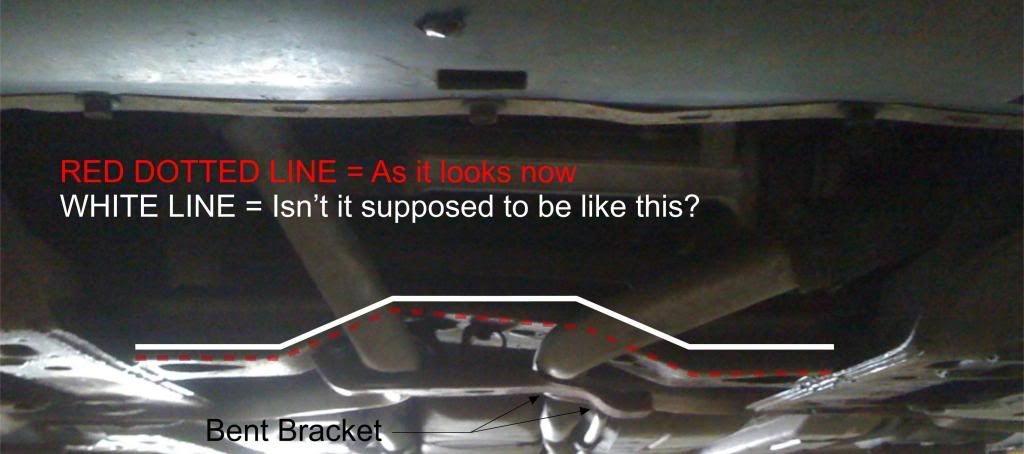

No updates today. I've spent the day at the shop getting the rear brakes looked at. Turns out the pass side rear caliper is shot and is not engaging the emergency brake. I also found out the emergency brake "warning dinger" is not working. ugh I also noticed something very interesting... Check this out. (I'm going to post this in the Technical Thread as well).
Looking across the underside of the car from the front to the back, I noticed a bracket was loose under the front cross member. Upon closer inspection you can not only see the bracket but it appears that the entire bottom of the cross member is bent. Am I looking at this wrong? This is supposed to be straight isn't it? That's my hand going across the bottom - the sun was reflecting off the wet ground and making it tough to take a pic
Another image with lines to help to see what I'm refering to - I tried to get the image as straight as possible
Can someone please let me know if the cross member is supposed to be bent or curved.[This message has been edited by Sofa King (edited 03-13-2010).]

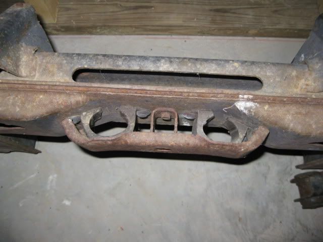

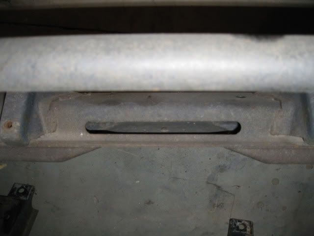

Here are a couple of 88 front crossmembers... It looks like at the very least the coolant tube bracket is mangled, but there is a chance that the oval slot between the lower and upper portions of the crossmember is also bent.
