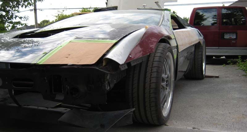

Ok. I see it now. I'm interested in seeing how you're going to form that negative space on both sides of the front wheel. Especially on the front there where we're talking about.
Is the front lip of the hood going to be the front-most point?
serrata you are so observant and good questions, about that negative space I'm not sure that will work or not, we are tweaking as we go.
Yes the front hood is the longest point, no nose just a lower front wing for the bottom front we'll see where this goes

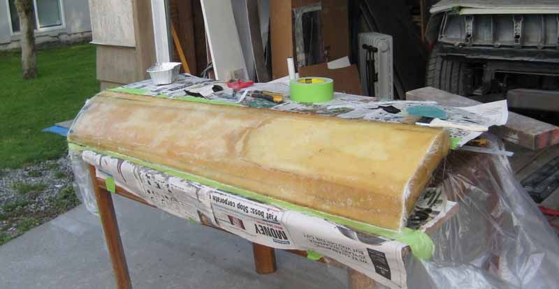

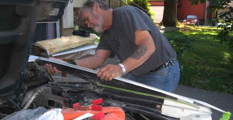

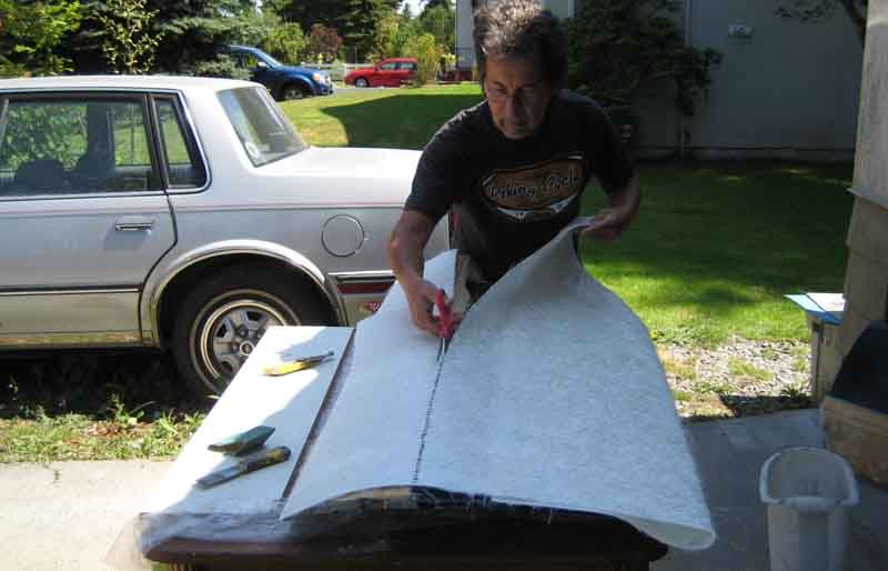

Fiberglass foam doors using 2 oz matt
Looking at capping opening on rear panel, notice raw fiberglass door and only opens 10"-12" NOT it's 18"

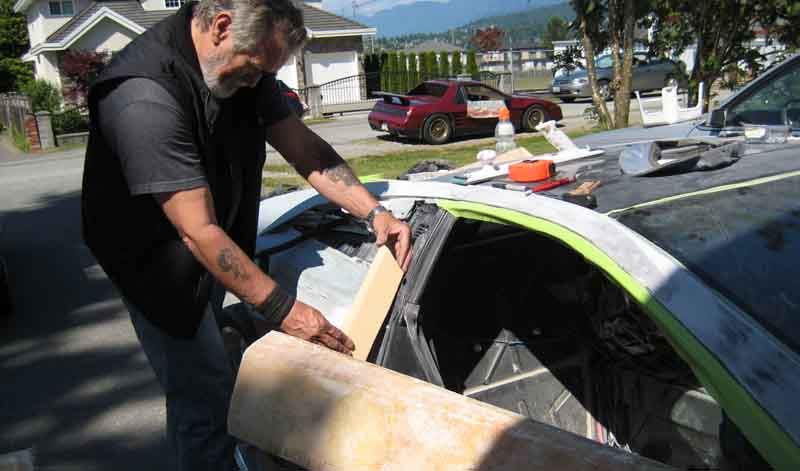

We started to cut out and fit fastback pillars liners

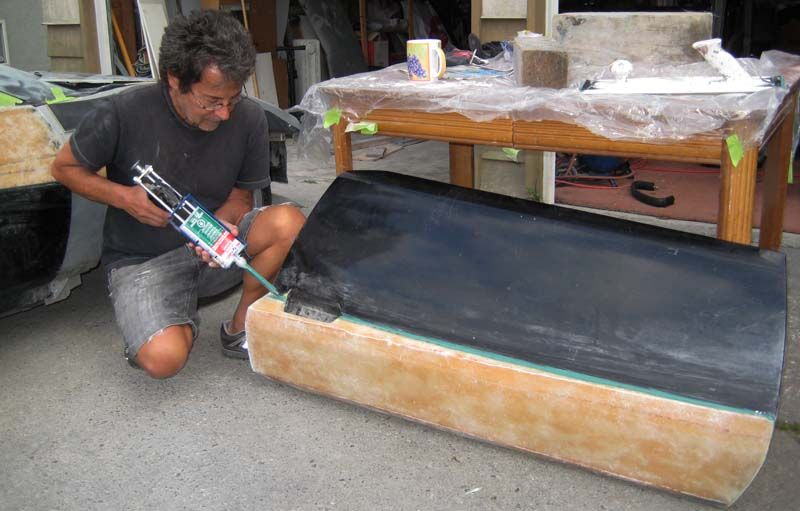

How are you bonding the new fiberglass to the existing door? Do you have to scuff up the existing panel where the two will meet and then the resin just adheres?
I'm taking a lot of notes on technique since I've never used fiberglass before and I'll need it soon.
Thanks, the bottom edge between fiberglass and door I really rough it up with 40 grid and used a bead of Pliogrip as shown on pic that will hold.
Top edge is fiberglass on fiberglass so that's okay.
Is this the negative space

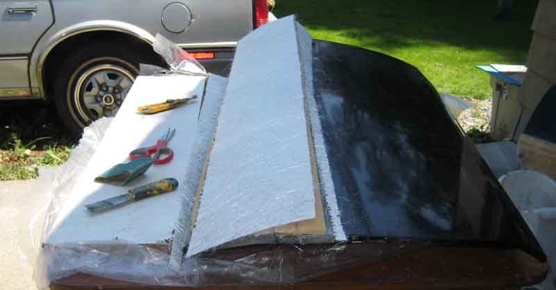

Thanks, and thanks to you, I'm learning about matt weights since fiberglass is over foam I'm just trying single layer of 2 oz matt
Thanks for sharing your build (so you're building RBS3 I see )
Sanding fiberglass door smoother
